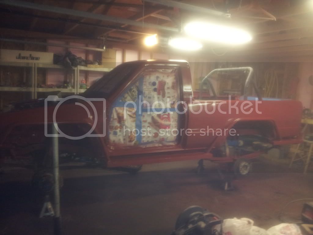

Anyway...I'm to the point now where I can spray. Actually, I didn't get as much done as I had hoped. The weather is getting cold quick. I was able to tape up the truck and get the shop up to 60 degrees to go ahead and spray some primer. I was just starting to mix the paint and I noticed my thinner was leaking out of the bowl. My gun has a crack in the body. I'm going to take it for exchange tomorrow. Tomorrow, it will be warmer but I will have limited time with work and going to the store. It will also be raining. Hopefully the humidity in the shop won't be too hit. This paint job will be far from perfect, but I at least want it to dry. I'll have to address some of the parts that didn't get finished right next year.
It was when I was about 3/4 done when I realized it wasn't blue. I'll try to fix that tomorrow.
Yeah. That's a tractor and implement primer.
I sprayed at about 70 degrees and it was still 59 at 5am. The primer was also dried nice and hard. The instructions call for no mixing, but I added hardener to shorten the time.
I bought way too much paint. I only used about 30oz out of the gallon. I also bought a gallon each of black and blue. I could probably paint it 4-5 times with what I have.
Everything that is still red will be bed-lined or painted flat black once I feel confident enought to start taping over the new paint.
A bit bluerer.

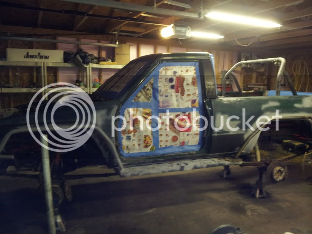

I've still got work to do.
Don't worry, it's still green underneath the blue and the red, and also on top of the original red. When you grind or sand something on this truck it looks like an everlasting gobstopper.
Paint job is coming along nicely. Masking the whole truck is time consuming process.
The blue was nice and hard yesterday evening. I'm going to tape it off and spray the bedliner on. While I'm waiting for it to dry, I'm going to see if I can come up with something better for the front springs.
