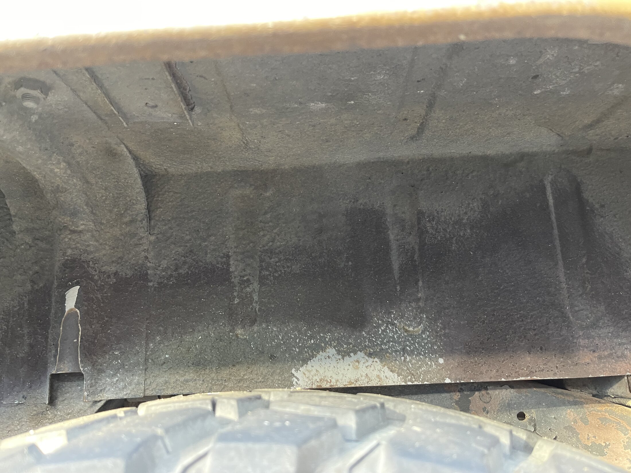

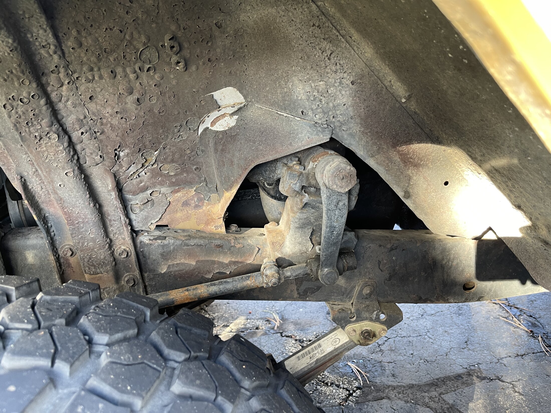

I've pulled out the matt out of the back (but don't have pictures). Here are pics of the fenderwells:

I meant pics of the inside rear floor and fenderwells, and an overall pics of the rear with the doors open. Looking at the new pics it appears to be in pretty good shape. The underneath looks OK.
Does the rear floor seem solid? Any holes? The external part of the rear sill doesn't look that bad, but the inside looks iffy. I'd scrub it, the maybe wire brush it to knock down some of the loose rust and assess how bad it is. It depends how deep you want to dive into it, and how much you want to do. Right now I'd clean it up as best you can. Someones already cleaned and painted spots on the driverside. You'll learn new skills and probably get some new tools. Folks around here will walk you thru projects. Look in the clubhouse section and see if there's other members close by for advice or help.
