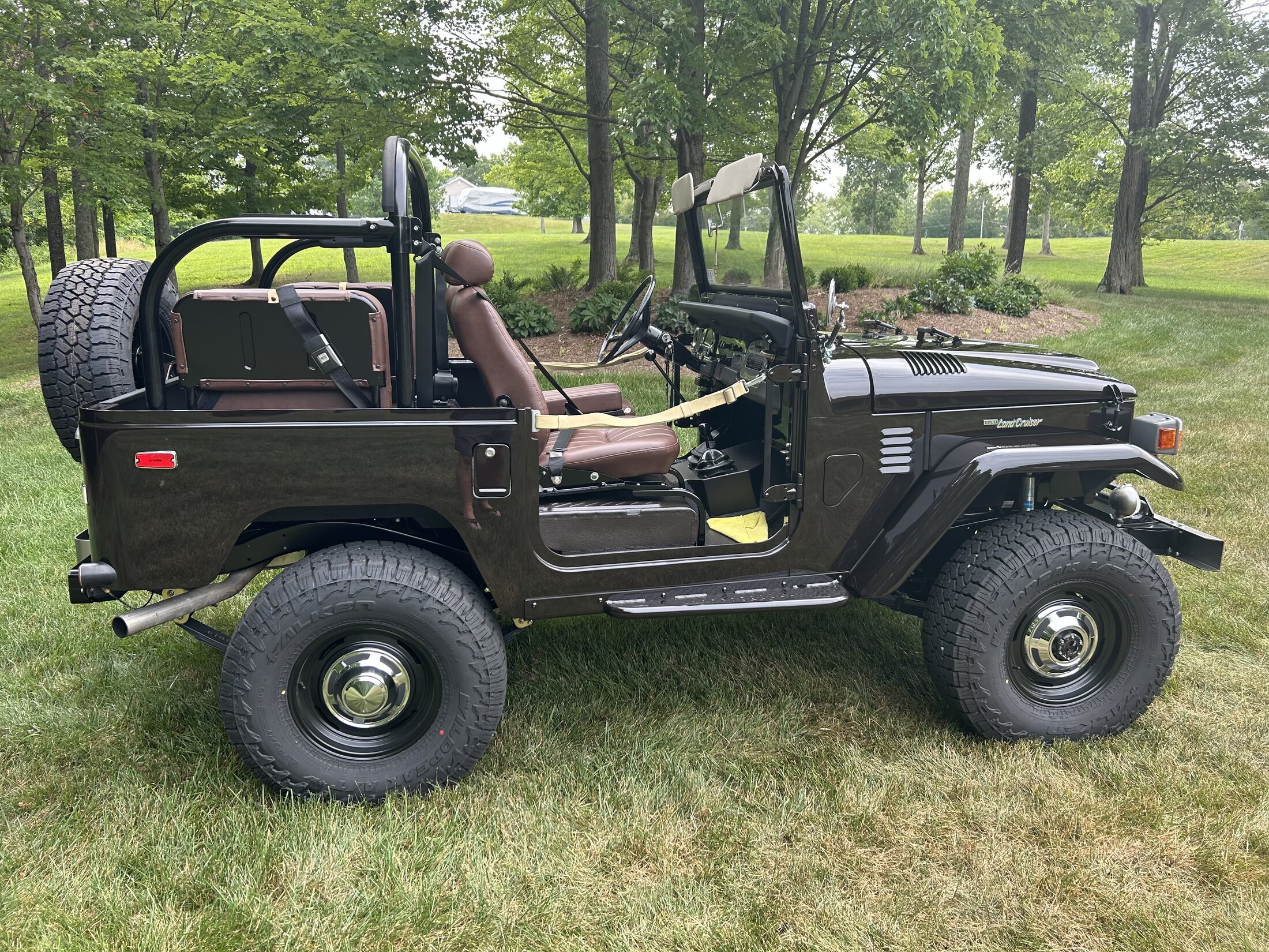

Full on AQ tub. The only thing original is the hood. Factory HT mod in place and shown in the pre-paint mockup. Shop went the extra mile with the details to mimic factory seams.
It’s a trade off, no rust vice original. I’ve been called “Chunga the defiler” and this is just my opinion but, if 100% originality is your goal, stay the course with your preservation/resto. If you’re inclined to look at an AQ solution, it’s money well spent.
Hit me with a DM and I can talk with you on the AQ expectation management paradigm.

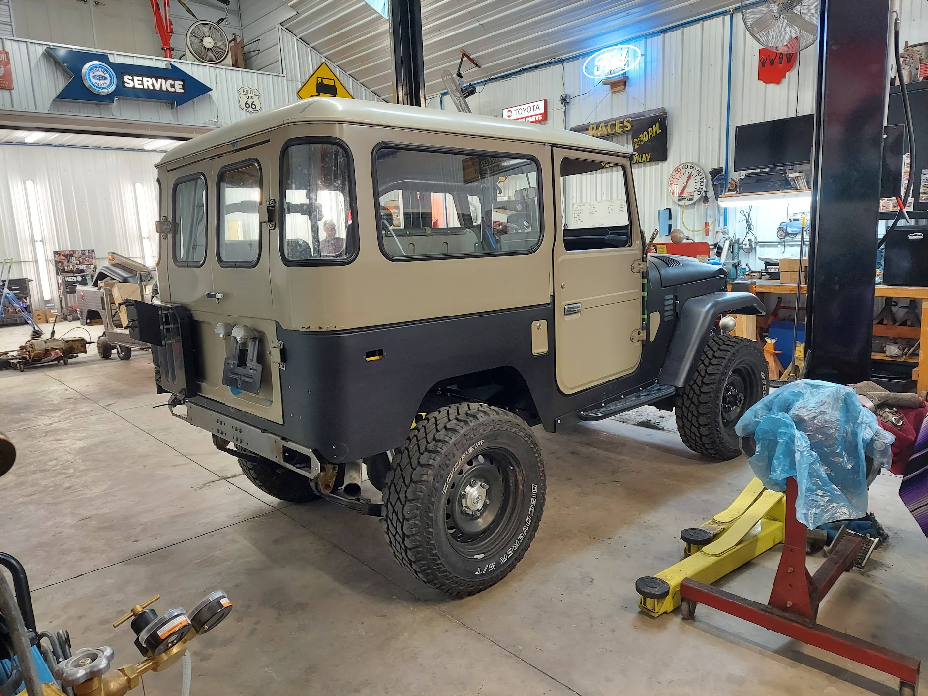

Do what you are comfortable with and don’t be afraid to try something (or learn how to do something). I am fairly new to the forum and to FJ40’s but I have taken the time to research various things related to same. Our rear sill was much worse than yours and I did the replacement by myself in the garage, with help from the ih8mud community along with family members that know a thing or two about welding /fabrication. Bought a welder and learned. I think it came out pretty good. You can do it if you want to, just depends what your situation is. Although I do make a better grinder than a welder!!
Lovely work!
