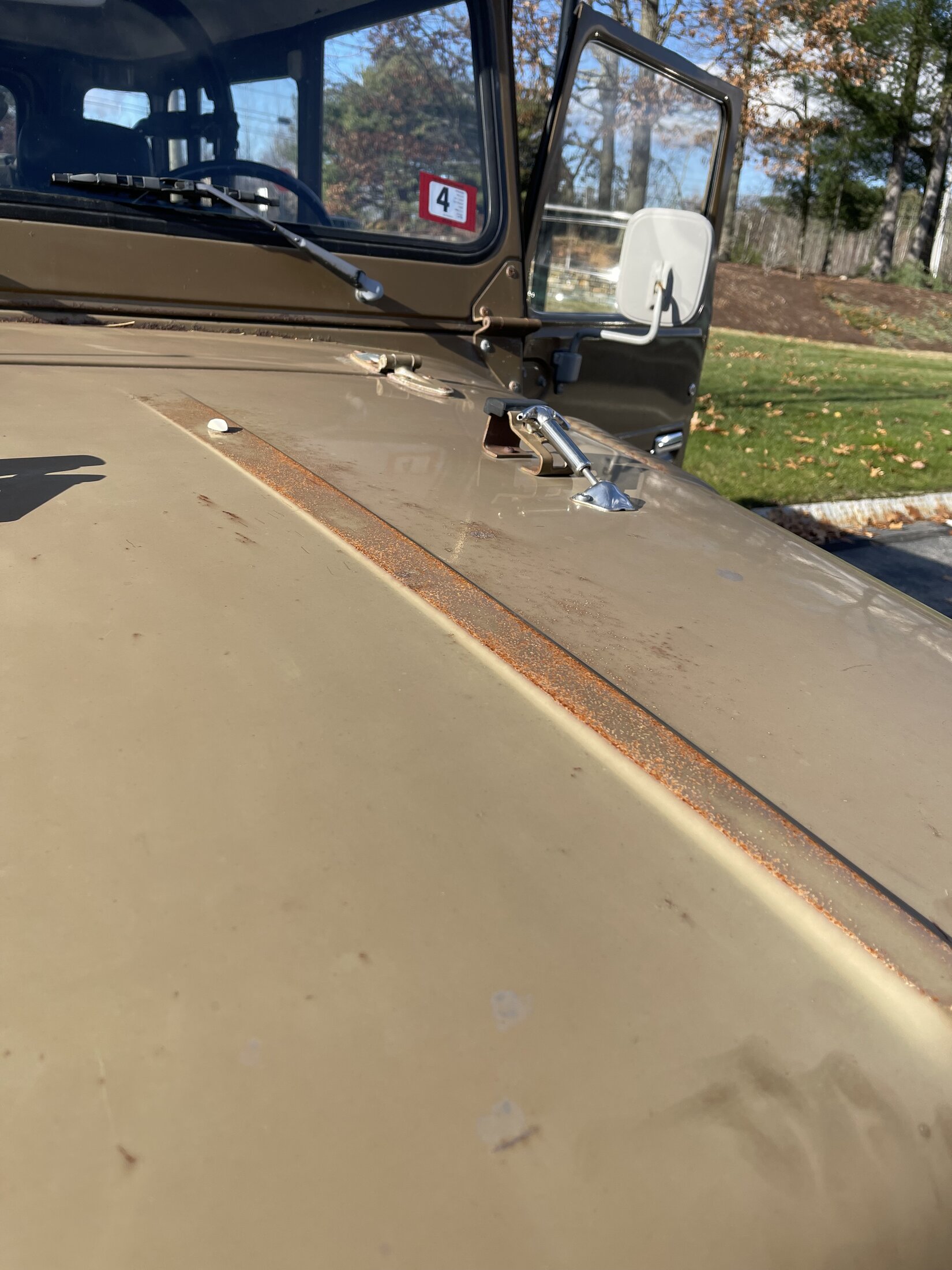

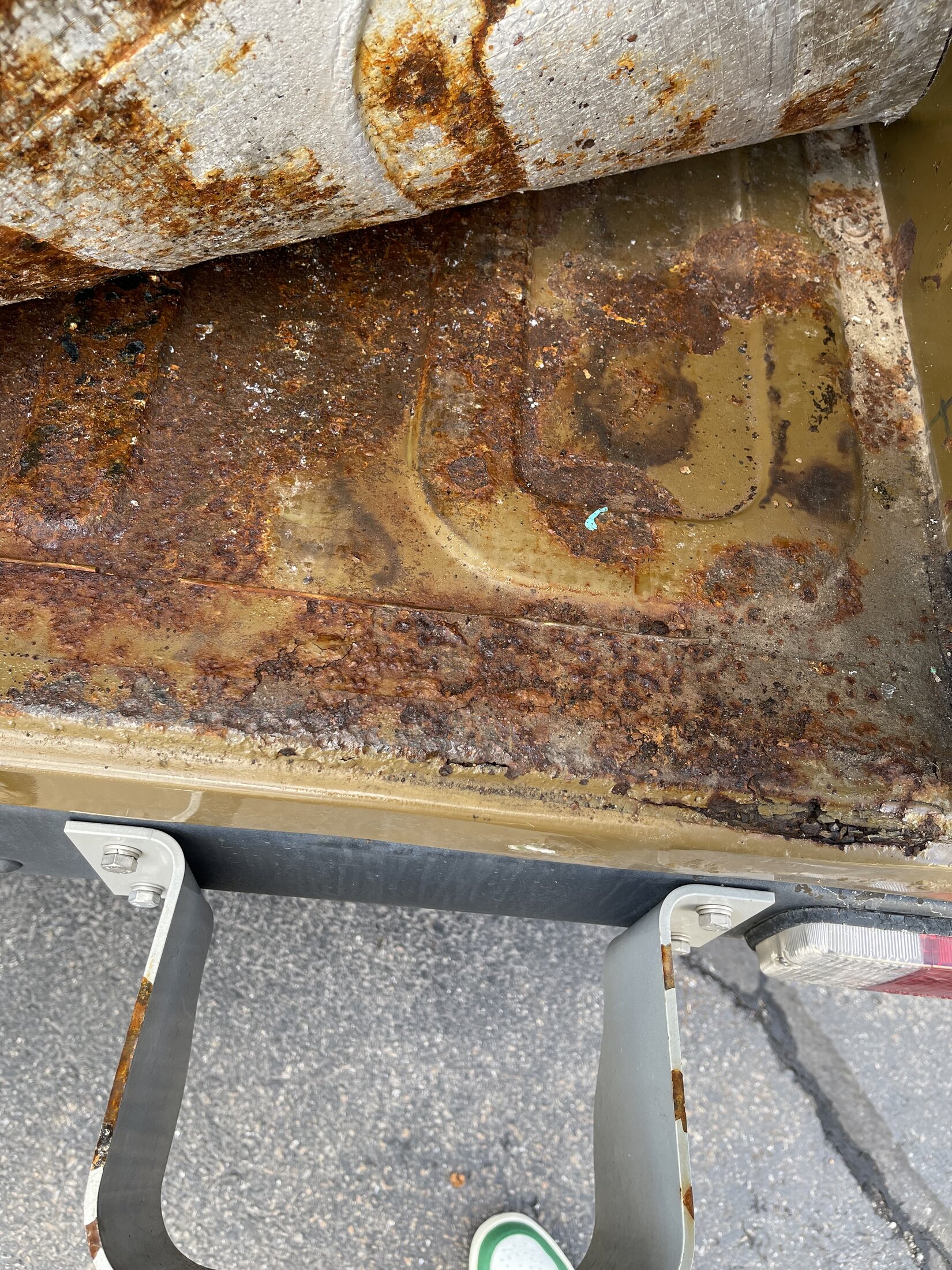

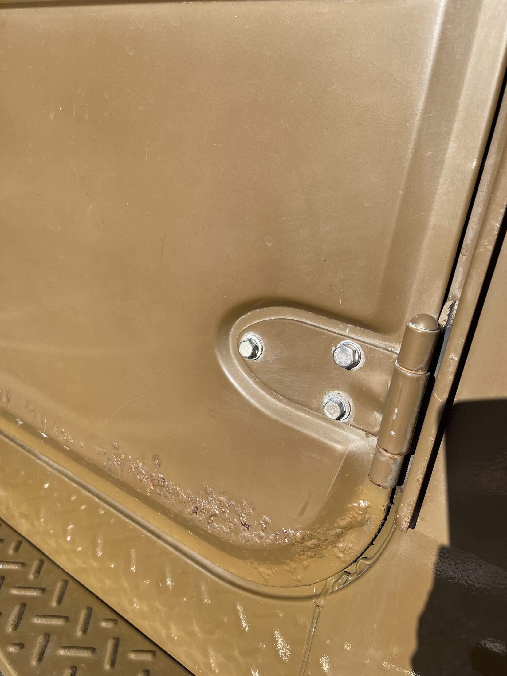

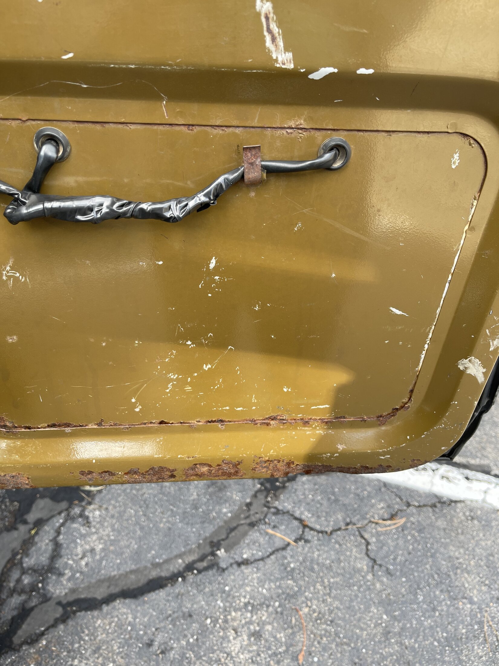

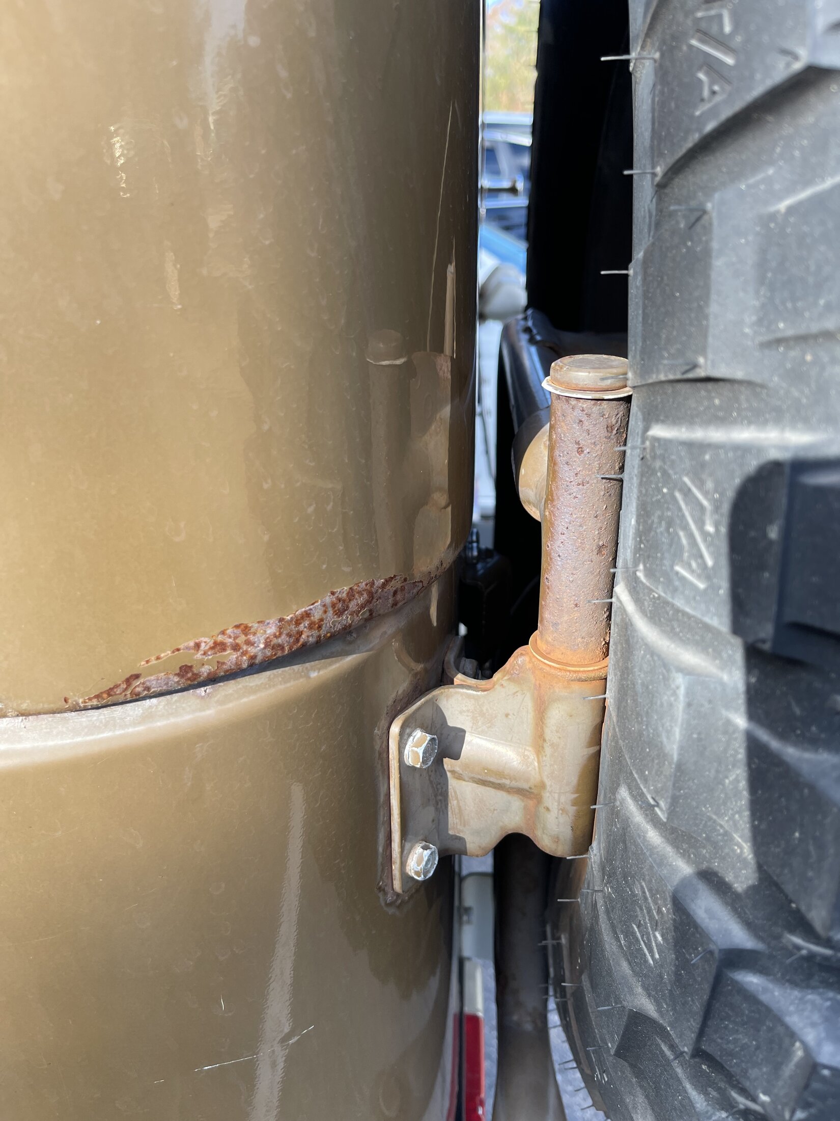

I've had my '78 for nearly 2-years now and started to figure out my restoration priorities. The truck runs well and serves reasonably well as a daily driver. My first priority is to tackle the rust. From the attached photos, how big of a job am I looking at?

That tub is going to be rough, I'm guessing. And, the bubbles... you won't know what you're dealing with until you take a flap disc to them and start sanding away the bubbles. You'll likely find some swiss cheese where the rust has made its way through the sheet metal.
As you're in NH, unless you have a heated space to do your work, I would just soak all of those areas with fluid film, and wait for it to warm up before tackling the rust.

I'd wager that portions of the tub will need to be cut out, and likely, sections where there are bubbles appearing will need to be too. You're lucky with the 40 series though... lots of aftermarket options for patch panels and tubs.

They didn't want the job, that's why they bid so high with only a casual look at the damage. The rust will be lots worse than what you can see. Fixing it will be way more than just wire brush and sanding.

What everyone says is true; the rust will be far more extensive than it looks. It also won’t always make sense. My drivers seatbelt attachment was rusted all the way through but the passenger side was fine. Lots of weird surprises like that will pop up and there isn’t always a patch panel to assist with the restoration. You have to be willing to fabricate and take your time. I don’t think $50k is too much for a full body rust remediation and repaint IMO.
Start with the cowl seam, right by the windshield. Seal it up so it doesn't get worse there. Clean the inside of the door, and make certain that the doors drain freely. Install fresh weatherstrip in places that need it.
I'd care only about the rear body mounts (aka 'rear sil') - the truck needs to be solid from a structural standpoint. Original hardware for the spare tire carrier, doors, could be swapped for new hardware.
