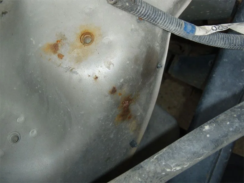

I have some rust spots coming through the paint on my 4runner and some chips. Also there is some on the cruiser I'd like to take care of. I know pretty much nothing about painting need to find out the steps to take to fix them.
Gary
4Runner
The rust in the second picture is inside the engine bay on the other side of the well in the first.
Looks like surface rust for now. But you should address it before it gets worse.
In the areas where it's inside the wheel wells or engine bay, i would wire brush or sand it to bare metal and prime it then paint it with a rustoleum silver. on the outside do the same but you have to be careful with sanding and with painting it to match the factory color.

that's just surface rust!
Sand to bare metal, prime and paint. Like was said before be careful on exterior to match colors. Could use some POR or RustBullet on area in third pic to get at the seam better.

I've got a palm sander I could use on the wheel wheel well, but would it be better to get a dremel or something to pinpoint the area? To fill in would the touch up paint from Toyota be enough?
spray some "Must for rust" on there, it will come right off. You can find it at home depot.
is there a particular reason to use 'silver' after the area is primed? also, what's the skinny on "must for rust?"
Must for rust has Phospheric acid in it. Destroys rust... I'd be careful when spraying it on, maybe tape around the areas so you dont destroy the paint... but I'd spray wait 30 seconds, dab with a cloth, wipe off. Repeat that till the rust is gone.

I am pretty sure he recommended silver paint for behind the fender only, as that seems to be the factory color in that area. If you hit it with black, or any other color it will not blend in as well.
