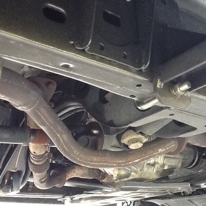

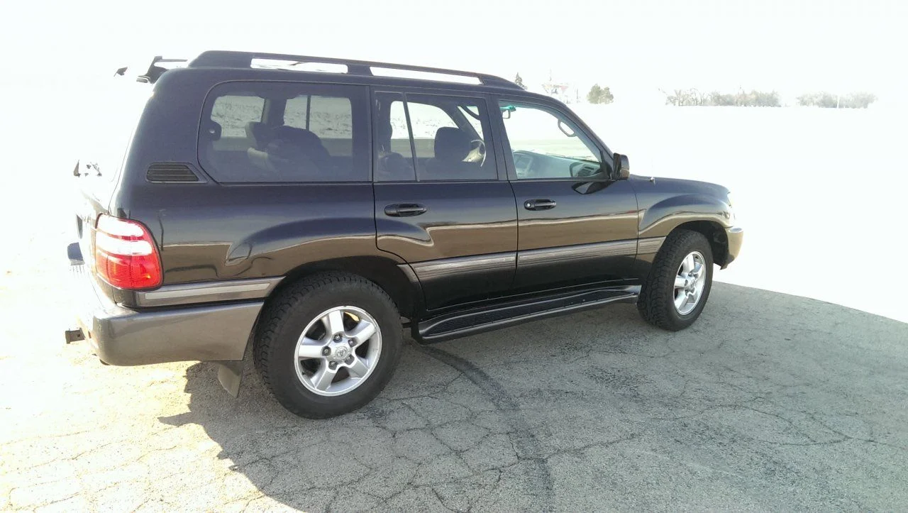

I'm going to go check out the Ohio LC tomorrow morning. Those are the pix I posted above. It's hard to tell for sure until I crawl under and really inspect but the rust does seem to be on the minimal side all things considering. The Ohio LC is a 2004 w/ 112k miles. 2 owner, almost no service records until about 100k then it has good history (albeit very short). TB, WP, Plugs, etc were done recently.
Since I'm not in a huge hurry and this won't be our DD I can afford to be patient. I have no issues with flying west or south to find a nice specimen either. Just need to keep it under $20k, while something around 17k would be ideal. I have been scanning North Carolina, KY, TN, SC craigslist adds almost daily so there is always a chance something pops up there as well...
The places to be concerned about are the front and rear windows, pinch welds on the rocker panels, and the inside pockets on the front fenders. The underside on this rig looks fine, although if you plan on upgrading torsion bars, plan to buy new anchor arms.

Excellent tips. Making note of those areas now so I don't forget tomorrow morning when I'm investigating outside in 0* weather.
Looked at the truck yesterday. Rode and drove really nice. No hint of rust anywhere on painted surfaces, all pinch welds and other key spots were pristine. Under carriage had less rust than anticipated. I think that's what pleased me the most about the truck.
The bad: had 2 leaky cv boots. Boots seemed fine, so maybe they just need rebanded. Lots of little dents which should be pullable. One 3" scratch that is not repairable. Rattle between 3-3.5k rpm coming from middle of truck. Sounded like a heat shield so not too worried.
