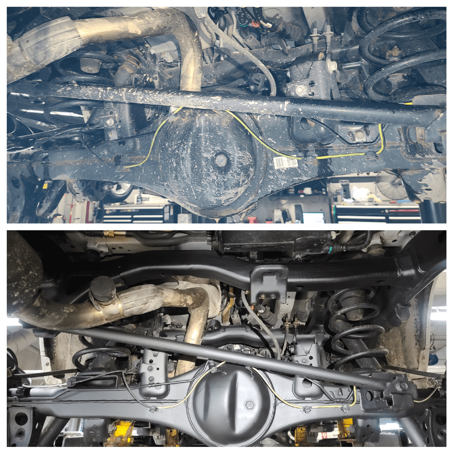

I purchased a slightly used 2016 that had a bit of surface rust on the frame and axle. I wire-wheeled all the rust off, followed with a steam clean and scrubbing with simple green. This was followed by two coats of rustoleum rust reformer, then two coats of cosmoline. Time will tell if my efforts pay off being in the northeast
Looks good just wash it down every year and repaint it where it’s starting to show any signs of rust you’re good to go
