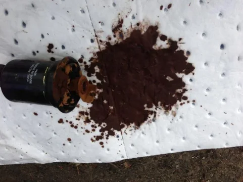

Guys...new to the board and 60 ownership. Learned a ton here. Thanks in advance. Two days ago had my fuel tank replaced under recall at the local dealer. I waited one day to change the fuel filter just to make sure all the junk had passed. Replaced the filter and the next day it is full of rust particals again...at least a thimble full. I was suspicious when I picked the truck up and the exact same fuel level was in the tank, figured they wouldn't put that much gas back in for me. My question is this. Are there any other fuel components that would put rust particals into the fuel line? Wanted to find this out before I accuse the dealer of putting my old fuel back in my "new" tank. Truck was idling ok before since the fuel solenoid had just been cleaned but now won't idle again.

Put up some pictures of the tank. Should be easy to tell if it was replaced. Furthermore, the tank replacement includes new vent lines, so they should be new too.

Thanks for the feedback. The tank was definitely replaced. I can tell by looking. I waited a good 30 miles or so to put the new filter on so that I would have had fresh gas in the lines. The guy that installed the tank was out today at the dealership so they will wait until Monday to see what he did with the old fuel. I will maintain my hope that he had enough sense not to put the old fuel back in. If it is the lines are those something that I can do or should I let the dealer do it. Keep in mind this truck only has 100k and zero rust, but I guess that if it sat up years ago it could have developed the rust in the lines. Posting a pic of the old filter and a pic of the truck for the heck of it. Thanks.
