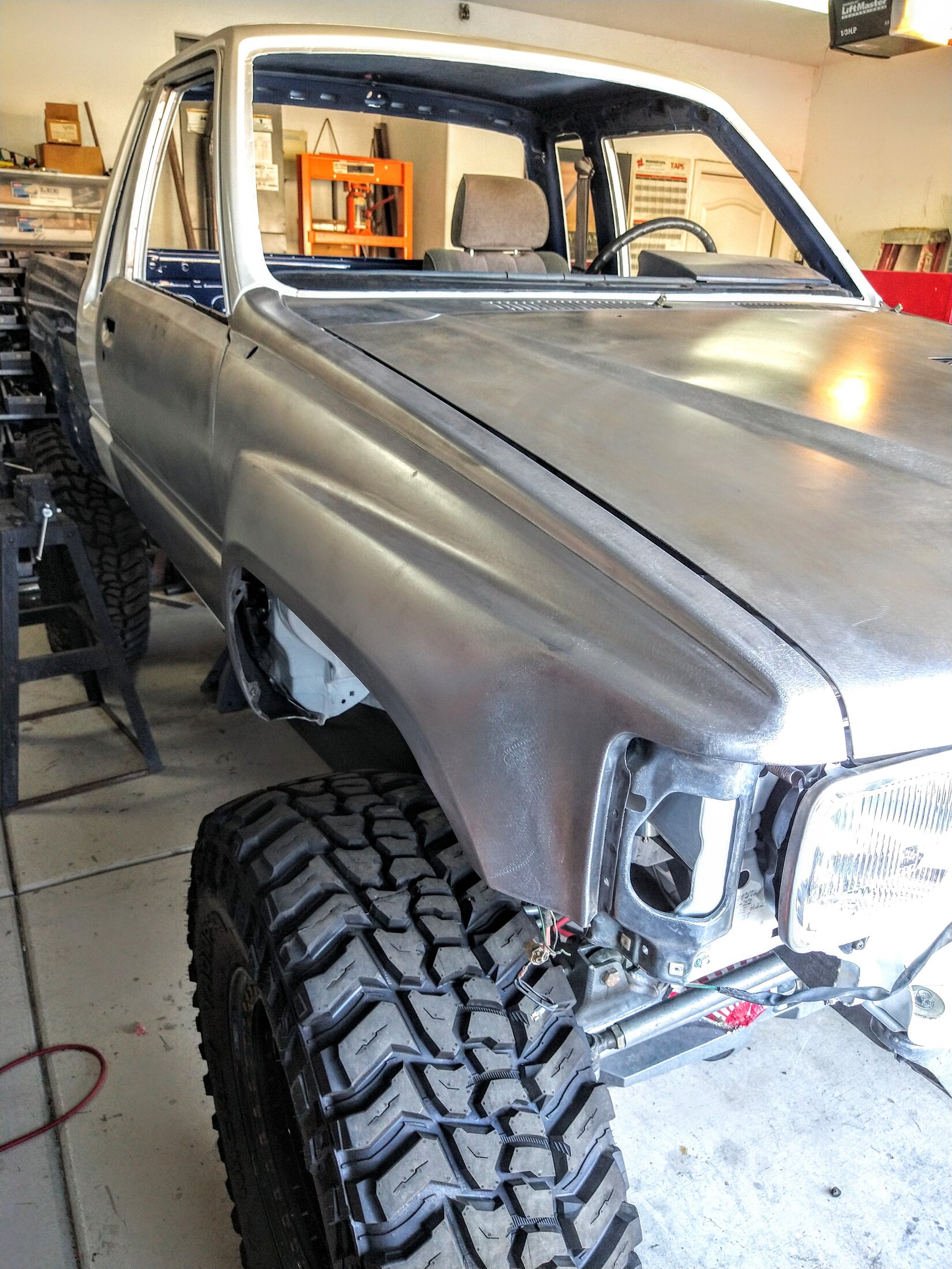

@Carp888 here is the prep and etch I use and some recent pics of it in action.
This hood had the paint baked off it. The truck sat abandoned in the AZ sun since 1999.
Here's after a few minutes and a quick hose down. I sprayed a second round of prep and etch (used full strength) and that's the second pic. It never turned anything black that I used it on except parts I left in a bucket overnight. It wipes off. It's just a light coating kind of like parkerizing.
Light rust washes right off with water. You can speed up the heavier stuff with wire brush or scotchbright pads. Wear gloves. It's not like pool acid but it still affects your skin.
It will flash rust super fast so you need to dry it. I sand it with my DA sander and it stays clean.
Some epoxy primers are VERY sensitive to phosphoric acid and MUST be neutralized or it will affect your paint job. So read your paint tech sheet.
My parts after sanding with 80 grit. I'm in AZ so it doesn't flash rust unless I get water on it.
