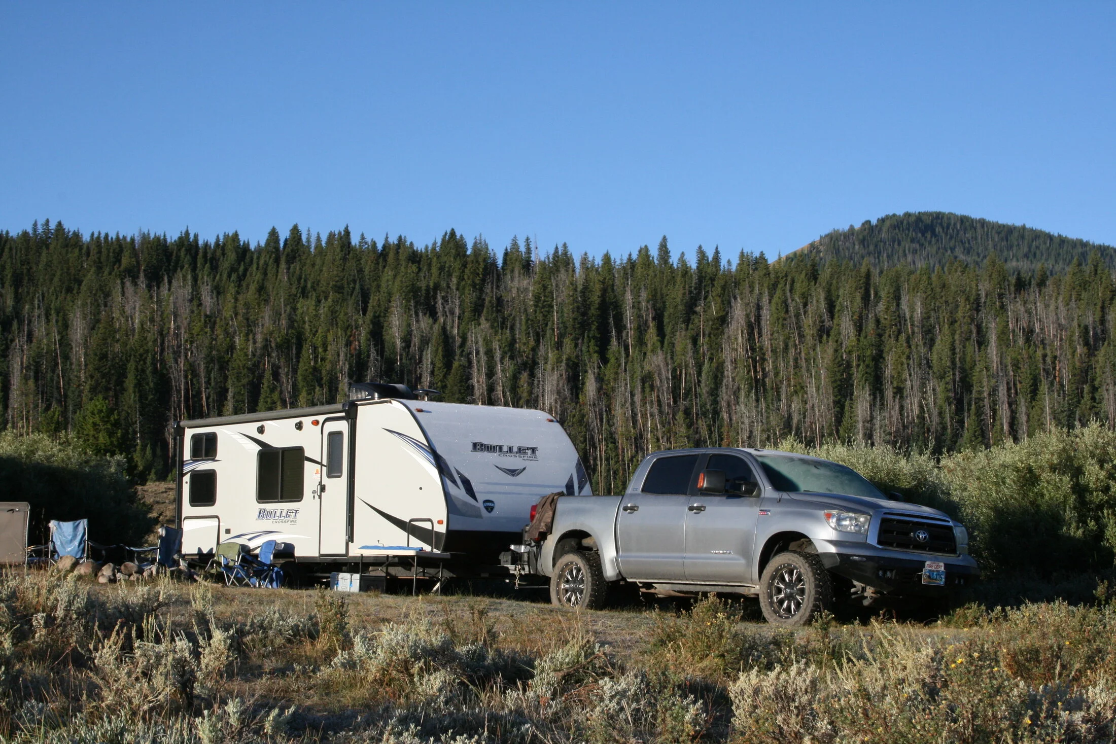

I have a 2013 Tundra that I got for pulling a camper trailer. It came with 20" Fuel wheels with 33"12.5 tires, which seemed to work great as a puller. I sold the camper a couple of years ago, about the same time I sold my 80 series. I now have a 40 series but I hate taking it on longer trips and it doesn't fit the family very well.

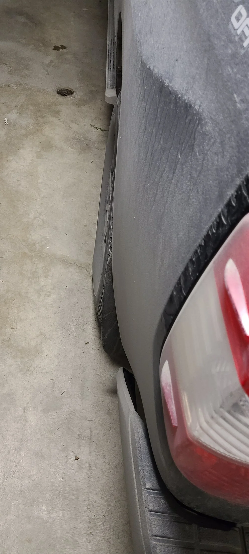

Most 285/75R18" will fit with no cutting with a 18x8 +25 offset. I'm going to run that size
with factory +60 offset wheel. I've lowered my 2010 in back but it won't effect my truck.

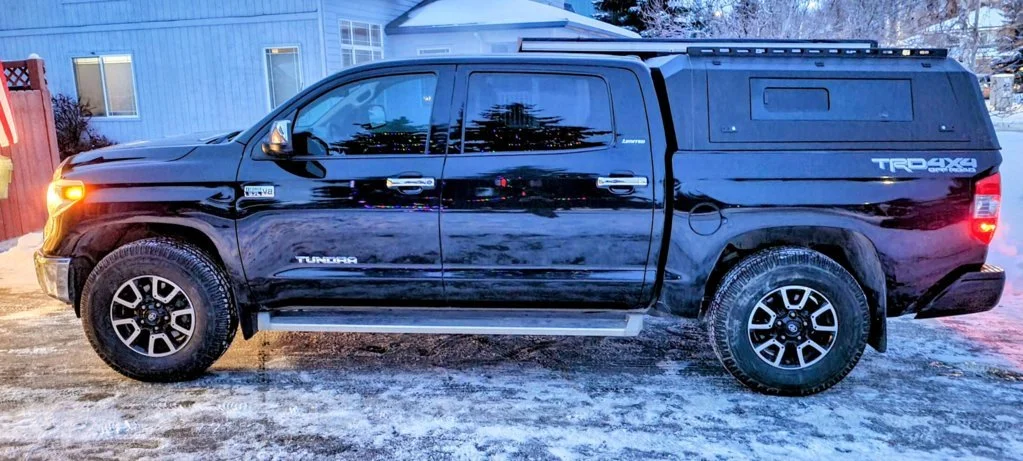

FWIW - I have 295/70/18s on stock TRD wheels that are also 8 inches wide. Seems like a pretty good match to the wheels. The tread width is about 9 inches so it's relatively vertical sidewall. Just as a comparison I think most people put a 35x12.5 on a 10" wheel. These are about 34.5x11.8. An 8.5" wheel is ideal according the mfg. 9" might be a little better. But 8" works okay and visually looks pretty normal on the tires I have. Yours might be a bit more aggressive and look funny on the narrow wheels?
No lift or modifications needed other than a little trimming of the skid plate wings by the sway bar. They're so thin that you can just trim with tin snips without even taking the skid off off. At stock height with that size in a street tire tread - they really don't look very big. TBH I don't think you'd even know that they're oversize unless someone really looked close or it's parked side by side with a stock size tire.
Edit: here's the side profile with stock wheels if that's useful. Still inside the fender even without flares.
