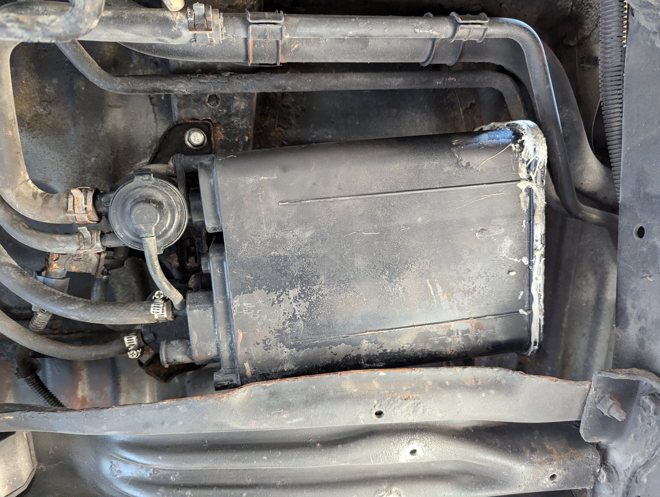

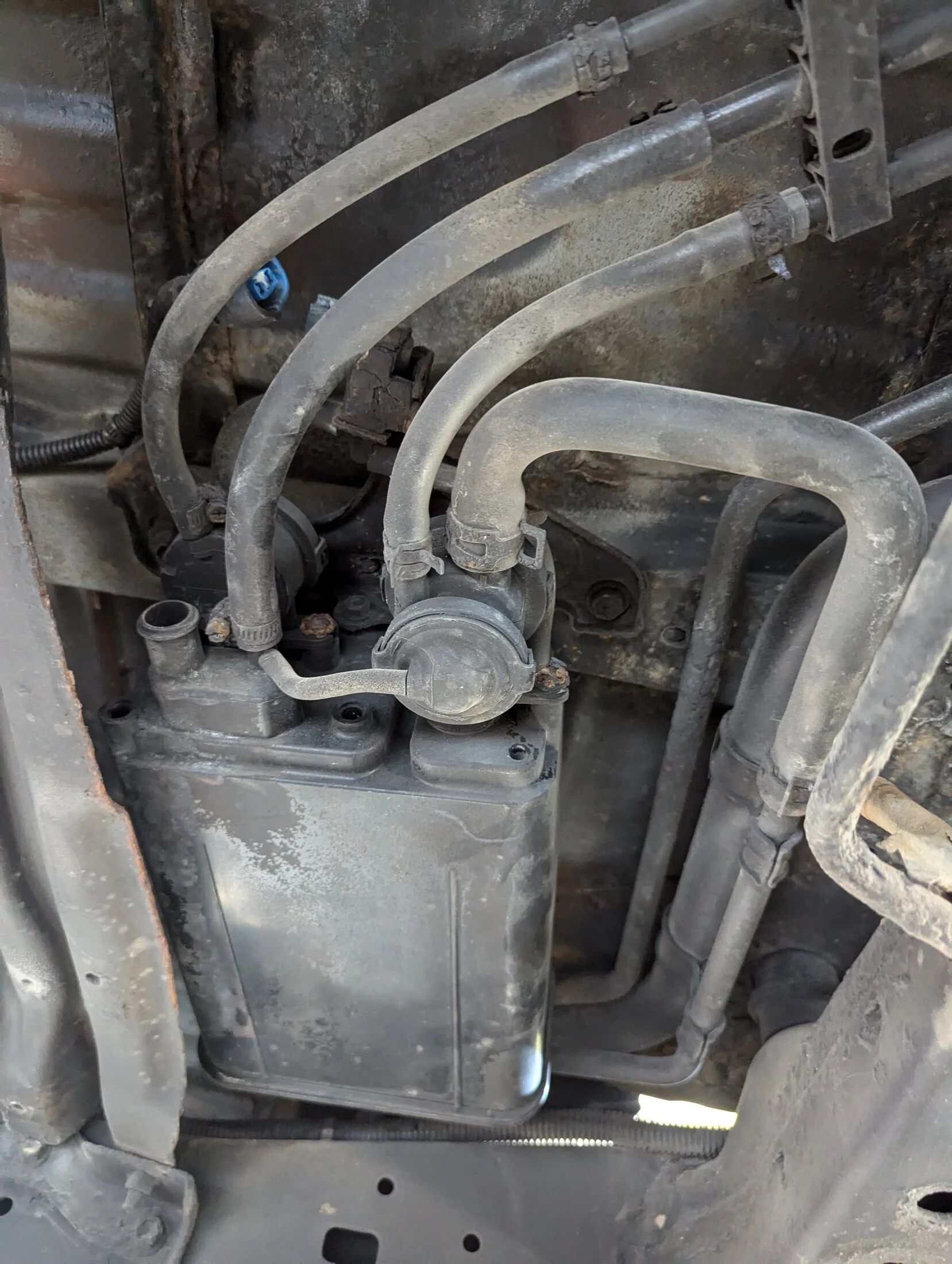

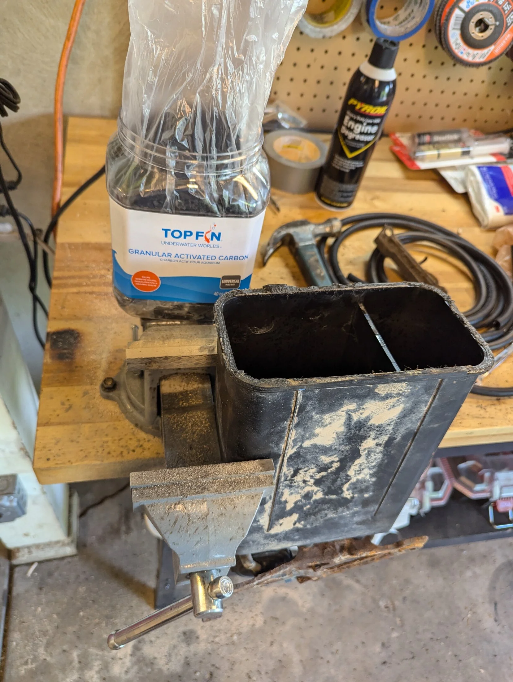

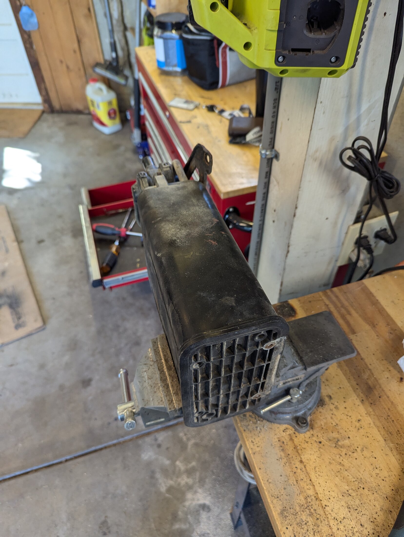

After reading up some more, it sounds like I flooded the Charcoal Canister (with the latter 100 series being more susceptible). Given that the Charcoal Canisters are $500+ new ($900ish for OEM), figured I'd open mine up and replace the charcoal and clean it out.
I've seen two other methods - cut the whole thing in half, or cut a hole in it and stuff it with a funnel. Wasn't a fan of either, and after removing the CC I noticed a seam where it looks like the cover is press fit in. Took a hammer and screwdriver around the outside seal and eventually it popped right off!
From there, dumped the old charcoal and pulled the filters. All filters washed throughouly with soap and water and allowed to dry fully. Filled the thing back up with activated charcoal (from PetSmart fish section). The "lid" popped back into place and I applied a liberal amount of jb plastic weld. Let that fully cure and slapped the CC back in there.
All in all, 2 hour job when accounting for dry times. It really was easy, and total cost around $60 bucks (also replaced all m8 and m6 bolts).
Not going to jinx it yet, but the four test starts I did in the last few hours, it's started right up every time! Tomorrow will be the real rest (super hot tomorrow), and will be in the worst conditions for the issue (hot car and hot air). Will follow up here with how that goes.
Shout-out to Mike NXP for saving me $100 bucks on a FPR :)

For legal purposes I'm making this post from Florida (something something can't tamper with emissions equipment)

Wow , impressive. I thought you were a bit nutty when you suggested opening and replacing charcoal.....i suspect others will be interested in trying this .
True test will be some wheeling on a hot day with lots of climbing like your original issue was caused by .
Nice work
Nice and hot today. Multiple starts with no issues where as before it would be 10+ seconds cranking. Dare I say she's fixed!
I suspect I flooded the CC after topping off my tank and driving over the mountains to get to Logan UT. Was about 102 at the time doing a hill climb with a completely full tank. Time to add a heat shield and only fill to 3/4 tank in the summers.
