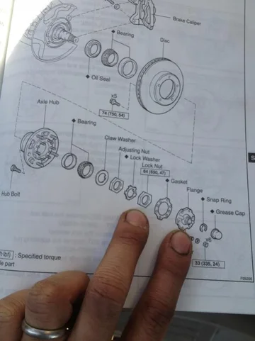

Ok. In the pic am I removing the grease cap snap ring, cone washers, flange, and gasket leaving the lock nut and lock lock washer in place?
Yes. The flange has teeth on the inside. These mesh with the cv. With the drive shaft pulled the wheels via that flange will turn the cv's and front diff.
Just pull the flanges, nothing else. Cover opening with plastic bags or duct tape to keep debris from contaminating the wheel bearings. Put wheels back on.
In the photo the first 4 things needs to be removed and leave out. Grease cap, snap ring, (all the bolts that holds the flange and gasket.
Cover it up like mxndrnks suggested and you should be good. You will have a free spinning front end at this point.
How exactly do I remove the flange? I took off everything from the snapping and only have the flange itself to remove.
Make sure you got the cone washers off. they are behind the nuts and washers.
Once those are off I just used a chisel. But you can use a flat head screwdriver.

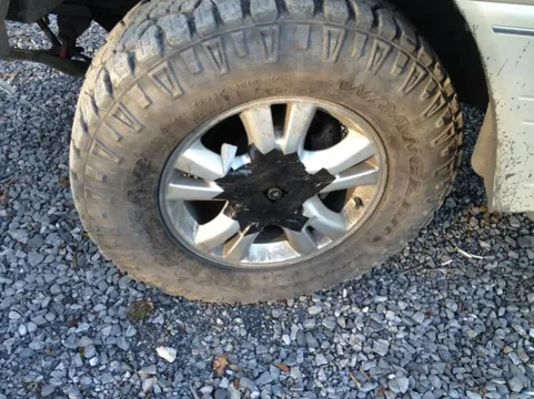

In place of tape / soda bottle, can one use the center cap and call it a day? I would think it would be possible so long as I wasn't traveling in wet or dusty conditions no?
I am concerned that by putting a piece of tape backward ( non sticky side toward axle) that it may somehow catch and then cause the rest of the tape to get pulled off. The axle seems not to be flush with the surface of the rim (wheel area around hub that I have tape on currently). The axle seems to protrude beyond there that's why I elected not to cover it. I would love to see how people place a soda bottle over it.
