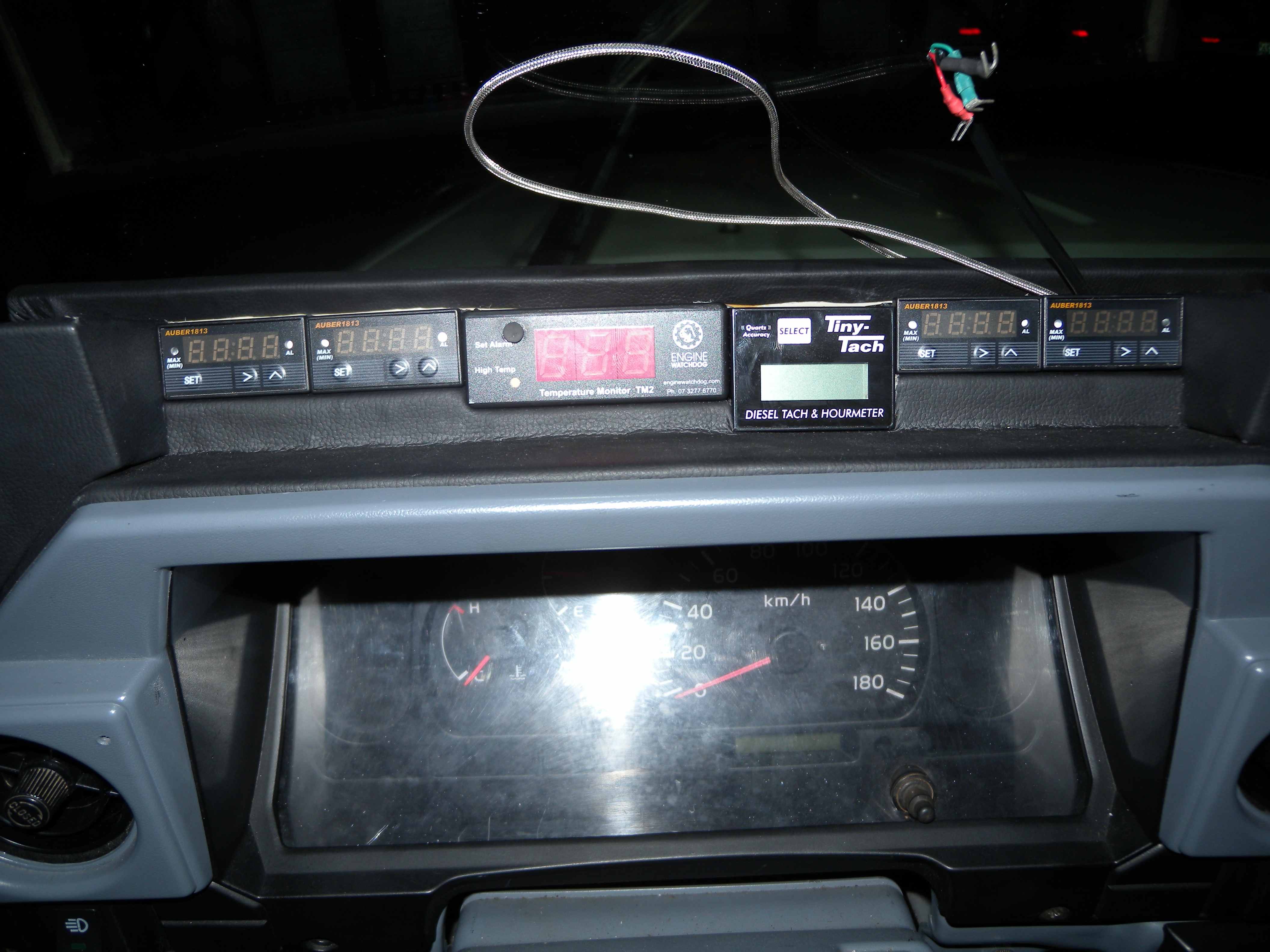

i tried this route and looked into it extensively, you basically need an entirely new instrument cluster with the desired sensor gauges included (don't even think about buying individual gauges and adding)... then you need the factory tacho sender as well, but there's no guarantees that the existing loom behind the instrument cluster will have the unused wires present to just plug n play, or that the existing wiring connectors will have the same configuration for the new cluster panel. It is extremely expensive if you can't get the parts second hand, toyota quoted me thousands to my utter dismay just for parts with no guarantee it would match up (they refused to install it for me if i went ahead with the purchase). i went with a backlit tinytach, which is dead easy to install, seems to work quite well and you get an hour meter as well, and I spent all the cash saved on heaps of other things.
but to be really useful when driving i would suggest mounting it in a hood above the instrument cluster so its in your line of vision. here's my installation (without the cover on top) to give you an idea of its size.

as we said before it runs off the injector pipes - usually cylinder no 1 however i notice my rebuilt egine its on injector pipe no 2 and no issue. I will take some pics today when I collect the RED truck at the hotel after it's RFC 2013 adventure.
