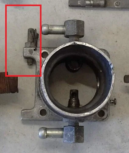

Did the diaphragm go back in correctly with the little tab facing downwards? Did the shims and spring go back in?
Relevant photos in this guide..

On the "throttle body" you'll find a screw that sets the idle speed.. when the diaphragm fails the idle speed increases.. often people wind down the idle screw to compensate until the underlying fault is fixed.
