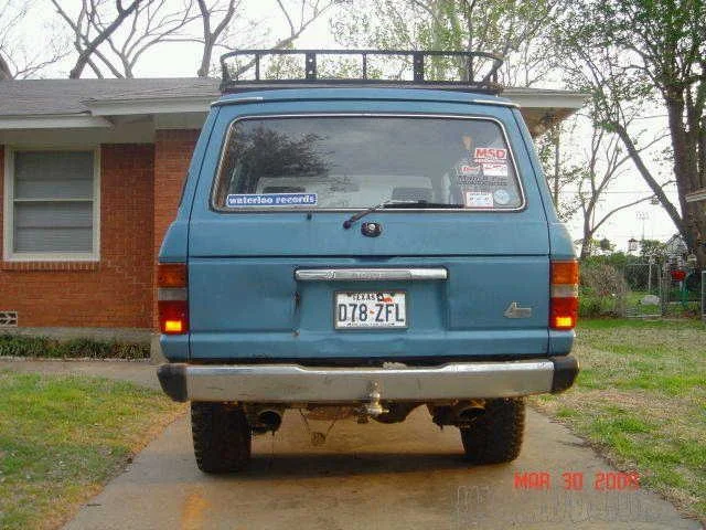

Well as usual dollar short and a day late. But here goes. Big Blue is a 1983 FJ60 owened by my brother Terry (TPattyII) for the past 6-8 years. I bacame the caretaker of Big Blue after his passing in Jan. The truck came stock with the original 2F. After finding that the truck had no HP he had a shop (that will remain unnamed) perform a 350 swap. The truck never was the same. It never ran right, Sucked gas and in general couldn't go anywhere's. After being parked for 4 months, I eventually moved up to DFW where I began to turn a wrench on her. After a few weeks she was up and running. Big Blue was never meant to be a show truck. All she needed to do was wheel hard and get the family home. Many nights and days were spent keeping her on the road. It seemed like it was always something to do on her to make it go faster and wheel harder. The best question ever posed to me by Terry was while I was fixing the bent tie rod end,"Do we need that, What does it do, and what's for dinner." So after that I knew he was not going to be turning the wrench. Here are the list of mod's are as follows:
350 w/mild cam
Original 4 speed
Holley Projection system
OME suspension 2.5"
MSD 6 series ignition
33.50X12.50 Wranglers on white steelies
and NO EMISSIONS STUFF
Other mods:
Cracked front windshield (canoe accident)
Missing front grille (run in with a bush)
Broken light bezels (same bush)
Dented front drivers fender (TREE!)
Dented rear gate (late night partying)
No A/C (don't need A/C to wheel)
No seatbelts (Terry didn't like them after they quit working)
Dented roof (good place to put the tire)
Doors don't open (because they are ready to fall apart!)
I have most of the parts to bring her back up but that would mean changing the truck from the way Terry left her to me. I may wait awhile.Hell, It even has the 2" of mud from when he got stuck and had Big Tom pull her out with the Dodge. BTW his Dodge had a nice battle scar to prove it.
This is the truck that got me started doing Vortec conversions in cruisers. He had an idea that it would be fun and make a little money. This truck although riden hard and put to bed wet has more memories of us standing over it saying," what's next?" It really isn't the truck that makes it special it is all the memories we have in it and the fun it was to build it and maintain it... Enjoy
