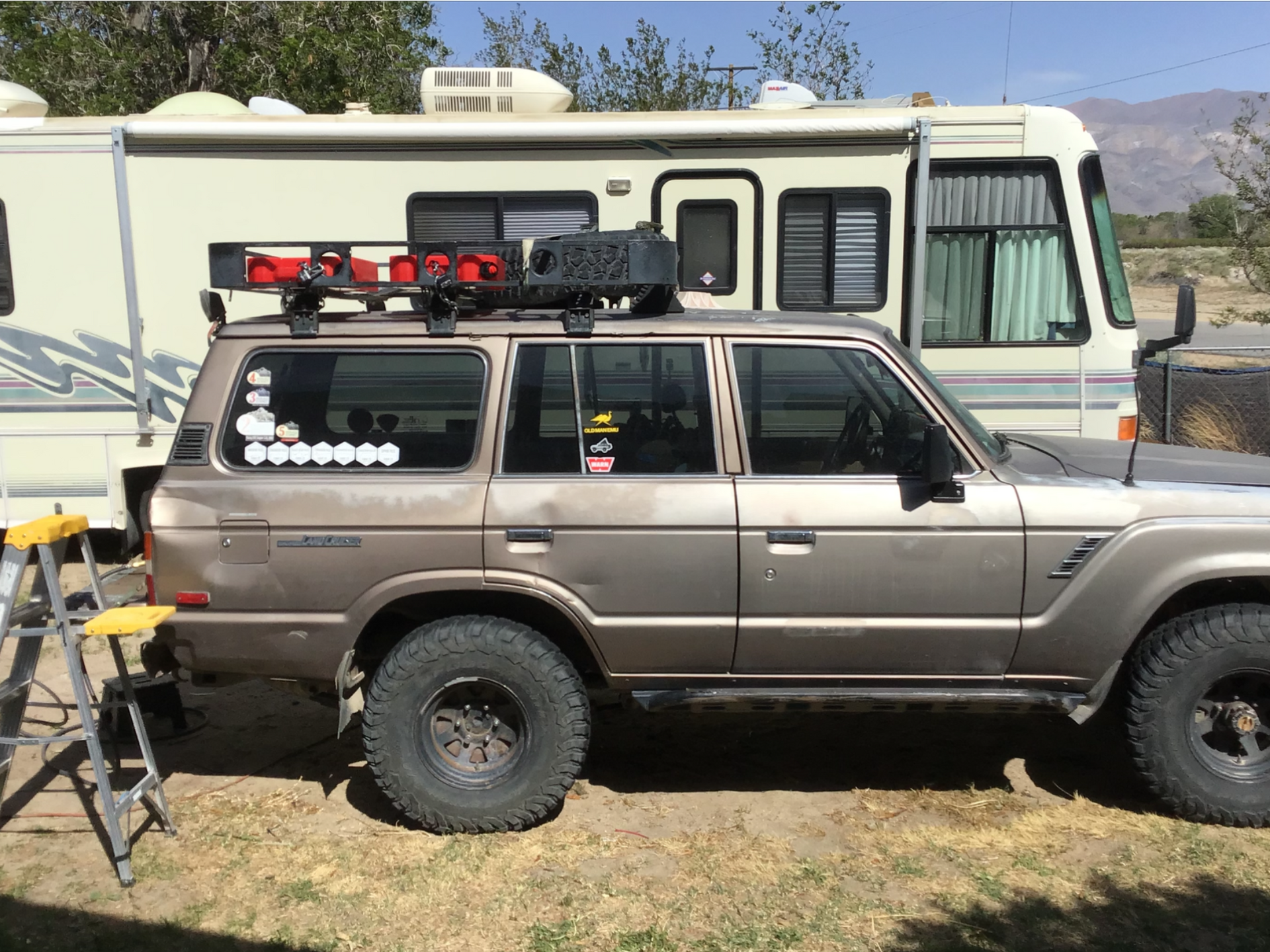

On my van I had them on the roof until my rear bumper came in and it was fine here in CA, even in Death Valley at 110F. You see 100s of people carrying it on the side of the vehicle and also on top.

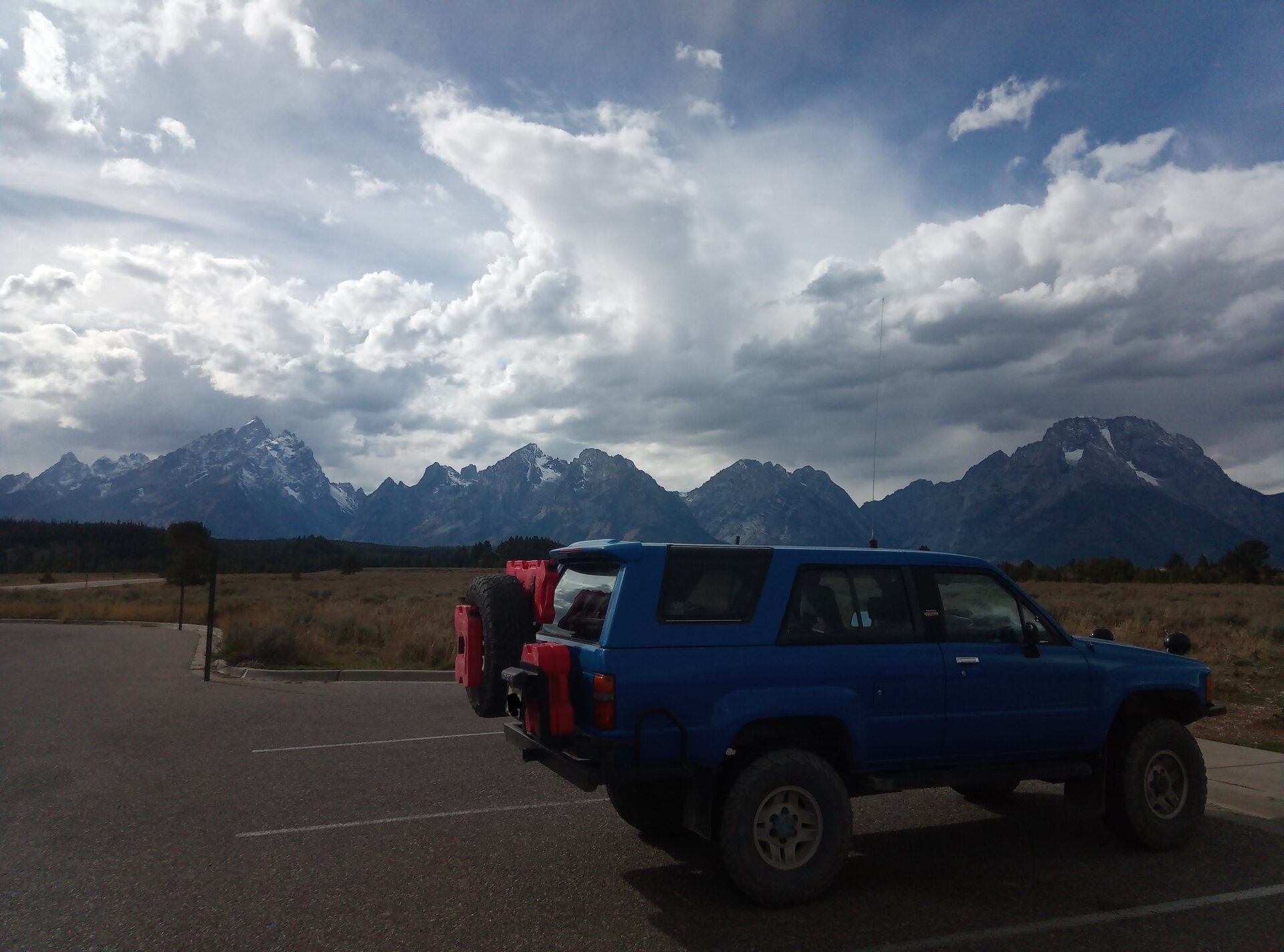

I have a couple of Rotopax on my 4Runner. I like the small size and the handles on all sides, but they do seep a little bit with elevation and temperature changes. You are supposed to crack them open and then close them to prevent this, and I do, but I wouldn't put them on my roof.
Do you have a rear bumper you mounted them on?
Yes. It fits 3x 2 gallon and 1x 4 gallon pax using their mounts. If I was to do it over, I would do 5x 2 gallon pax an no 4 gallon.

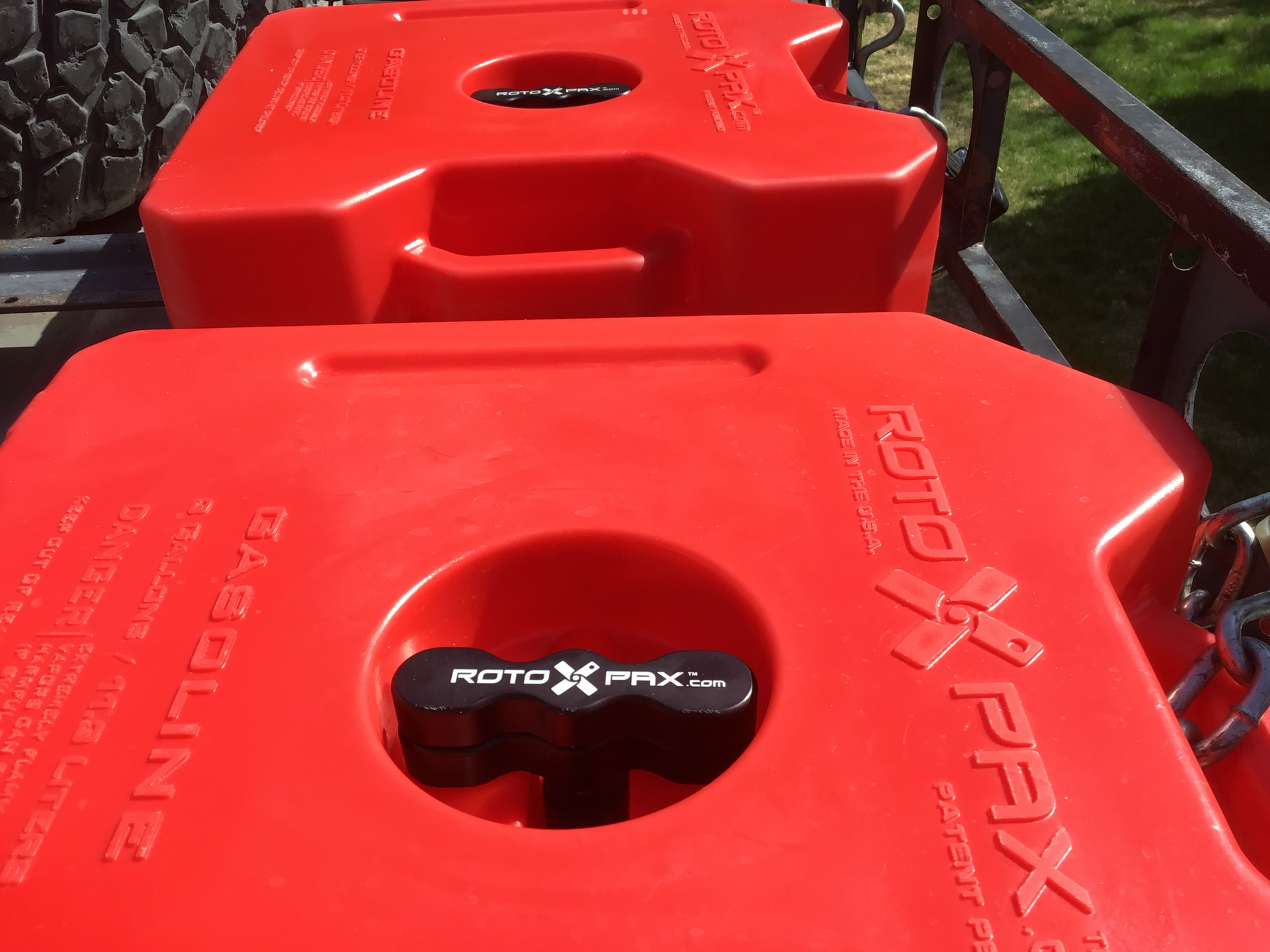

I always carry one & sometimes two RotoPaxs on my roof. Used to have a leaking problem. Since has been solved after an interesting phone & email conversation with RotoPax.
They offered the following advice which is totally contrary to what I expected. But it has worked:
They advised to fill the containers as full as possible at the gas station. AND THEN…once home find my lawnmower gas can and completely fill the RotoPax to the top. I do bleed it every so often.
Their advice has worked for me.🙉
That actually makes sense. A gas (a gas such as air, not gasoline) will change volume orders of magnitude more with temperature and elevation (pressure) changes than a liquid will.
Well, it has worked for me, so I guess it does make sense. For some reason I thought it best to leave some room in order to allow the gasoline to expand.
RotoPax said to fill it all the way to the top…and it has been leak free. Over a year now and at least one on top 365.
