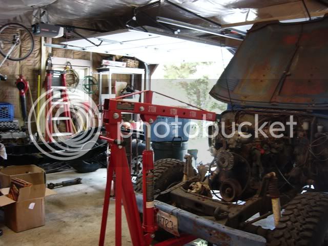

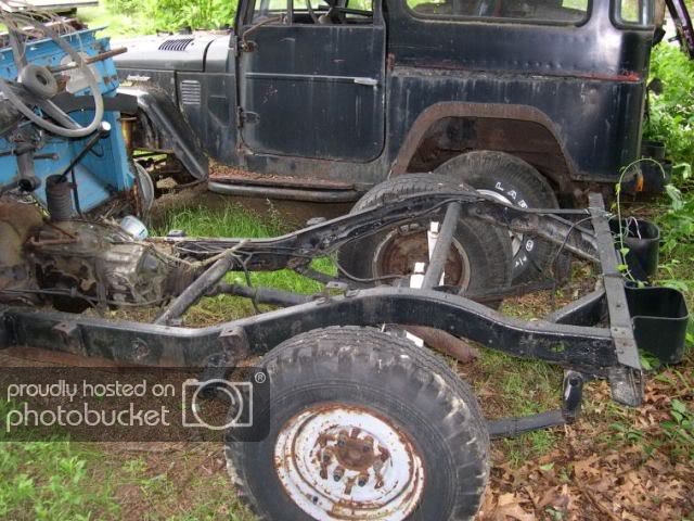

I had a 1967 40 that was basically my first toy and my introduction into auto mechanics and such. Had alot of fun driving, wheeling and fixing it. Got really familiar with the world of 4-wheel manually adjusted drums and what driving an old Toyota is all about. I ended up replacing the F engine with a later 2F/4-speed/3 speed x-fer combo that ran really nice. The frame was on its way out and I didn't feel to safe so I parked it with the plans of replacing the frame "at some point". About 4 years later it was time to start tearing it apart and making a plan.
Here is what I found....

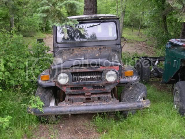

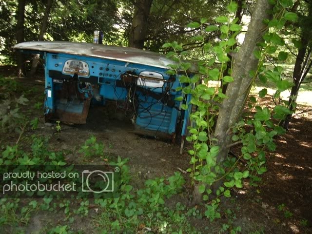

So the search for a donor started... I came across these on craigslist in CT.
The seller said they were all going to the junkyard in a week so free picking for $500. I went down there with a Uhaul with a full car trailer and loaded this guy (1976) up along with everything I could grab and fit in the uhaul...

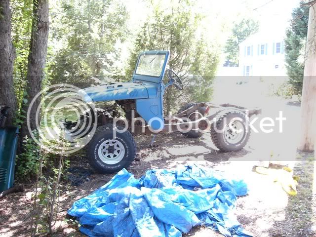

This was summer of 2006... step one, clean and POR the chassis and add a 4" HFS lift...
And then the donations began...

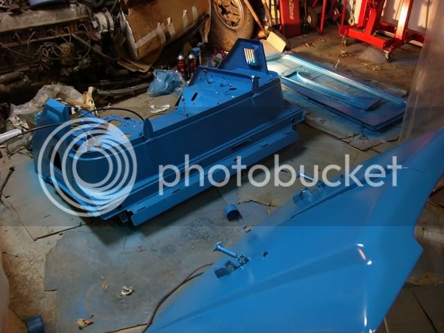

I was diligent and just started cleaning/repairing/replacing as I went. (Paint is Ace hardware safety blue out of a can)

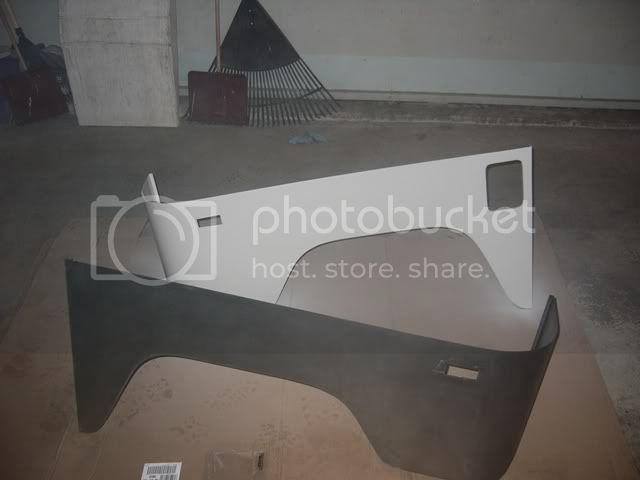

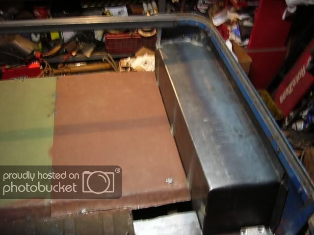

I replaced the rear bed, supports, rear sill and wheel wells (all home made) and quarters (CCOT)...

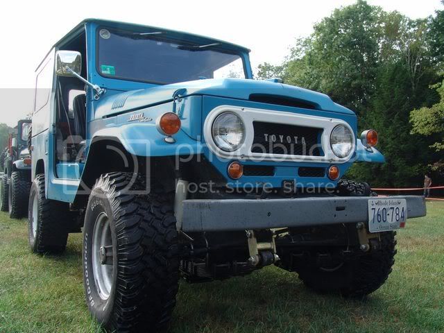

Then it was mostly clean and paint the body and get it on the road. Made it to the fall gathering and had a blast. It had been on the road for about 4 months at this point.

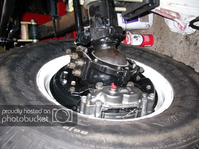

All new brakes and stainless lines

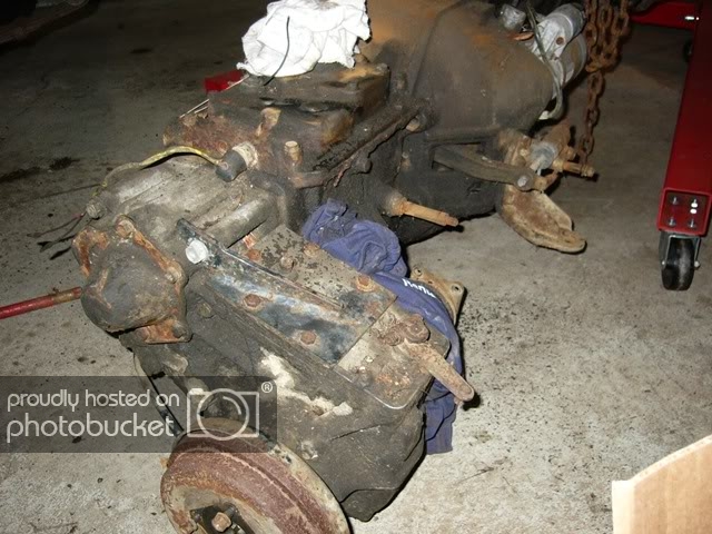

xfer rebuilt
H41 tranny

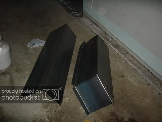

I do not have a brake... that is the only bend that I had done by someone else. I would have tried it if it were 16ga steel but it is 12ga. Paid $100 for a local sheet metal shop to cut the two wells and put that one bend in... I wrestled with the flanges. All the other bends I did by hand or with a vice and some angle iron.
