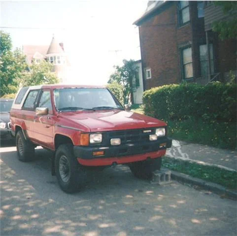

I had owned several Bronco's and was currently abusing a tiny 88 Samurai when I saw this first-gen 4runner sitting flat-tired in a driveway,the solid front axle caught my eye so i pulled in and knocked on the door.The next day she was mine,bone-stock 85 4runner,rotted out leaking brake lines and a supposed timing chain noise is why it had been sitting 2-3 years.This is what it looked like after AAA dumped it in front of my house April 2005.

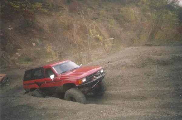

Ok now it gets crazy,did timing chain turns out it was crank/main bearing :doh:.So began my affair with parts vehicles and long hours of wrenching.That year I either bought new or swapped over every part on the truck:censor:.I joke that it became an 05 4runner that year!!Here is what it looked like when I finally got it out on the trail,summer of 05

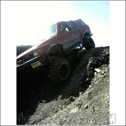

Now the problem was I loved this truck too much,but I also love to push my 4x4's to the limit or beyond in the quest for insanity.Here is a shot of it on the fireroad in Finleyville,PA and one of it after I laid it on its side AGAIN!! My list of carnage includes -----blown head gasket(full throttle 8000 rpm sand drags while overheating...DOUBLE:doh:--------Broke stock tie rod twice and J-arm once-------shattered ring and pinion------rockrash,attempted mud submarine use,and numerous flopovers and rear bumper stands​
