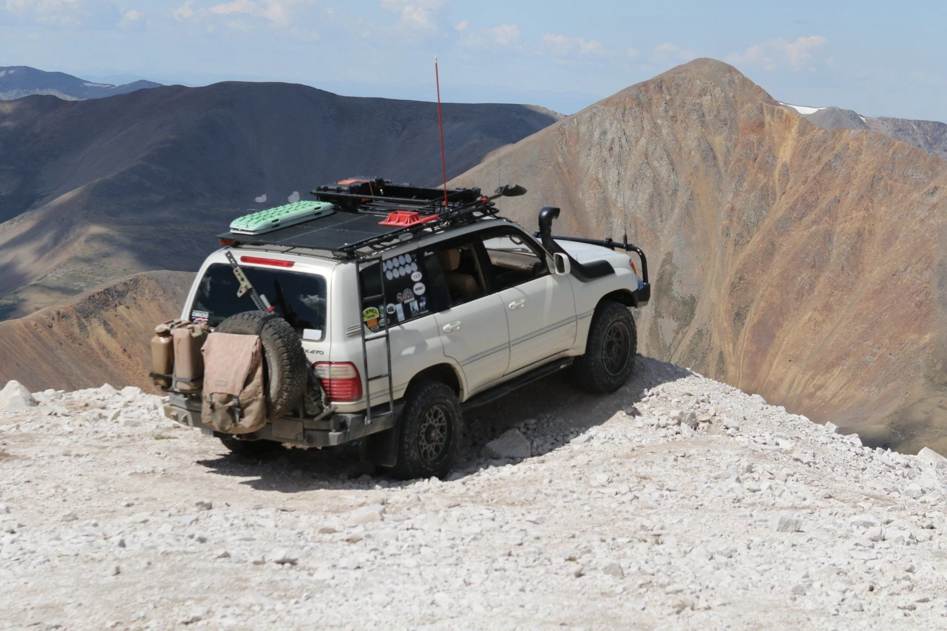

Gamiviti 1000% Best rack in the biz IMO. Very modular design and can be configured for all sorts of differing setups. The side ladder Tim produces for the rack is a serious bonus. The plastic grid panels he sells can be snapped on and off easily and make both a fantastic tie down setup as well as ground grates outside your tent entrance (keeps dirt, mud, sand etc from being tracking into your tent). Once I unload the rack at basecamp, I unsnap one of the grid panels and put it on the ground at the entrance to my tent. I LOVE that he offers a complete 8 tower setup that utilizes all 8 mounting points on the 100 Series platform. That maximizes your static load capacity and adds a significant safety advantage regarding dynamic load capacity. Best part is, you support a super cool dude (Tim) who has in turn supported our 100 community for a LONG time. It is a low profile BTW.

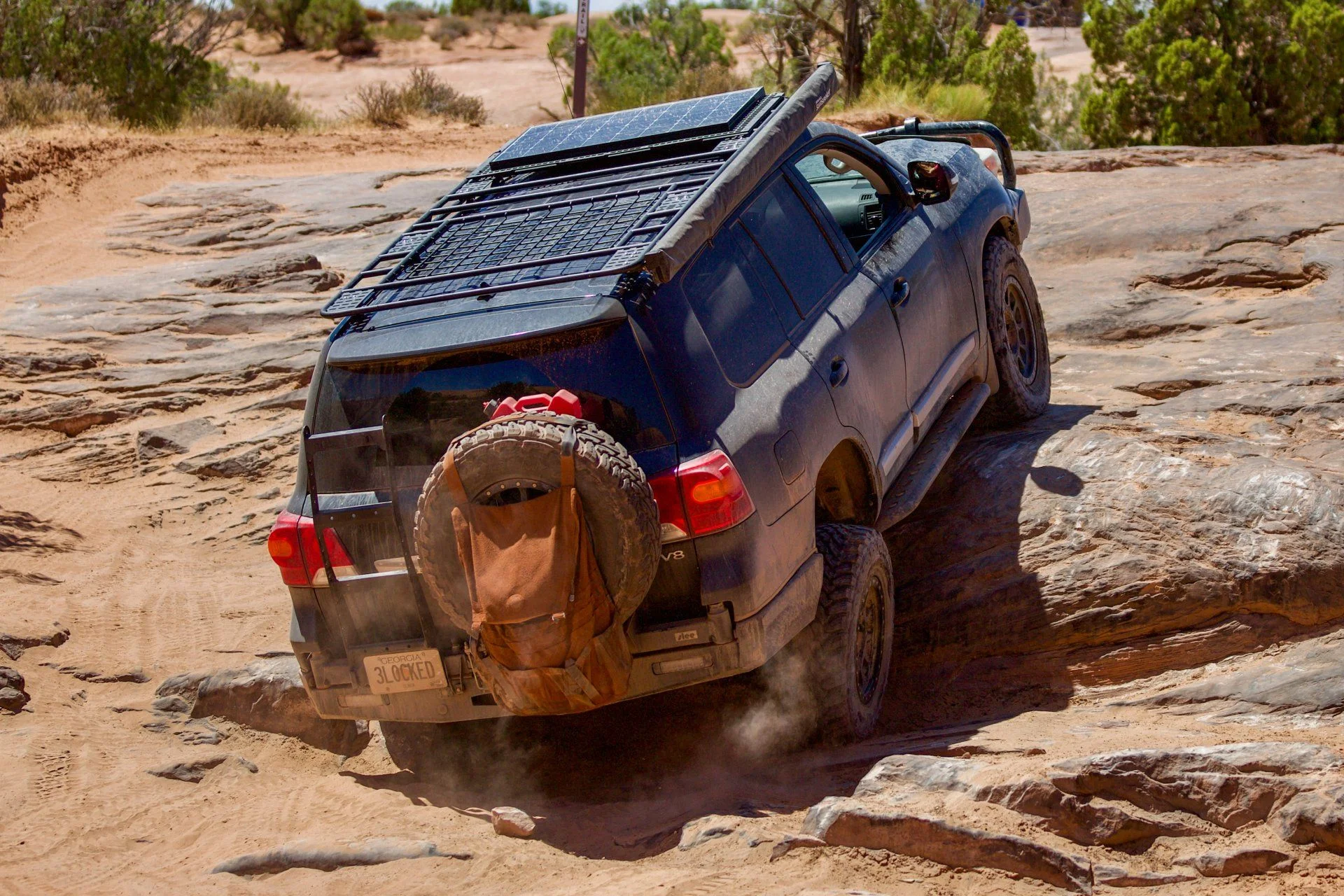

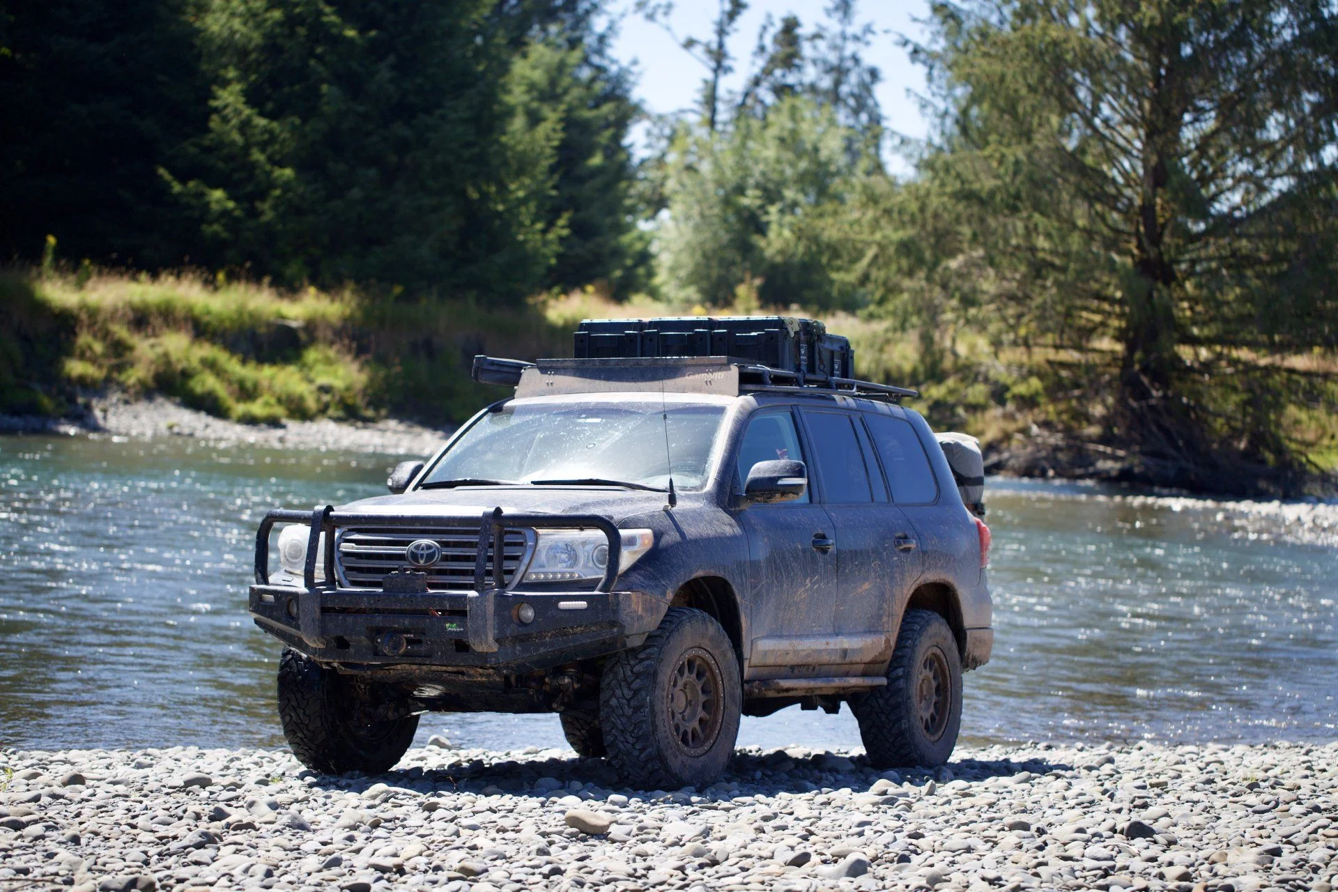

WARNING: This is my 200 but included for informational purposes o_O

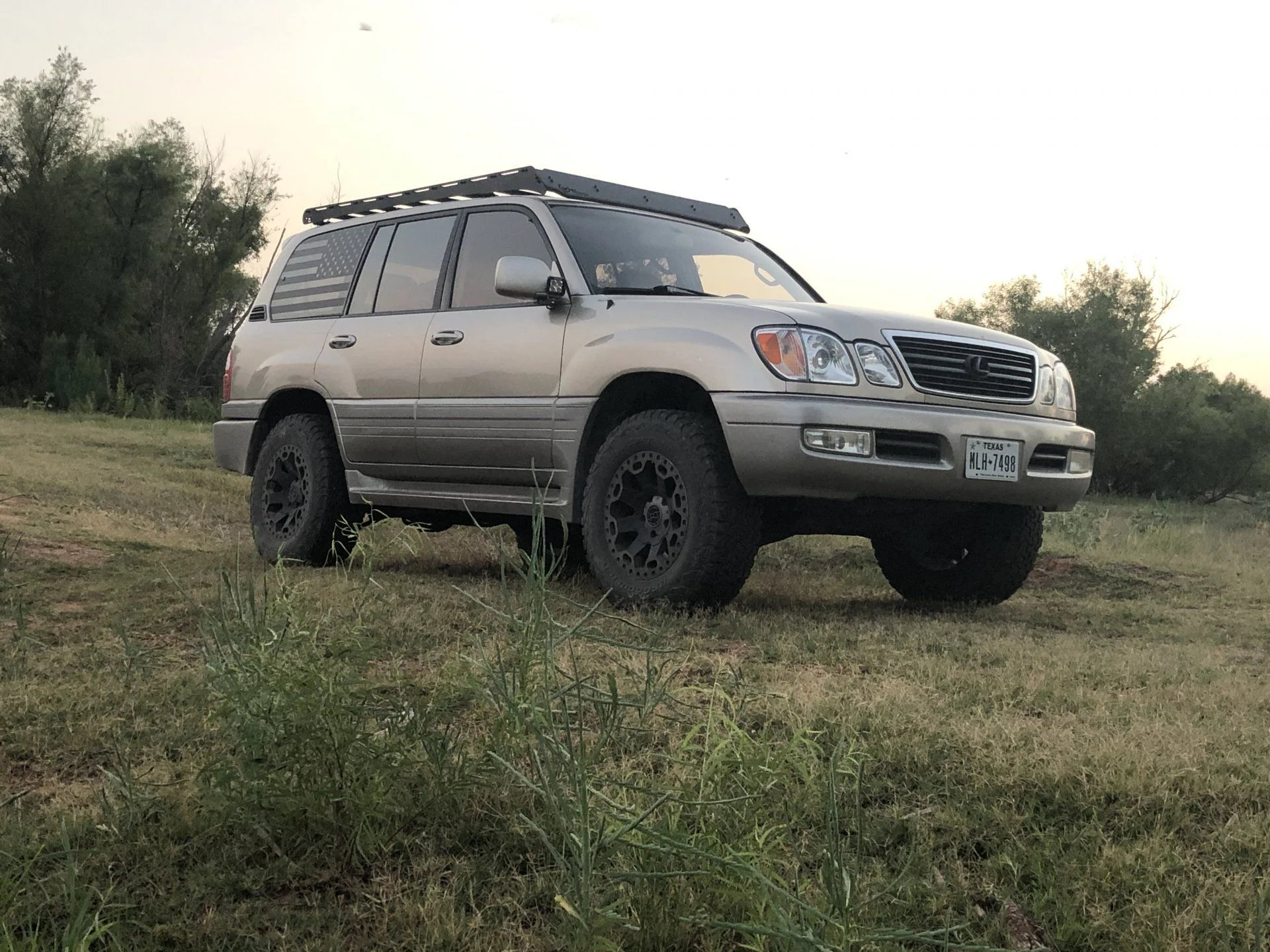

that looks awesome. The American flag stickers look awesome too.

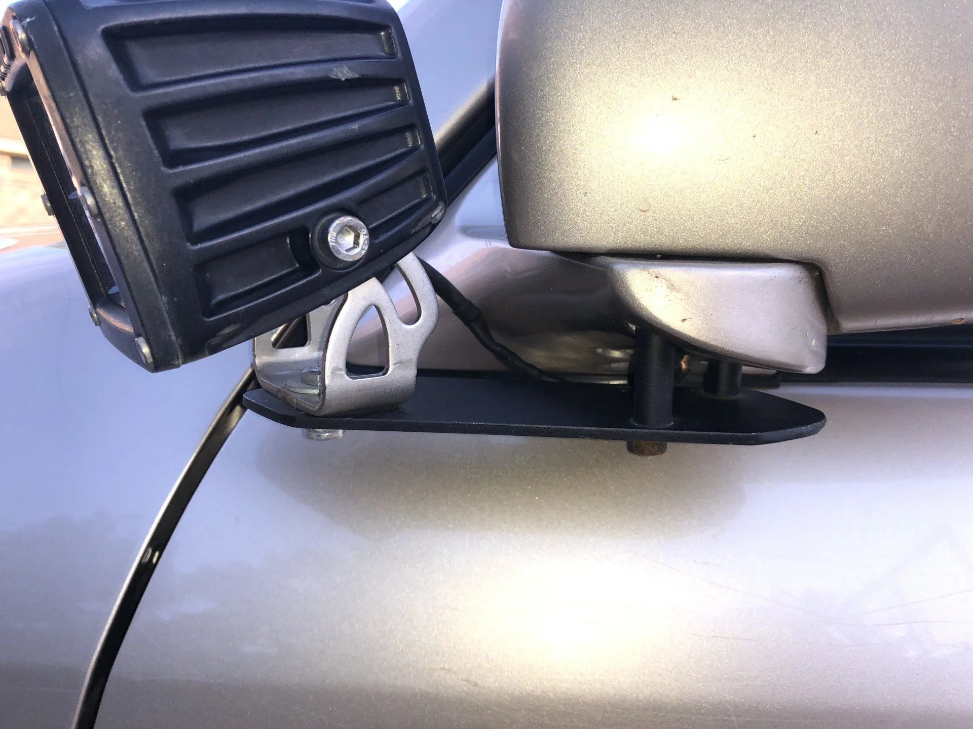

I know this is completely off topic of this thread but how did you mount your ditch lights? I really like that!
Thanks! I was disappointed to find that yodateq didn’t make side mirror brackets for 100s so I took a strip of aluminum, cut it, rounded off the corners and then drilled holes that line up with the small bolts that hold the mirror assembly to the part that connects to the door. (There’s three bolts under there, I used two) then took aluminum spacers to make the mount level and reassembled the mirror with longer bolts. And ran the wires through the mirror assembly in the door, and through the harness grommet to in the cab. I got the idea from a guy that did it to his Tacoma. I can’t find it but I did find this write up. 2nd Gen 4runner Ditch Lights - YotaTech Forums

Thanks for the info. I really like this idea. I might try and copy your design but mine won’t look that clean. Haha.

Go for it. If you don’t have a tap and die set, you’re going to need one. Those three little bots I was talking about - they’re very soft and blue thread locked in. I broke two. But any questions, just dm me
