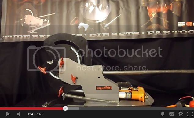

Rogue Fabrication "Alpha" tubing bender, $595 with 180 degree die set
We have some customers with big diesel trucks and they want to build cages out of what some people use for suspension links… So the test of 2.00” heavy wall and high strength material begins.
Testing is done on a “rough” bender we use for demos and such. Bender is a standard production unit, with our 2.00” die set, which comes with the HD kit.

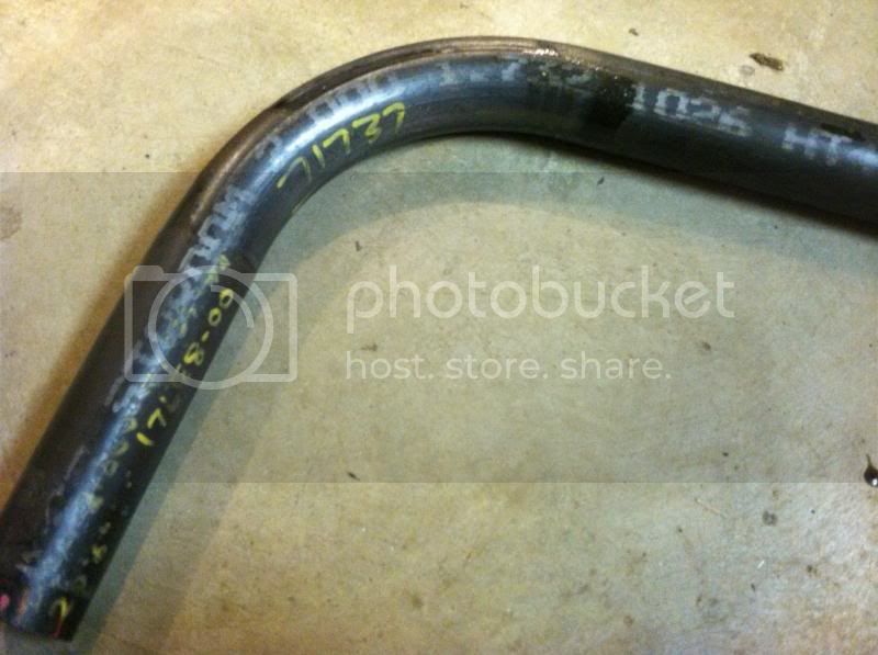

First test is a piece of 2.00x.134 DOM, 1026 carbon steel. If you ask your metal supplier for 1026 instead of 1020 they can probably get it for you, or they may even have it in stock. It is slightly more brittle, but has a significantly higher yield and ultimate strength (1020 is a 48/65 KSI material, 1026 is 60/70). Since yield is when the material permanently bends, this is the real number the bender works against.
As you can see, we didn’t encounter any problems bending the material. This bend was done in one shot on the ram (no re-pin). We got the same deformation that is typical when 2.00 material is bent on a tight radius (3x the OD, or 6”). The small lead in bump that 50K benders eliminate via the use of a wiper die is much less apparent than it was on the 2.00x.120 wall 1020 material. This is expected.

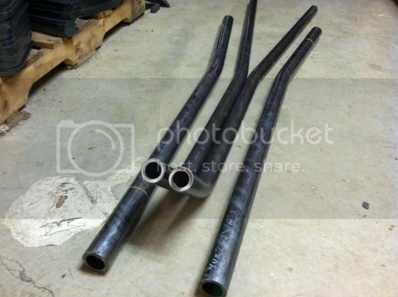

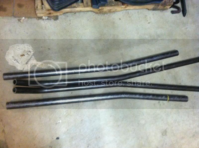

Here is a good reason to bend the heavy walled stuff: suspension links. We bent this tubing for a customer with a 72 bronco. He is going to make radius arms with bends in them for tire clearance. Material is 1.75x.250 and 1.50x.250 DOM.

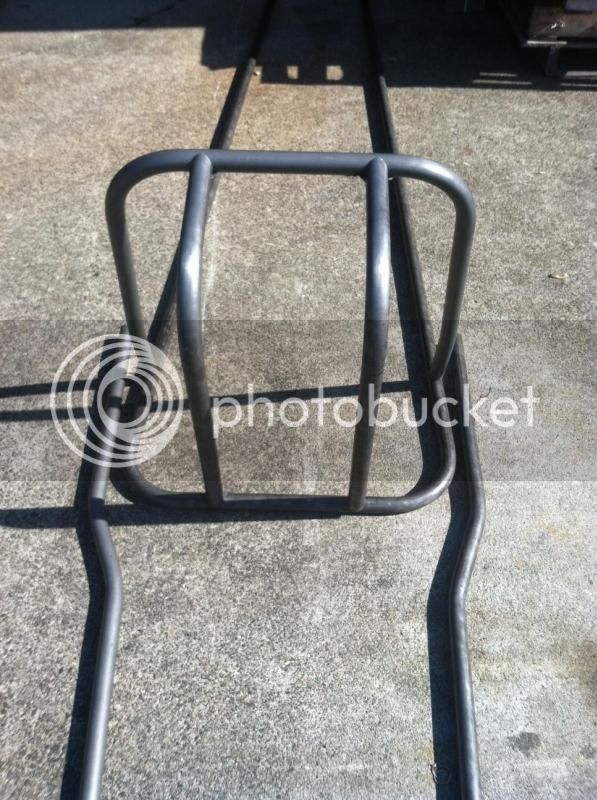

Here is a mini-class mud dragster frame we built for a customer. He wanted us to make this part of it, and he is going to weld it and build the rest. It is made from 1.25x.120 1020 DOM steel and was bent on a Rogue Fabrication Alpha Tubing bender and Notched on a Rogue Fabrication VersaNotcher.

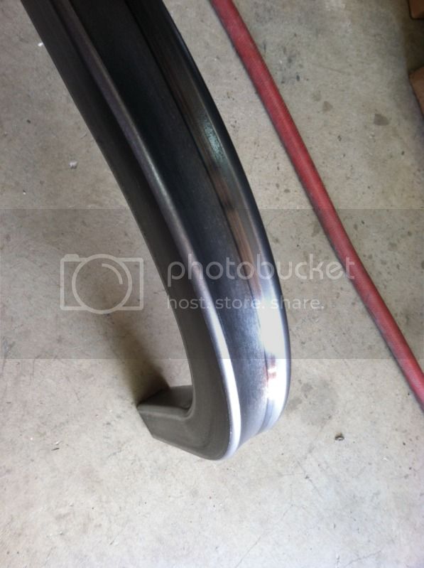

Our customers have been requesting it for a long time now, and we're finally releasing the 1.5 inch square die. Here are the photo results: (.120 wall minimum, 6" CLR, and $349 shipped!).
I'd say that looks pretty nice! Will we be able to chose a set of these with a bender purchase as opposed to round?
