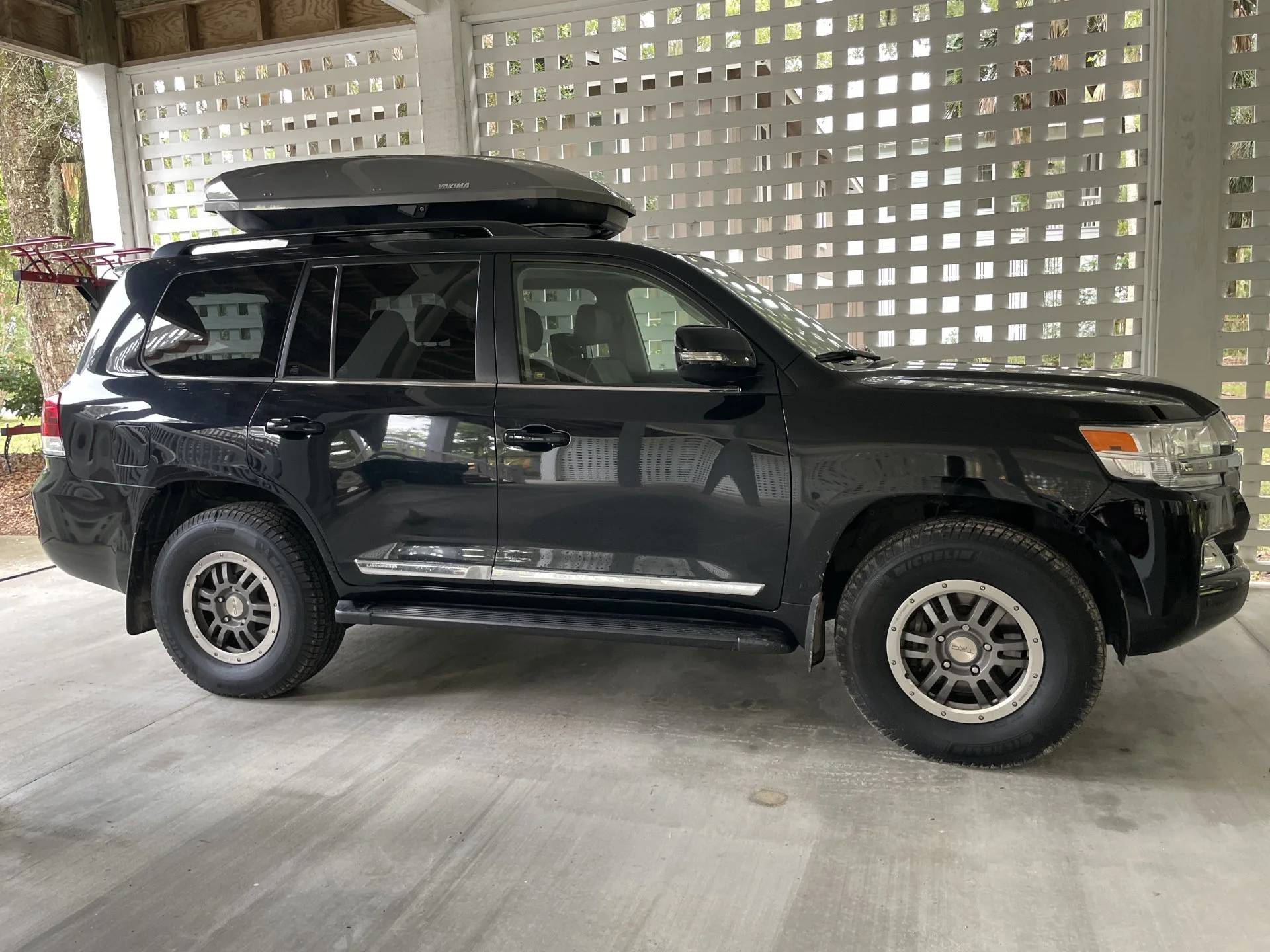

I have had 3 sets of KO2s, last set is still in new condition with 100k miles on them (KO2 DT=Different thread, less snow performance but last forever). Recently, got new Michelin Defender LTXs on my 100 in C rating, I love how the 100 slices and dices on the highway like butter at 100mph. Thinking about getting a defender set for my extra RW set BUT in 285/70 R17 they only come E load rated not C. I like the less firm C for my back (its also nicer for softer landings after going airborne). Since covid I haven't been able to get out as much for adventures and just use my bruiser as highway cruiser so thinking to have more of a road set. I sold my stock rims so I only have the extra brand new 5 RW set currently.

The lightest wheel/tire offering on the 200 was a total weight of around 66 lbs I think (heritage wheels on the land cruiser)
Before that the oem weight was something like 75-79 for land cruiser and lx’s until the 21’s came out on the lx and the heritage wheels came out for the lc…then that shot up to 84 lbs for oem wheel and tire package for the lx (and 66 for the lc)….though the Lexus changed their front coils that year so one might consider that heavier 84 lbs range apples to oranges.
With the rings on the rock warriors the load range c 285 70 r17 k02’s come in at 76 lbs which is basically oem for a land cruiser weight…take the rings off and it gets closer to 71 which inches you towards that light as possible package.
Swap to the new p metric 285 70 r17 (33”) trail terrains from bf goodrich with the rock warriors (rings on) and you get to that 66 lbs number that the heritage land cruisers came with…except unlike the heritage edition land cruiser, you’re getting a 33” tire (vs the 31.5” or so oem tire)
The downside of the p metric 33” though is it will call for 26 or so psi which is squishy compared to the 32-33 psi that the land cruisers and lx’s called for as oem…which means it may feel squirrely on the highway unless you bump the pressure up a bit.
And in bumping the pressure up towards that oem 32-33 psi, you approach the, I think, 35 psi max on the tire.
I don’t know what your overall goal is but if you’re not an off-roader but you want a bit of an aggressive look and perfect weight, scrub radius, etc, you might consider the rw and trail terrain package with a slightly increased psi..maybe 30.
