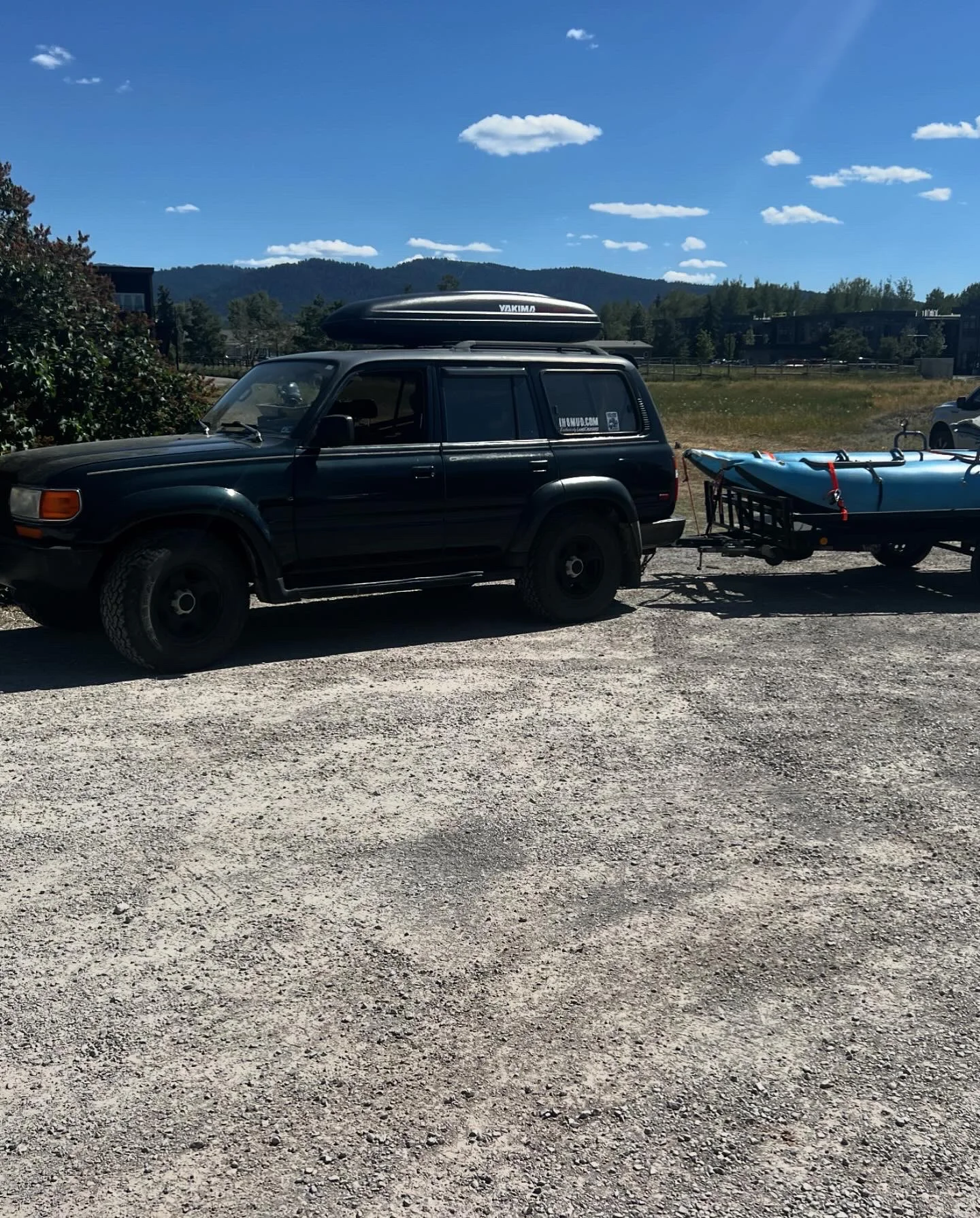

Before we drove our 80 from Va to Idaho winter of ‘22&’23, I put a new radiator and all new hoses in it. Distributor o ring, plugs and wires. Day before we left, the alternator went out and I also replaced the battery at the same time Then drove, and drove and drove. God it took forever. 3 days. That ol cruiser didn’t miss a beat. One morning in Kansas it was -23 on the thermometer. Drove the 200 back from idaho. Went out there after the 4th of July this year. Hooked up the battery, and that ol 80 fired right up after sitting outside all winter
