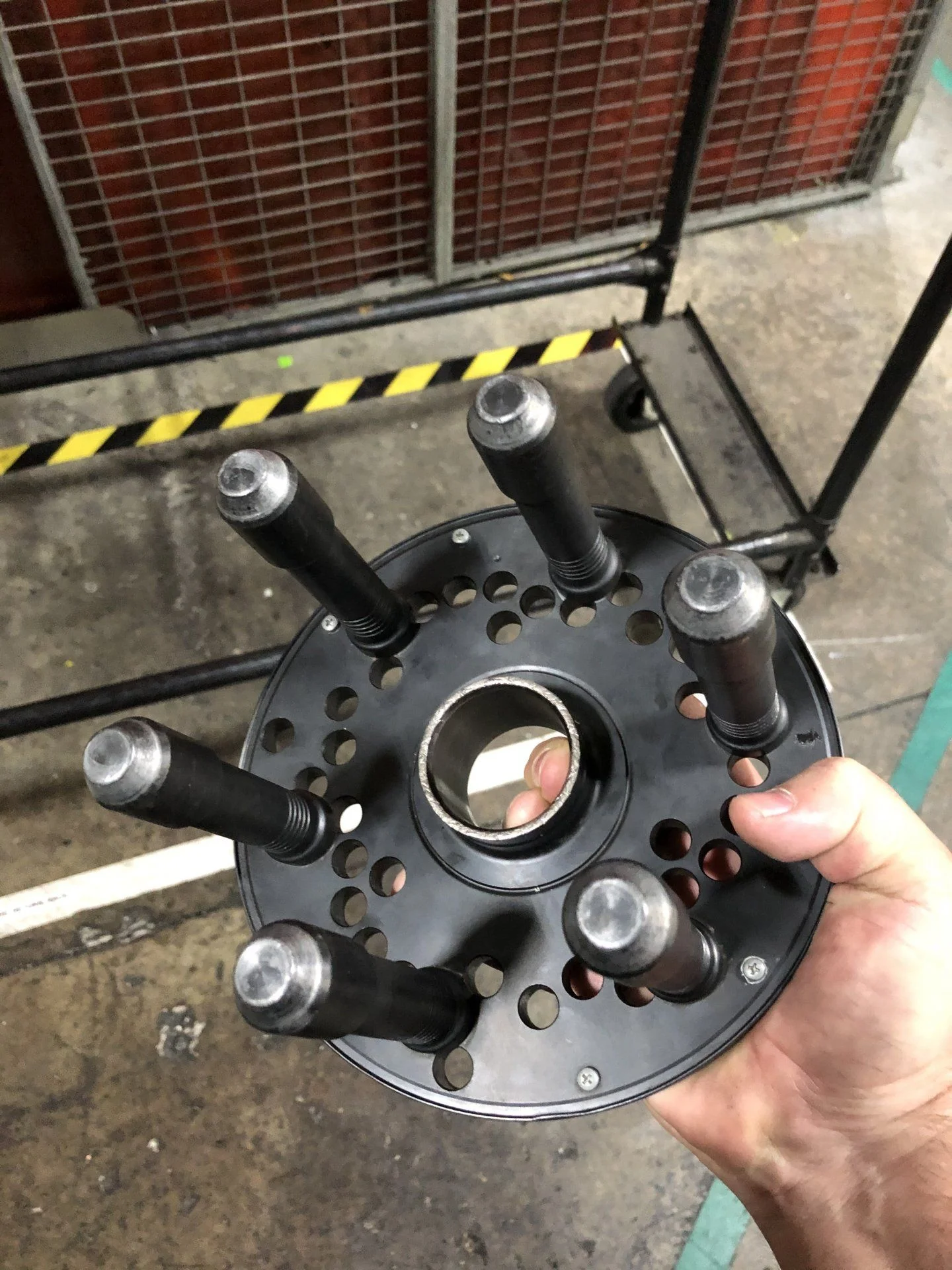

Finding a shop with the proper cone is step one. Most don't have lug centric machines.
Most shops have a range of cones adaptable to most wheels but yes not many have lug centric adapters. I use the lug centric adapters at my job (not in replacement tire industry).
here is what I use.

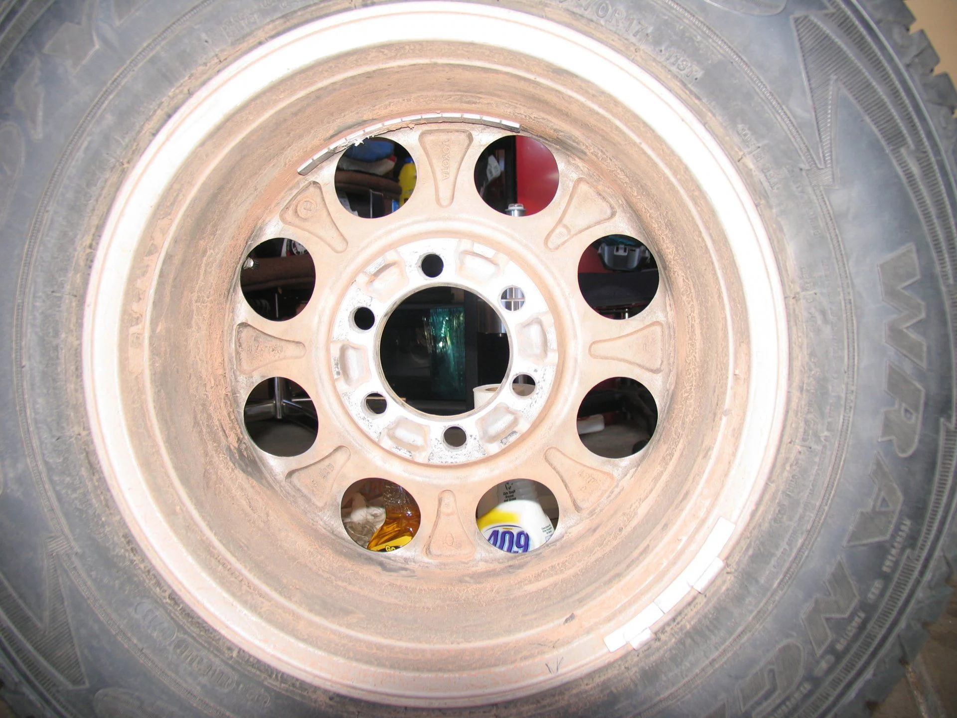

My last tire balance fiasco: And this weight group was after they said my stock tires were defective and replaced them for free. But several attempts to get the new tires balanced, I finally got luck and the service manager at a Toy shop had a great tire mechanic. That was 5 years ago and the tires are just now starting to feel like they need a slight weight adjustment.
You can see the many ounces of weight on opposite sides of the wheel. A sure sign the wheel was not held plumb/perpendicular to the balancer shaft. All four of the "new" tires had this: driving was so much funnn nNN n n NNN nn n nNNNDDNn nnDN n n NDN Nn.
After a "good" mechanic did the balance, there is maybe 1/2 ounce total on each wheel.
