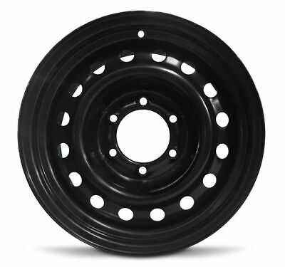

Looking for spare set of 16" steelies for my BJ75, I've found some 2015 Tacoma's with 245/75/16 winter tires. Would these fit right or are they too narrow because of the offset. I know the tires are smaller but I just want the rims if they fit. I presently have 16x7 1/2(came with the truck, I'll post pic later) with 265/75/16. Can I put 265/75/16 on the mentioned rims. What other make of vehicles rims that fit our 70's is the question.

These are what I have and this is what I'm looking at, I'll check the rim depth if the same as mine(3 1/4")

you will need a wheel spacer up front.
Do you happen to know the spacer size? Clean looking wheel skirts :)
just some examples with a 4" backspacing in a 16"wheel.
I've ran the Tundra Spare steelies on a few Troopies, but you will need a bolt on spacer or it will rub frame on tight turns.

On those it's been frame mainly. Usually the issue is tie rod actually. Most Wheel Vintique steel wheels demand a 5mm spacer to clear the tie rod, as do Fifteen52 Analog wheels. But for those tundra steelies, it doesn't hit caliper or tie rod but rather the frame on full lock. A 1.5" spacer fixes this, and looks better in my opinion.

here in venezuela we isntall the fzj80 steel wheels on the 70 series BUT need to install a 1.25 no centered spacer ( becouse we have full foating axle) ... the spacer, can find it on ebay or G2 axle... sell it... you need between 3 to 4 inch of back spacing to clear chasis at the rear when articulation ocurr or tie rod on front

So it's these that I have, found the pics from a 2008 80's thread. Now I got some numbers to work with 👍
When you want to stay with 16" steel and no spacers, your options are very very limited (esp if you want to stick with unmodified Toyota OEM wheels).
Nothing wrong with the 42601-60262-03 (which are 16X6 I belive, not 16X7 as stated earlier in this thread) unless you have flares then it looks kinda funny IMHO. I tried this and didn't like the look.
Yup 3.65” of BS on a 60. If it fits a 60 it will fit a 70.
