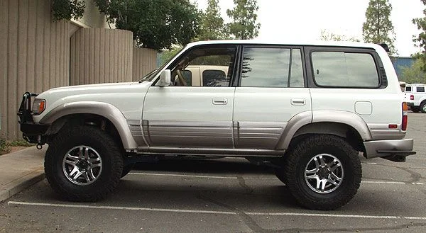

I have 7.5x17" Tundra's on mine, with smaller tires they would fit without issue, no spacers, etc needed.

Yup!! Kevin's truck is HANDSOME with the 37's and Tundra wheels. It has a nice stance with the lift and tall tires. I still have heart patter when I see a white 80.
