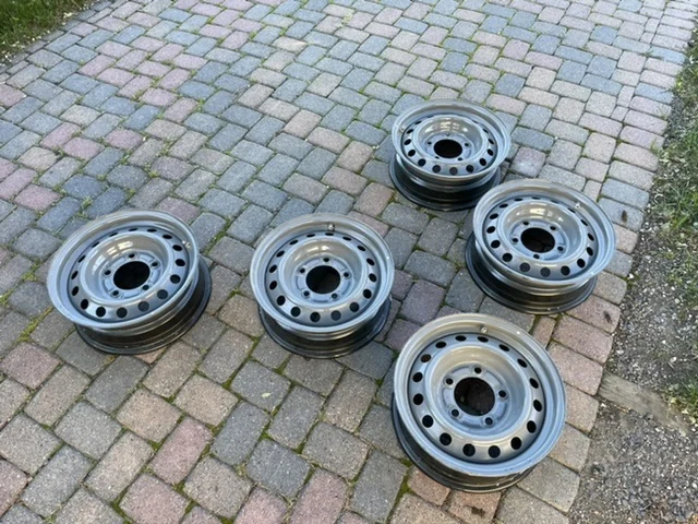

I prefer the Jaos Victron Tribe wheels but you will cry a little harder! I see the OE 16 5x150 steel wheels in the classifieds here and there. Search for LC79 body importers... they often have the wheels too.

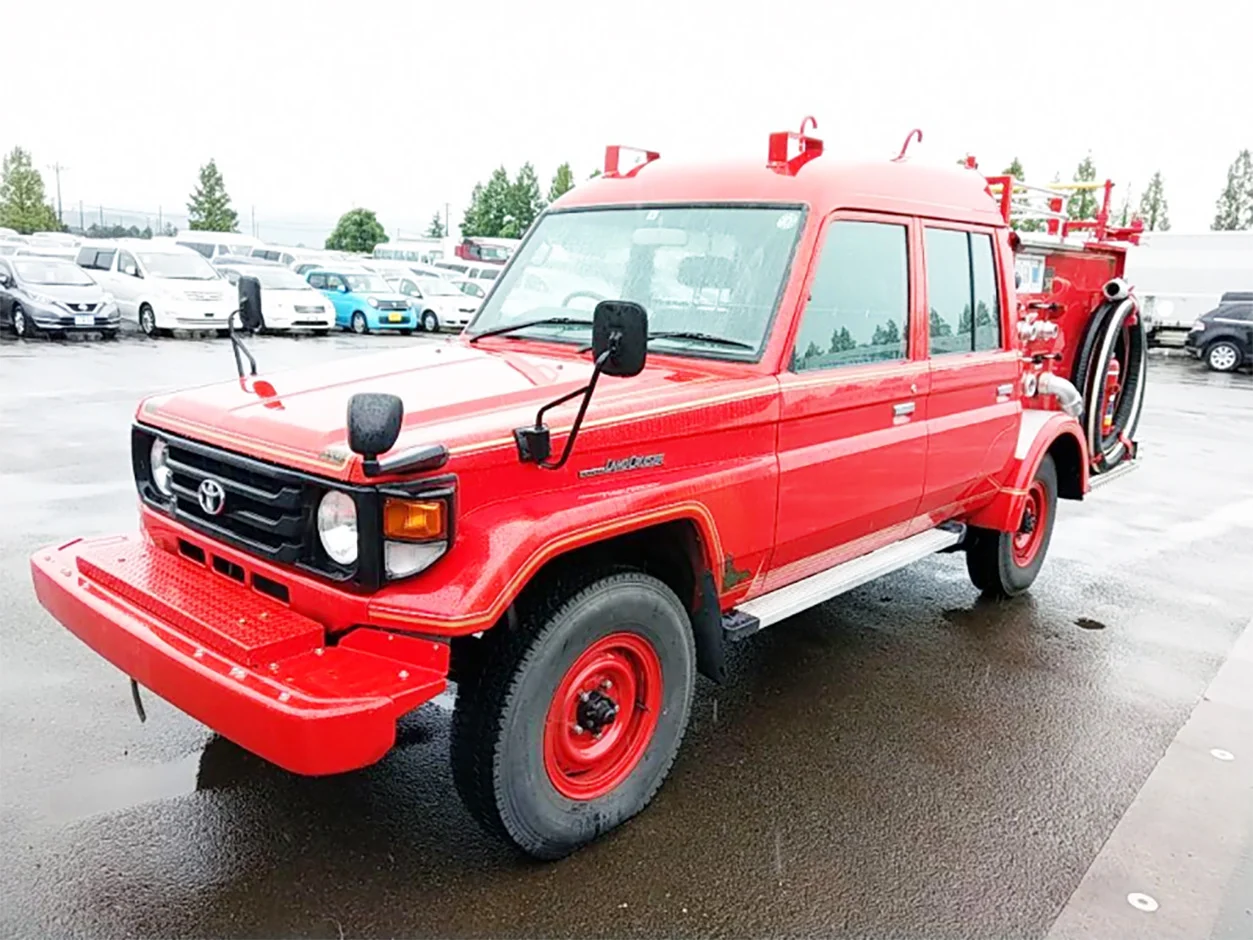

It is a 2001 HZJ79 Duel cab - Ex fire from Japan. Not many made. I’ve been watching auctions for 7 months waiting. Will be a bit of a project!

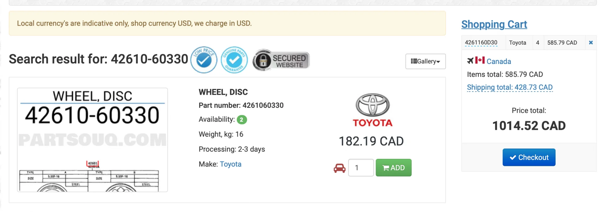

@janyyc Thanks! I am okay with them being unpainted as ill likely powdercoat. Hard to unsee those Jaos Tribe Victrons though. Those are the 42610-60330 (not splits)? Priced out with shipping to my door the OEM will run about 1200$.
I believe this would be either:
42611-60D20
Or
42611-60D30
Was never able to make out a difference between the two!
I think there are already a bunch of these in the US and most of them are for sale , does the vin says hzj79 ? It always looked more to me that Toyota used 77 series to start these builds . Going to ditch that high roof and put a regular roof on it ? A few folks already have done that using a new 79 roof on it.
What you are seeing in the US is the HZJ75 version of the double cab not the HZJ79.
My vin most definitely says HZJ79 --
The HZJ79 were built and offered from 99-2004. Major changes from the 75 to the 79 are: coil springs in the front +live front axle, longer rear leaf springs, 5 bolt wheels instead of 6, redesigned steering wheel, updated front indicators, grill, and more importantly a longer wheel base.
You'll notice on the HZJ75 that behind the rear passenger doors there is a cut away on the lower panel. The 79 has no cut away. That is the easy way to distinguish the two models.
As for the roof I am undecided. There seems to be a big push to convert the roof to the standard roof height. Will see when it arrives.
ill be sure to post more pictures and start a build thread. The difference will be pretty evident.
