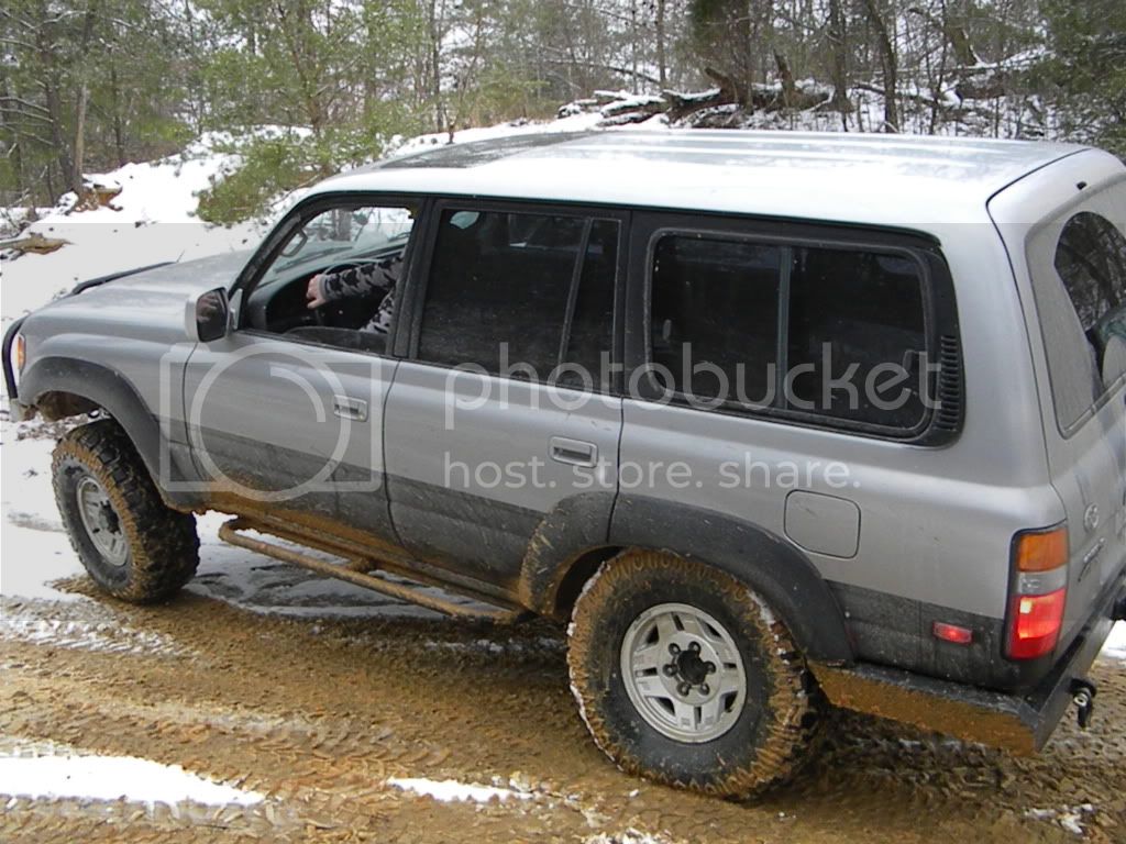

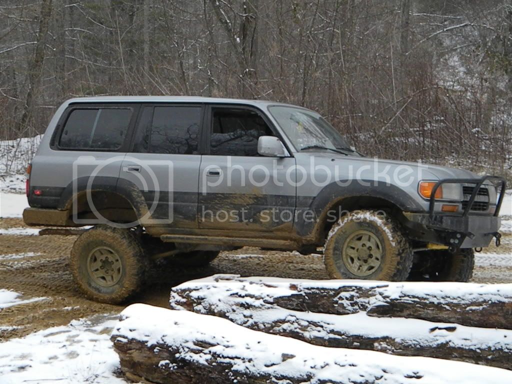

I did mine myself... It was super easy. I used the dupli-color stuff as it was cheap. Some pics below. Also x100 on getting some protection. Check out my passenger side door... yeah that happened right before the sliders were made.
Hey Joker,
Thanks for posting those pics. Looks like you got the same color LC I have. It gives me a good idea of what my truck will look like. Only difference is my flares will be gone. I like it.
