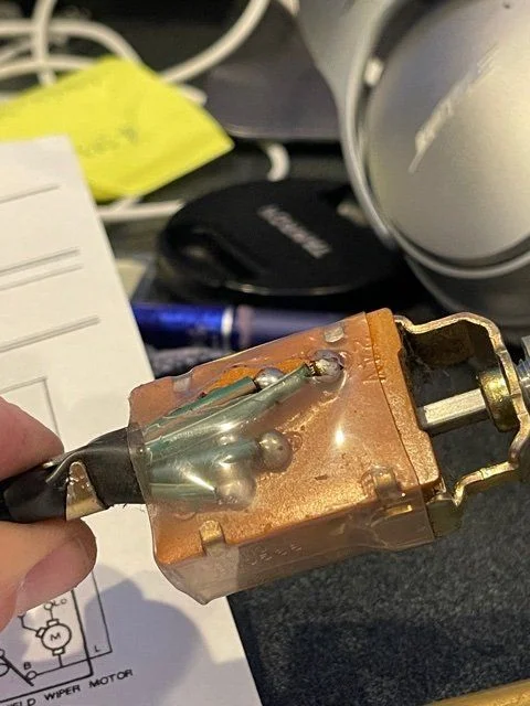

Right hand signal working fine, flasher relay, and grounds seem good but no left signal. Checking the FJ40 forum and the wiring diagram it looks like all turn signal goes through the hazard switch?
I pulled the switch and noticed the heat shrink sleeve on the housing is damaged. No scorching in the connector or burned fuses, just what appears to be a melted sleeve:
Toyota Matt has a rebuilt - NOS OEM Hazard Switch Assy. w/ KNOB & Pin wrench retainer Nut / Bolt 9/77-12/84 FJ40, FJ55 - VintageTEqParts.com which I am ok to buy but wanted to check to see if there were any other ideas for troubleshooting before I pull the trigger on that part?
