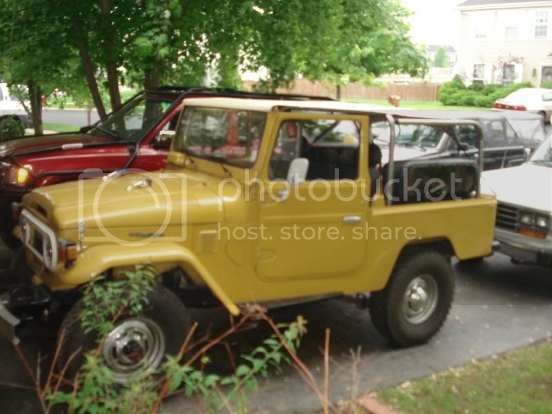

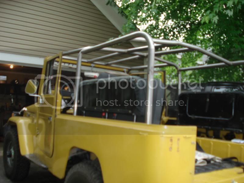

Well the cage is 1.75" HREW, bent on a jd2 model 3 bender with a 5.5 radius die. The structure is done, the welding and details are not. I think i have about 30hrs in it so far....

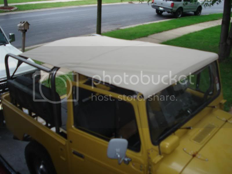

His goal with this cage is NOT to wheel (so you can relax he wont be wheeling this). But rather to mount an ARB roof rack (I will cross that bridge when I come to it!!!) and to support a SOR family bikini top. Which is intended for the 40, so I had to make some adjustments for the cage to work with that and not look like crap.
I originally was going to throw some flash into the cage but once I saw it and drove it, I started to lean toward a clean safari type cage. Then I started to mock some of the flashy tubes and I hated it. So this is what I came up with...

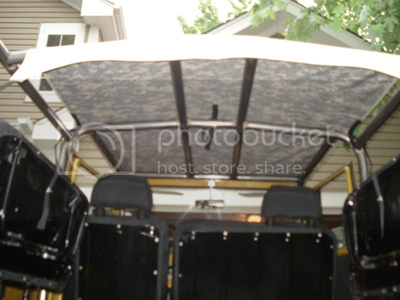

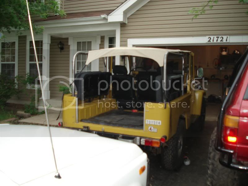

Here you can see how I ended the cage as early as estetically possible, and then could match the lateral roof bar to the fj40 bikini. I dont have any pics of the bikini but it fits like a glove! Also the Troop style jumper seats were a challenge due to the occupants head, but they are just right.

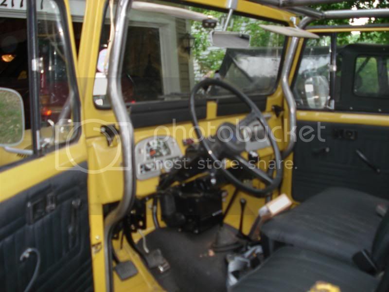

Here is a shot of the dash. It was VERY challenging due to the large knobs that secure the windshield. Oh and sorry Rod the knobs have to go. Ill fab up some low profile guys.
