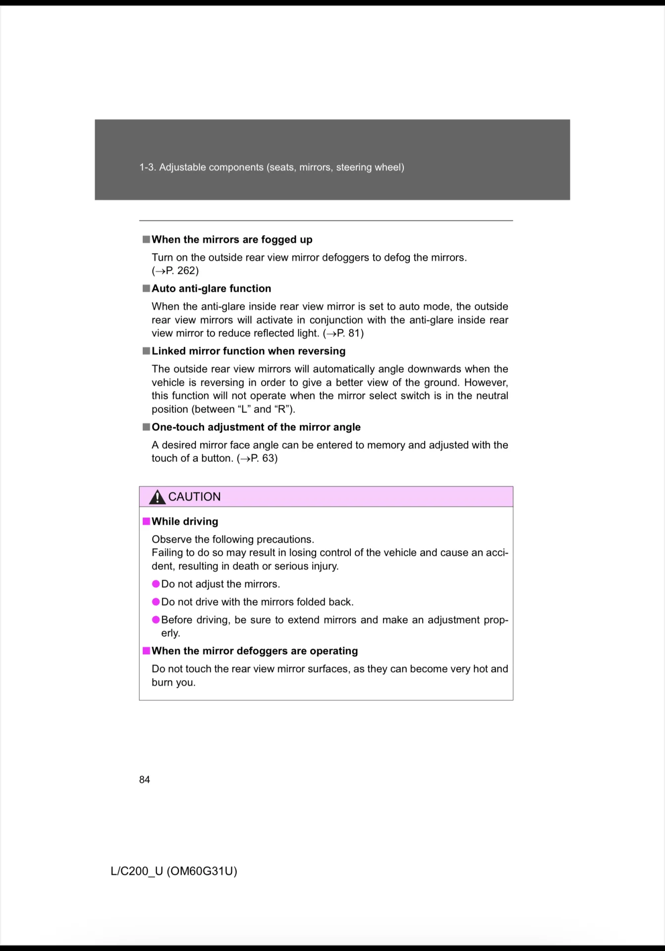

Not sure if it’s the same on a 2013, but on my 2010 you need to leave the adjust selector switch in either the right or left control position for the mirrors to tilt in reverse. If the selector switch is in the center they don’t tilt.
HOLY CRAP YOU SOLVED IT!!!!!!!!!! It was driving me nuts! I even searched the manual but didn’t even know what to search for! Thanks!!!!

My 08 LX570 just started doing the exact same thing within the last week. Functionally, everything about the mirror works - I can adjust them both manually, fold them, signal works - but they no longer angle down when going into reverse.
nevermind...just saw the info from the manual from Tommy's post. Thanks, Tommy!
