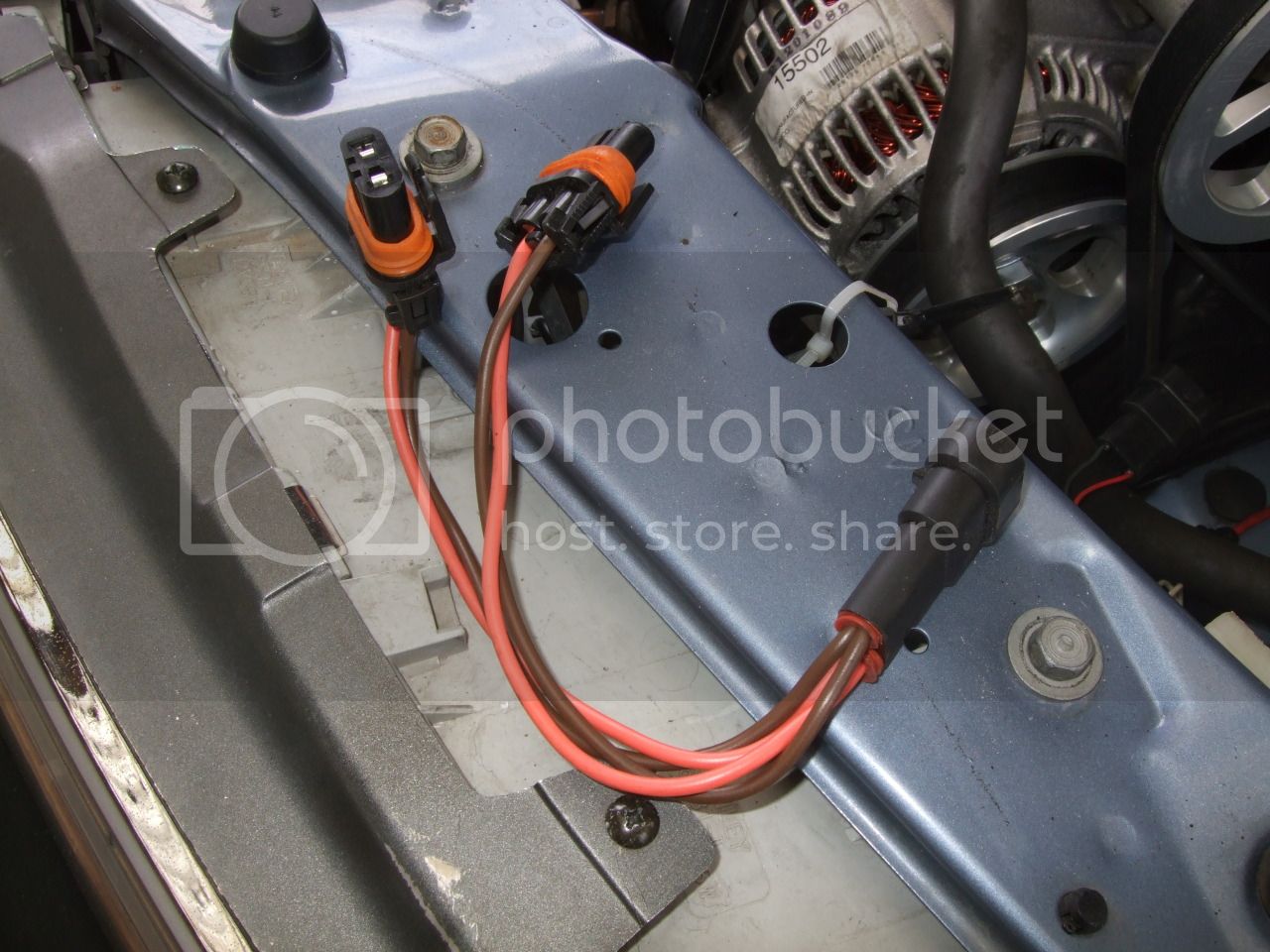

The "REV +" is going to the red/blue. I have tried removing the pins and was having trouble. I would solder in a Y-splitter so it's easy to disconnect. If you can find a 9006 male/female socket with the pins not installed that is going to be the easiest way. White and Black is the OEM ground. Look in the FSM, find the nearest ground point and see if you can find the white/black wire in there.
Picture for reference: 9006 Splitter. One goes to the camera, one goes back to the OEM reverse light.
Awesome, got it working. Thanks for the help and the ideas.
