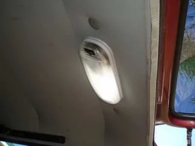

there should be three blanking plugs spaced evenly across the cargo area roof where your top saftey anchor will bolt in.
they are there for this reson alone.
After looking at photos of the rear roof in the cargo light threads I think only us Aussies get these, must be something to do with the ADRs.
pic of mine showing the anchorage points.

Do you mean they are not there?Even my milford cargo barrier had holes especially for the child seat belts.
I would bet the holes are under the roof lining , a bit like the hole and wiring for the rear cargo area light.:beer: :cheers:
