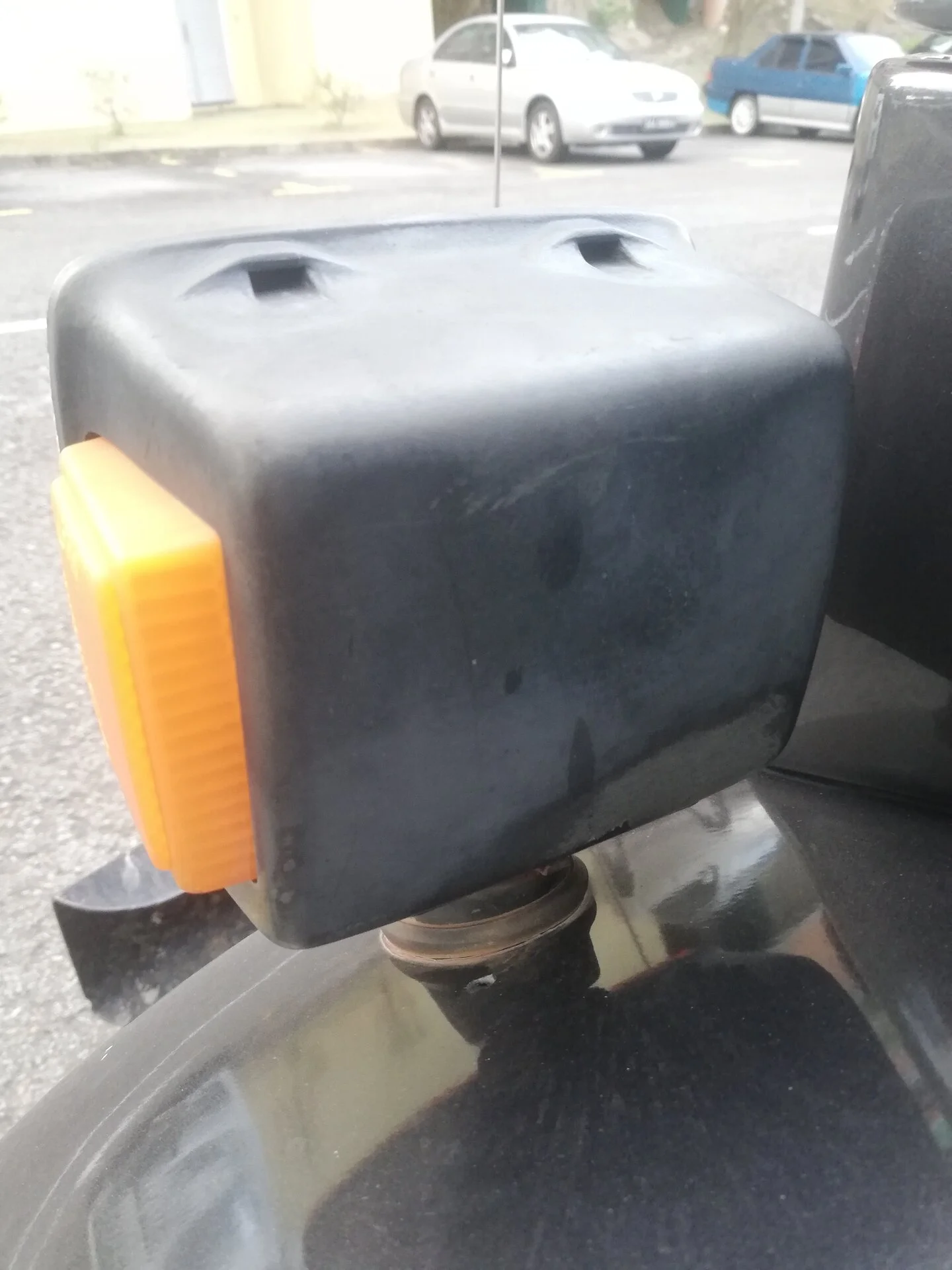

I used some 2000 grit wet/dry to sand off the oxidized bits, and then used some Ceracoat trim restorer. Will see how it stands up to uV once it spends some time outside. The Ceracoat seems to melt the plastic and then reforms into a hard layer.
