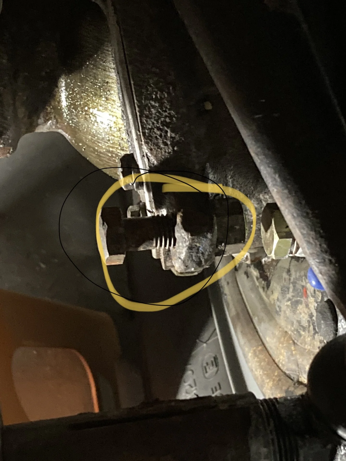

Can anyone tell me what this bolt is for ? Trying to get front end straight enough to go get alignment.
That's the stop bolt. You can adjust where the knuckle stops in both directions. Won't effect you going straight.
The only thing you can adjust is the shims on top and bottom of the knuckle wrt any camber, but it's nothing that is going to be way off and can't be adjusted unless you take the knuckle off. Usually you just put back on what you find, unless you want to use the centering tool. Behind your knuckle is a little wet and could be leaking so you may just have to do it soon in yours.
Are you having issues with your steering? I find it that lasers at shops do a much better job with alignment than my tape measuring ability.
Thank you , no problem with steering , but the tie rods needed replacing do I did them . I was trying to get it close . But thanks I did not know about the shims .
