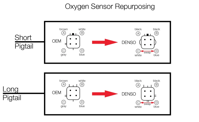

After going thru the EWD for both the 97 and 94 trucks it seems there was a path forward to convert the sensors. Again, my apologies for not having photos. Maybe someone else will add photos after doing this themselves. But simply put the only thing different between the sensors is the wire colors and connector. The physical sensor is the same for up vs down and right vs left. So all that needed to be done was figure out the wiring and swap the connector.
So one by one you remove the old 93-94 sensor, use VERY skinny terminal pin tool to remove the pins from the connector. You will NEED the connector. If your connector is melted or broken...my condolences. Now remove the connector on the new 95-97 sensor (with the pigtail length that matches best) and ALSO remove its connector. Re-pin according to the drawing below and then BE SURE to use the OLD connector on the NEW sensor. Rinse and repeat with the remaining sensor. After more than a month now and a few hundred miles, the truck is running awesome, picked up some increased mpg (don't expect a lot) and no more CEL.

:hmm: How about providing the harness side plug part numbers? Then folks can just swap them out and not worry about retaining the old plugs.

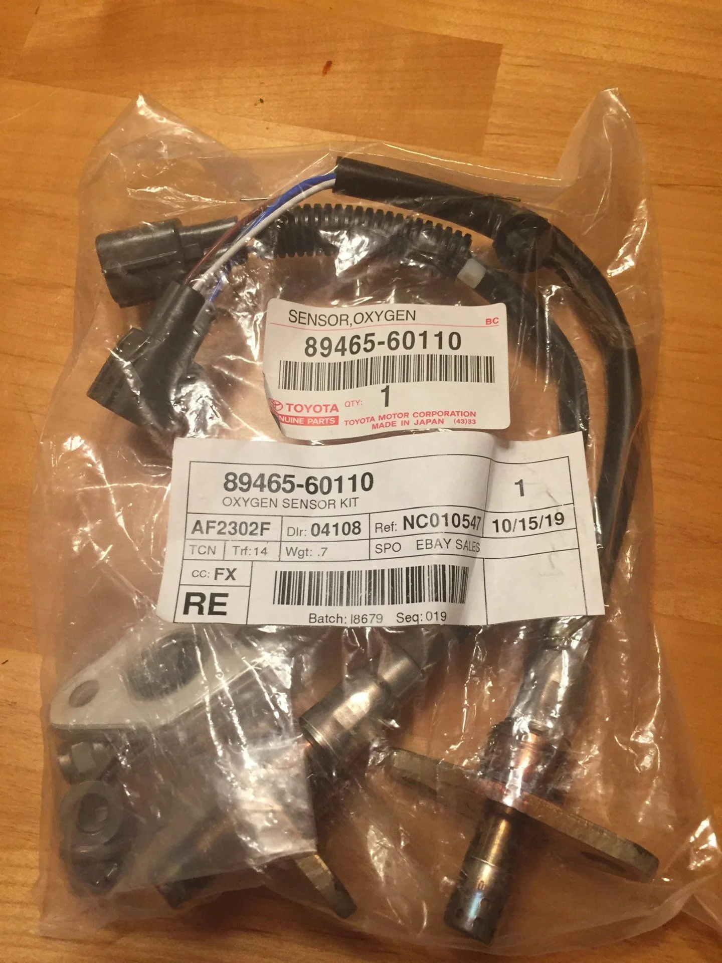

I may have got the last OEM set, as this came to my house on Friday. Still, pretty cool you figured out this mod to keep the 93-94 trucks happy!

Yes it does work. I ordered the OBD2 sensor from Wits End @NLXTACY and he gave me a link to/how to re-pin the newer O2 sensors using the original plugs.
