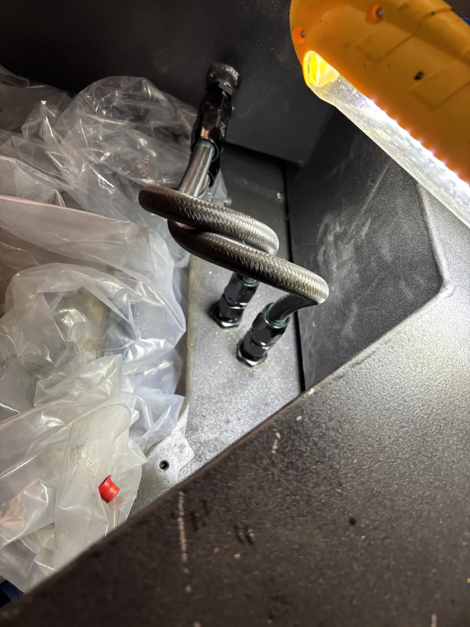

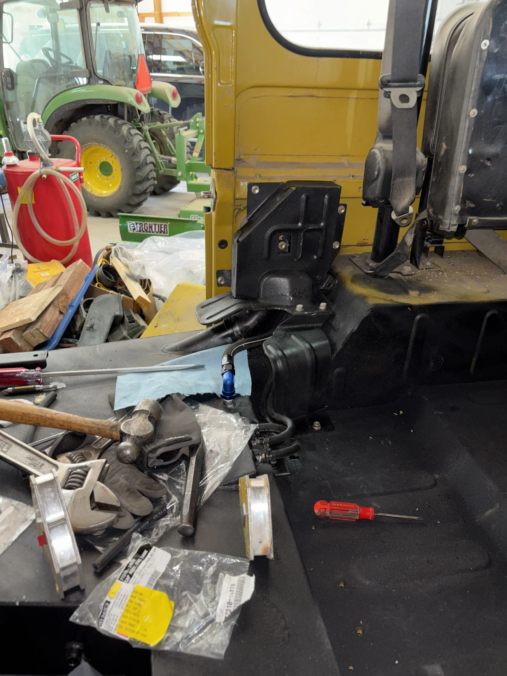

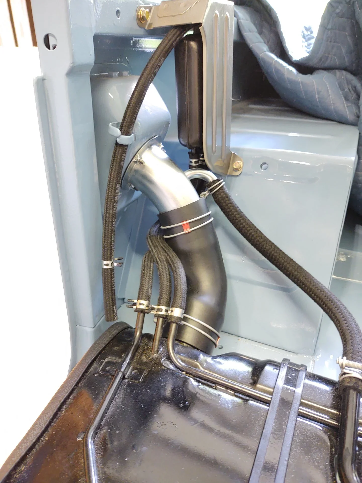

When I installed my new 29 gallon tank I used worm gear for the small hose and when ever possible I used AN fittings. The vent hose on the filler neck I had to split the end of the hose so it was slide on to the vent in the filler neck and used a HD clamp there but had to cut the end of the vent tube to get the -8 AN hose to slide onto the vent tube. Then used AN fittings on all the threaded bungs on the tank. For a stock tank you could use worm gear clamps. My new tank came with hose barb fittings and worm gear clamps, just measure the OD of the hose and get a clamp the appropriate size.
Some time back on Amoron or Ebay I bought an assortment of tab spring clamps. It was like 10 pieces each of 10 sizes for $10. Pinch open with pliers to R/R. I'm sure they are not rated for fuel injection pressure.

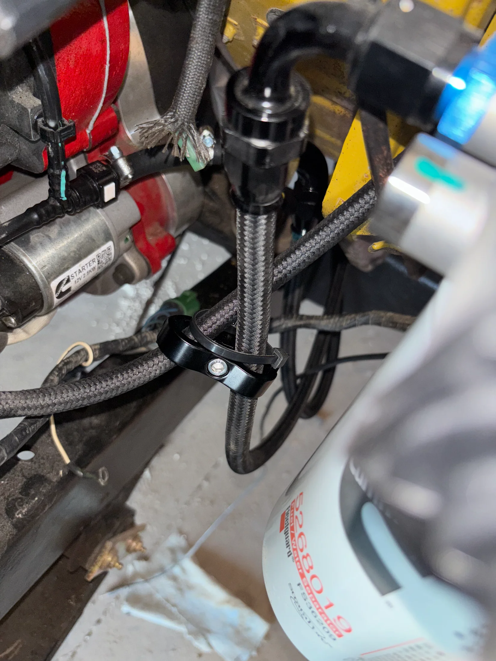

I don't think the pressures are that high for my system. I don't need a lift pump so it is just suction pressure that the injector pump generates and then return pressure after the leak off from the pump and injectors. The high pressure is from the pump to the common rail.
I got started on the AN fittings doing the PS so decided why not on the fuel system.
