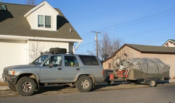

We moved back to Montana in January from Missouri. 1300 miles like this:
I wanted to build a roof basket before we left, but ran out of time. I didn't think my little ATV trailer was going to make it.

It's close to twins with my old (now sold) '90 Runner! IIRC in this pic it had Downy HD rear springs and torsion crank in the front. Later it had ball joint spacers in the front, IMHO a better setup. If I were building the same now, would go with OME coils.
Nice scenery. . .and the background is pretty too. :grinpimp: I sometimes wish mine looked more like that. I have paint issues and one of the POs hit a guardrail and messed up the front bumper and DS fenders a bit. I'd like to patch and paint, but probably won't ever get to it.
