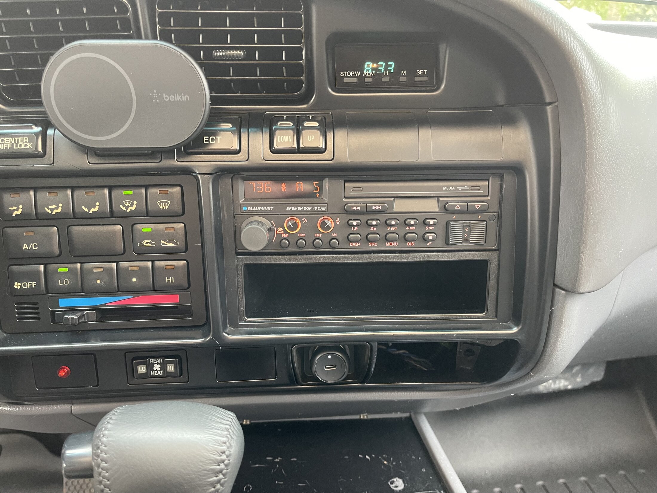

I know nothing about Land Cruisers, but my boyfriend has a 1993 Land Cruiser FZJ80 and was using Spotify's Car Thing until it recently got discontinued. I wanted to surprise him with a digital multimedia receiver for Christmas, but I'm not sure which one to get and what all I would need to get with it so I made an account to get some good advice without ruining the surprise.
I've been looking at the Crutchfield website for one, but the options are kind of overwhelming. He likes being able to see the music and playlists and switch them on the screen so I know that it should be a touchscreen, but I don't want to get him something he can't install for his specific car or something that won't work properly with his set up. I've uploaded what his dash looks like currently. Any advice or help is appreciated!

If you enter the 1993 cruiser info in the search crutchfield does a good job tellng you what fits. They also recommend a wiring harness for this install but I think you can reuse the one from the pioneer.
1. New Receiver
2. Wiring harness adapter (reuse the one on the pioneer)
3. Mounting brackets ( check if the new receiver comes with one but you maybe able to reuse the one on his pioneer)
4. Backup cam? They’re inexpensive on Amazon but makes the install more complicated. I really like the added safety.

If you get a standardized "double din" sized unit, it should fit in the original dash lurking without needing a trim kit.

Finding a "plug & play" wiring harness adapter will make install super easy, and as mentioned above, it's likely the stereo he has will have the same harness plug.
Lots of stereos use standardized plug format. There is a few types though.
