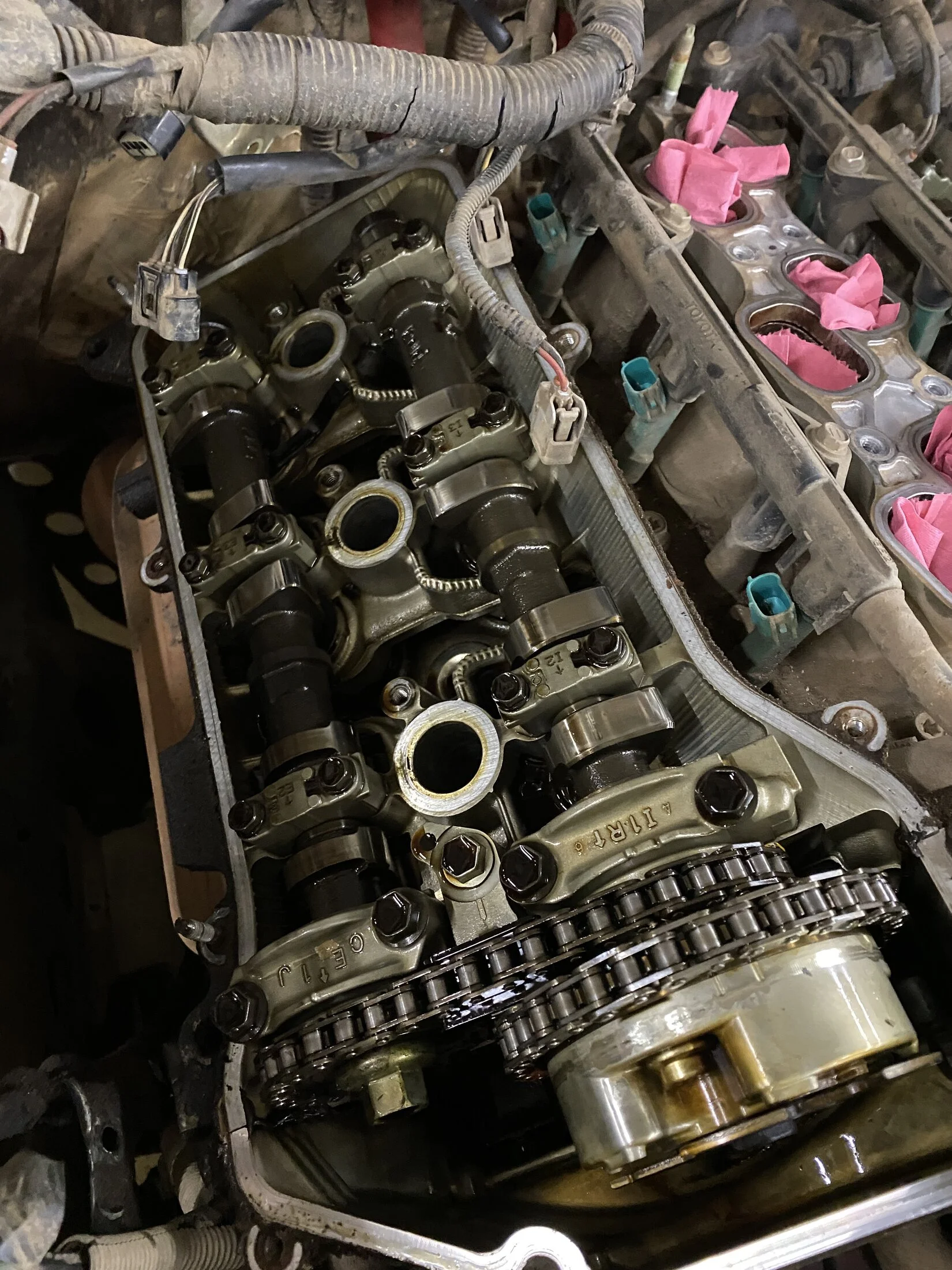

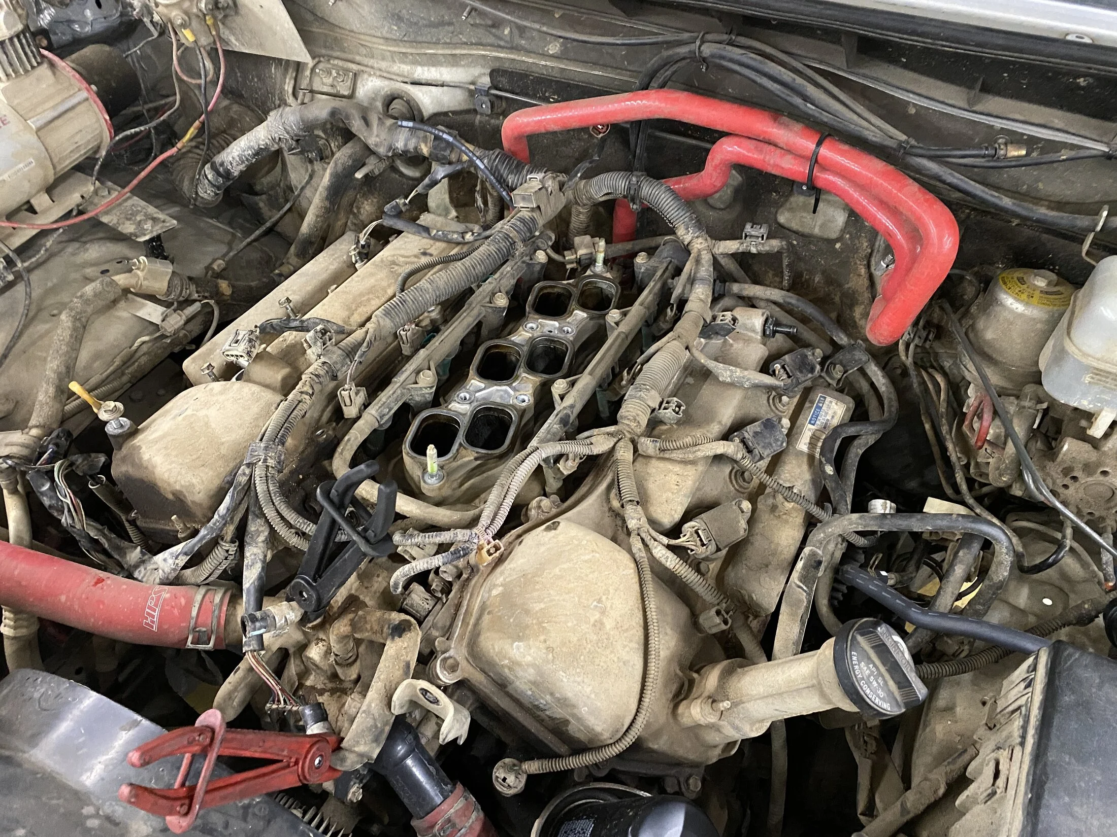

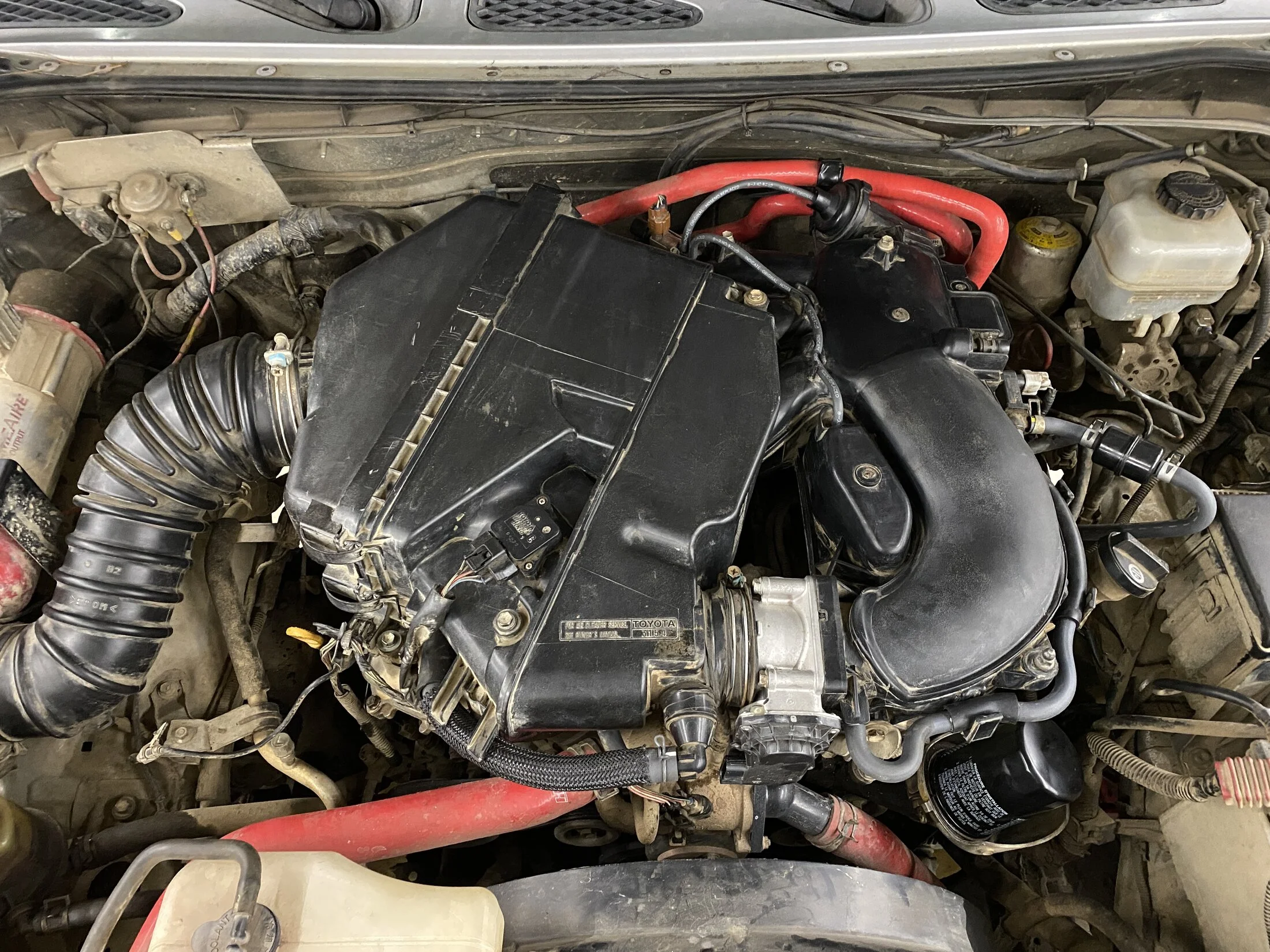

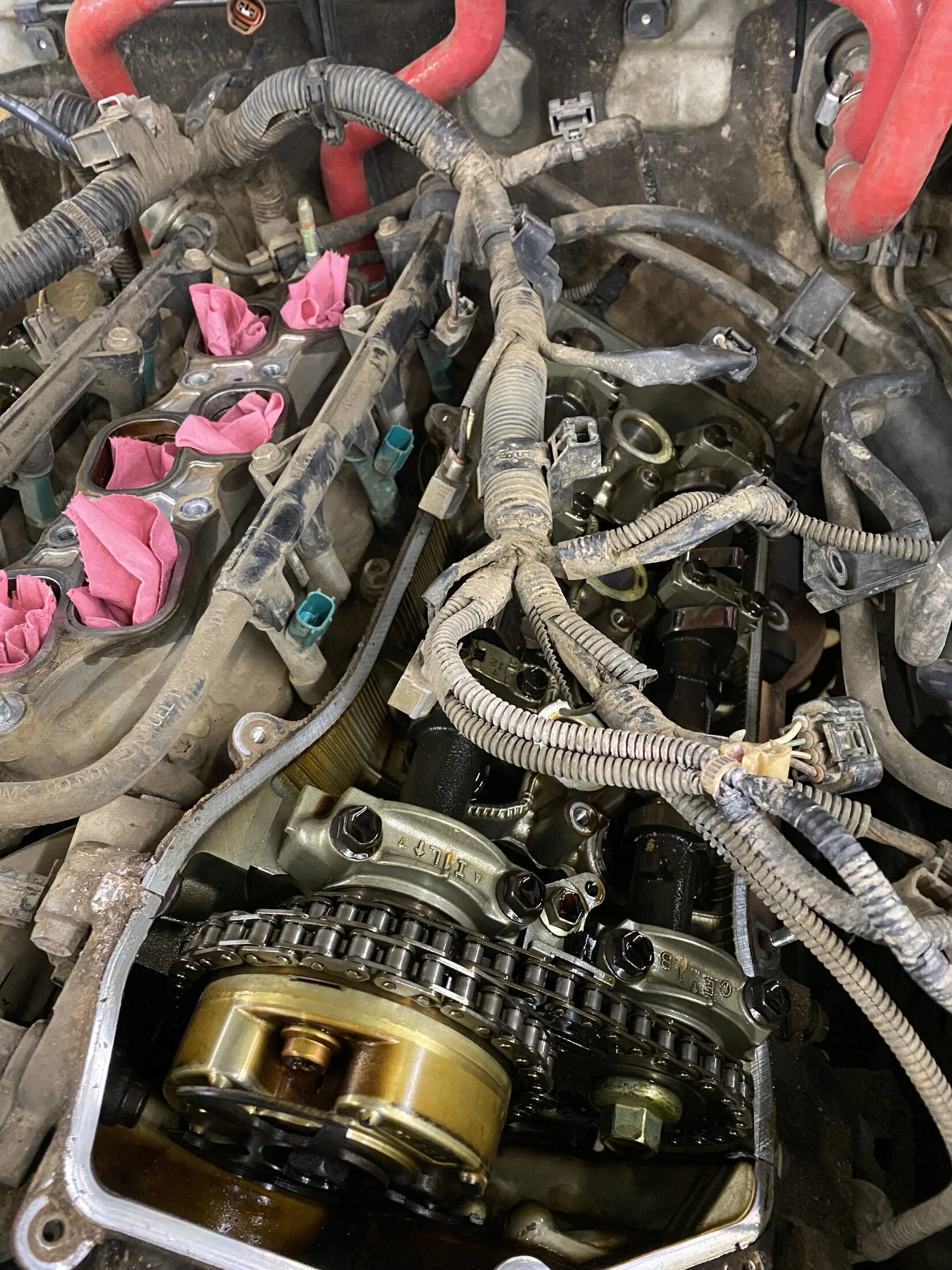

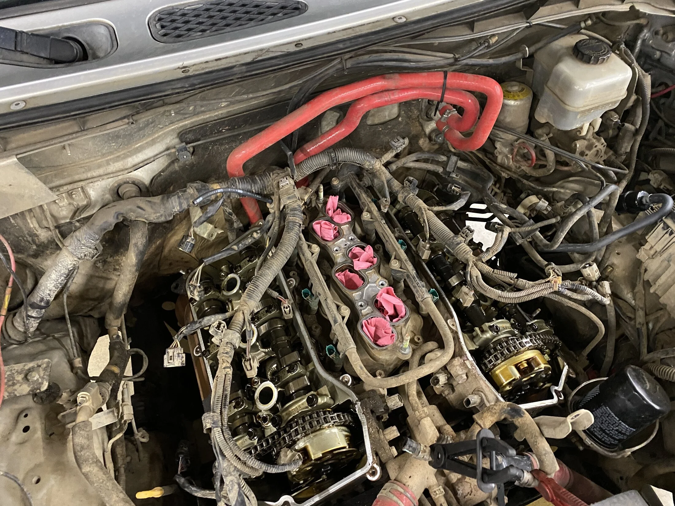

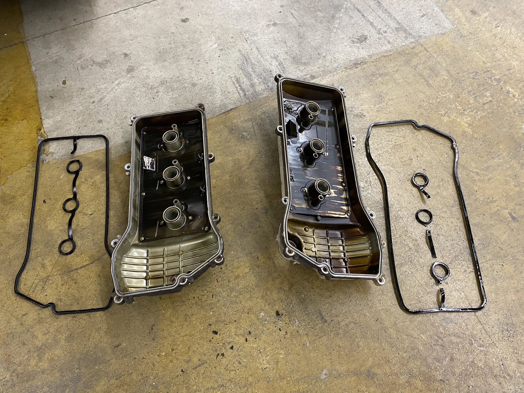

I've done this and it's not terribly difficult but there are a lot of steps including removing all of the air intake system, detaching the wiring harness that runs to each coil pack and little vacuum hoses and wiring harness clips. You just need to be careful and pay attention to things as you remove them - take lots of pictures that you can reference later as you put it back together. I would recommend cleaning the engine compartment as best you can before you get started. Then after you remove the air intake manifold clean some more before the valve covers come off. My wiring harnesses were caked in dust that was hard to keep out of the top end and you have to maneuver these wiring looms a lot to get the covers off. And the wiring loom material is now brittle and breaks easily - so be careful not to let pieces of plastic drop into the engine. Be sure to block off the intake ports on the top of the engine so that debris doesn't drop into them.

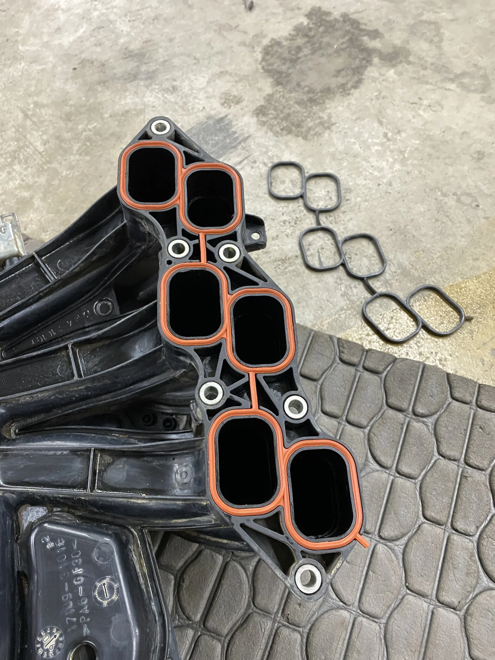

You'll want to grab some small coolant hose clamps to pinch off the lines that connect to the throttle body assembly. Picture #1 below. While you have the air intake off, you might as well replace the "6-pack" gasket too.

The most difficult part for me was the valve cover attachment at the fire wall on the driver side. I was able to prop it high enough to change the valve cover gasket without removing the cover.
