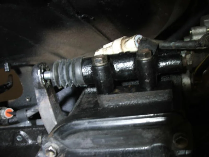

I am attempting to replace my clutch fluid because it looks black like coffee. However, for the life of me I cant seem to find the slave cylinder. Can anyone attach a picture for where the slave cylinder is on an 1985 FJ60?

Passenger side (LHD), on the side of the bell-housing.
attachment.php
There's a bleeder on the rear of the slave- It might be rusty, so spray it with some good penetrant and let it sit a bit, then crack it with a 10mm socket/wrench. A clear tube off the bleeder into a jar of fluid helps you see when the new fluid is thru.
