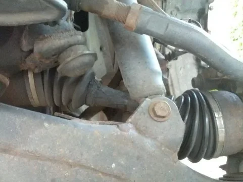

Got off to a great start when all but two of the lower plastic pan bolts sheared off! Need to go back and drill/tap them one day soon, so its running withour the pan for the moment. The CV boots were in remarkably good shape, although the inner looks like it had dumped some grease [shocker!] Tie rods were also good to go. No other surprises along the way either.

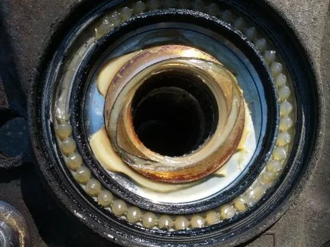

The spindle inner was spectacular. Took a while to figure out that the regular pattern of grease balls was probably the way the factory grease injector laid the grease in there, and it was still untouched [until I fat-fingered a little of it on removal]

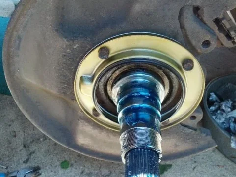

New axles in, new seals on, and ready for the hub to go back.
All done by mid afternoon. Truck runs smooth as silk.
