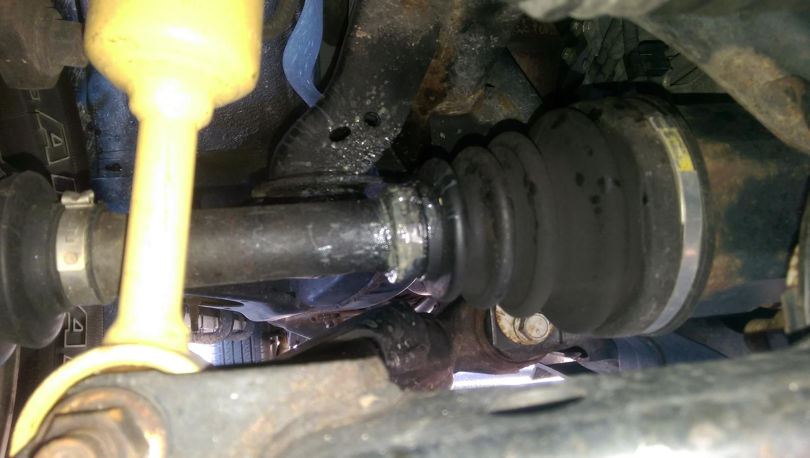

It is the narrow end of the boot that connects to the trans. I tried to apply more grease but it was too tight. I added a pipe clamp. Tighter now. Maybe they do not need replacing?

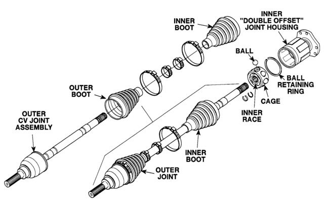

I could not get a great shot. Found an assembly drawing. It is the inner boot(not the Side that connects to the wheel). It is leaking out of the narrow end of the cone that wraps around the axel shaft.
It is not the boot that contains the CV joint.

Yup. Mine leaked at that exact same point.

This is what I came up with. I don't want to remove the boot from the large end and risk dirt contamination. I just want to replace the bands. I plan to feed the tube from the syringe back to the CV joint and load her up! Then squish the boot around before reclamping the small diameter side to move the grease.
I will then go do some Sharp turns and flexes in a parking lot.
This will happen Sunday and I will report my results.
CRC CV grease
Syringe with tube
Sounds good to me. I would think if you unclamped the failed clamp and squirted grease in between the cv shaft and the boot that you would be in A-ok shape to re clamp.
