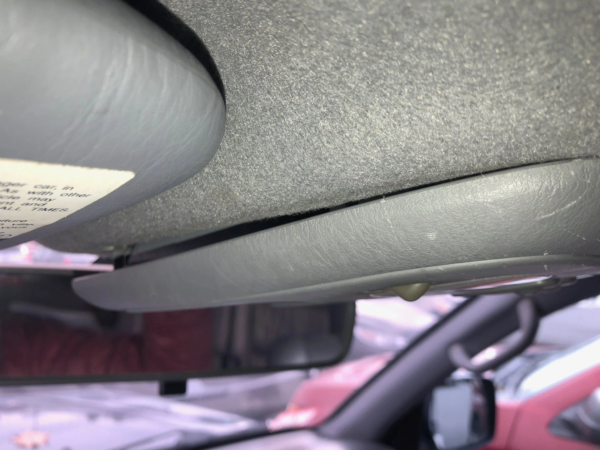

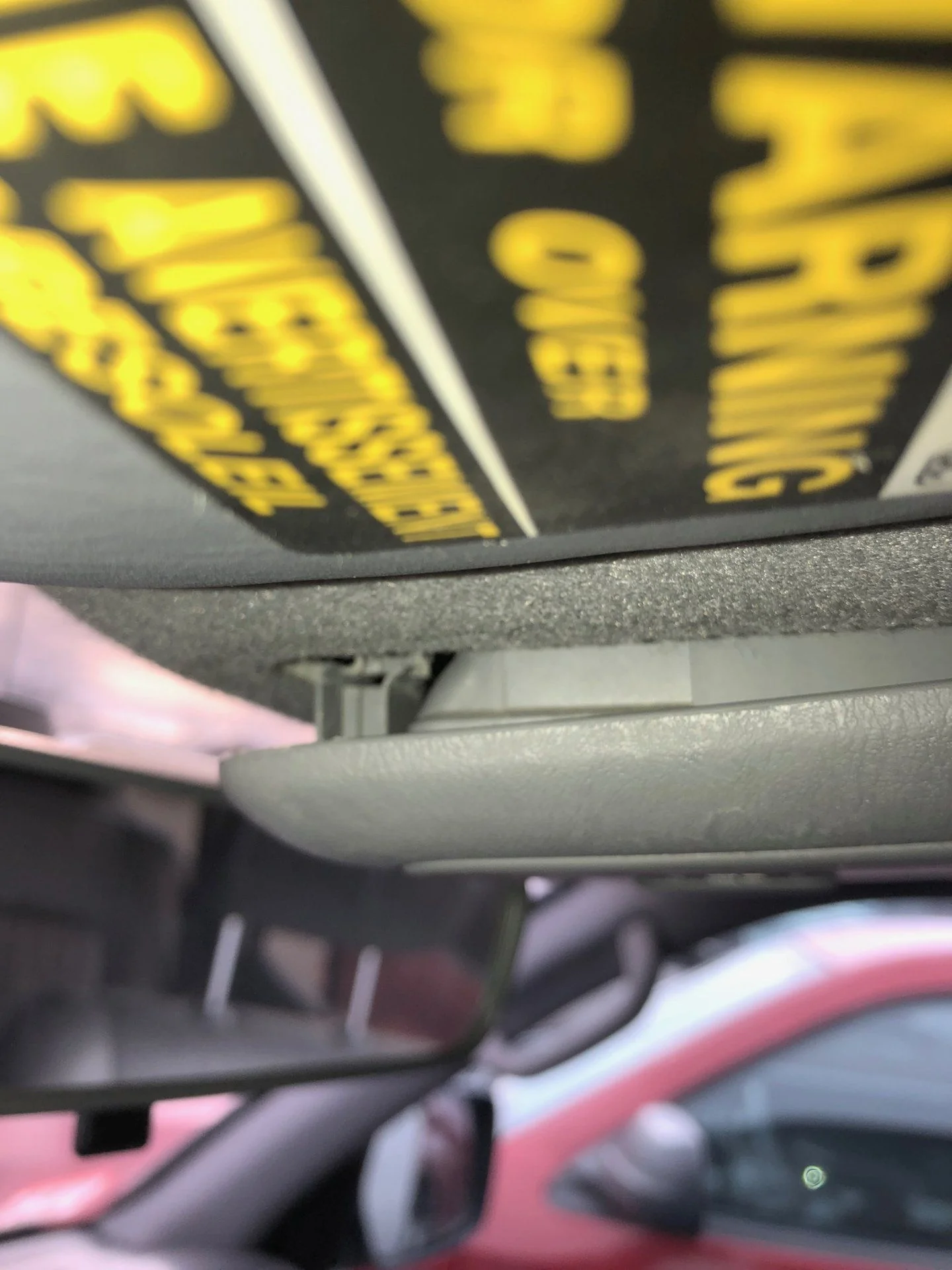

My overhead console is not properly secured to the top of my rig (see photos). Seems like the clips nearest the windshield are likely broken--if I push it flush, the console will flop back down immediately. The sunglasses compartment also seems to be stuck closed. (could be the PO damaged the whole thing during a struggle to open the sunglasses cover)
Hasn't bothered me much until I got the notion to mount a ScanGauge in the sunglasses cubby... any ideas on how to fix what I have? Or how to pop that sunglasses lid? Or leads on a new console?
@BlueMica Is this an LC or LX? The four plastic tabs that secure the console also have metal clips that actually provide the holding. The metal clips can come off when removing the console, perhaps they came off and were not re-installed before the console was pushed back up.

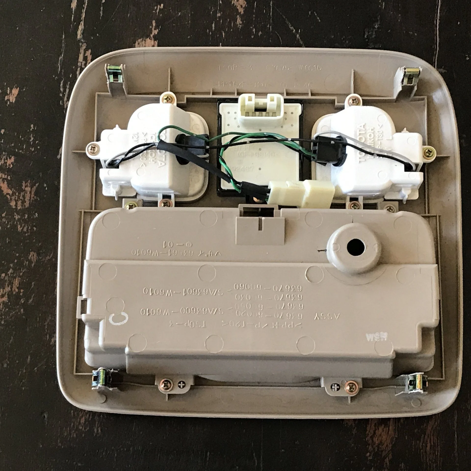

Does your “sunglasses holder” have a rectangular cover in the center of it? If it does then it’s actually a garage door opener holder which does swing open when pryed open from the rear edge. Inside you’ll see one Phillips screw securing the console to the roof. Remove that screw and you can then pull down the console, releasing the four plastic/metal clips. If the plastic tabs are intact, but without their metal clips, feel around inside the headliner and you may find a lost clip or two. Here’s how it looks from above:

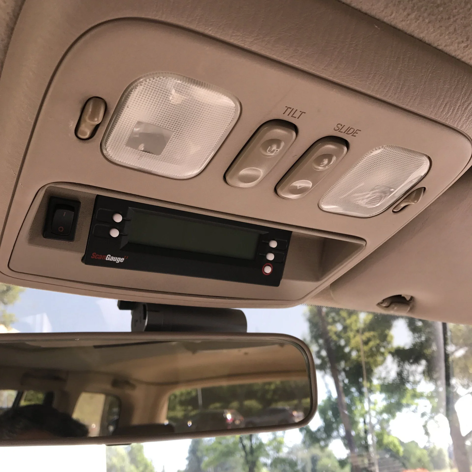

Also, I have a 3D printed ScanGauge mount specifically designed to replace the LC’s cubby. If you’re interested send me a PM.

Make sure your overhead is the one with the 'sunglass holder' if you plan to use @Ayune's scanguage mount. It will not work with an overhead that has the garage door opener.
