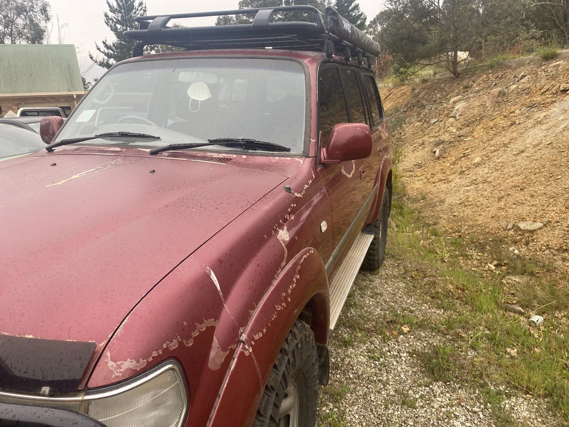

I have a 1991 80 series Landcruiser (Sahara model) that desperately needs some paint work as nearly every panel has clear coat peeling and paint fading.

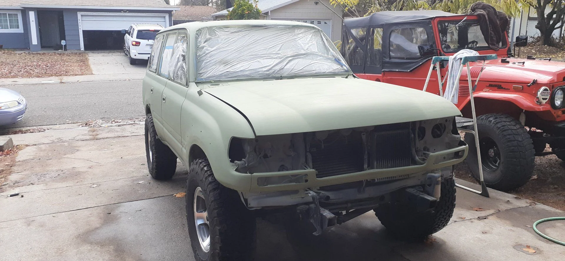

Why not paint it at home? You can buy single stage paints from aftermarket auto parts places like Summit Racing or JEGS (not sure what you all have down in AU like that). They are inexpensive and easy to reapply. If you scratch it up too bad just paint it again. You can probably find a color close enough to the factory.

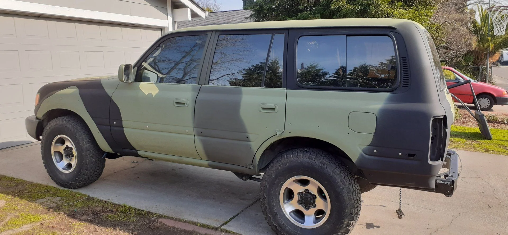

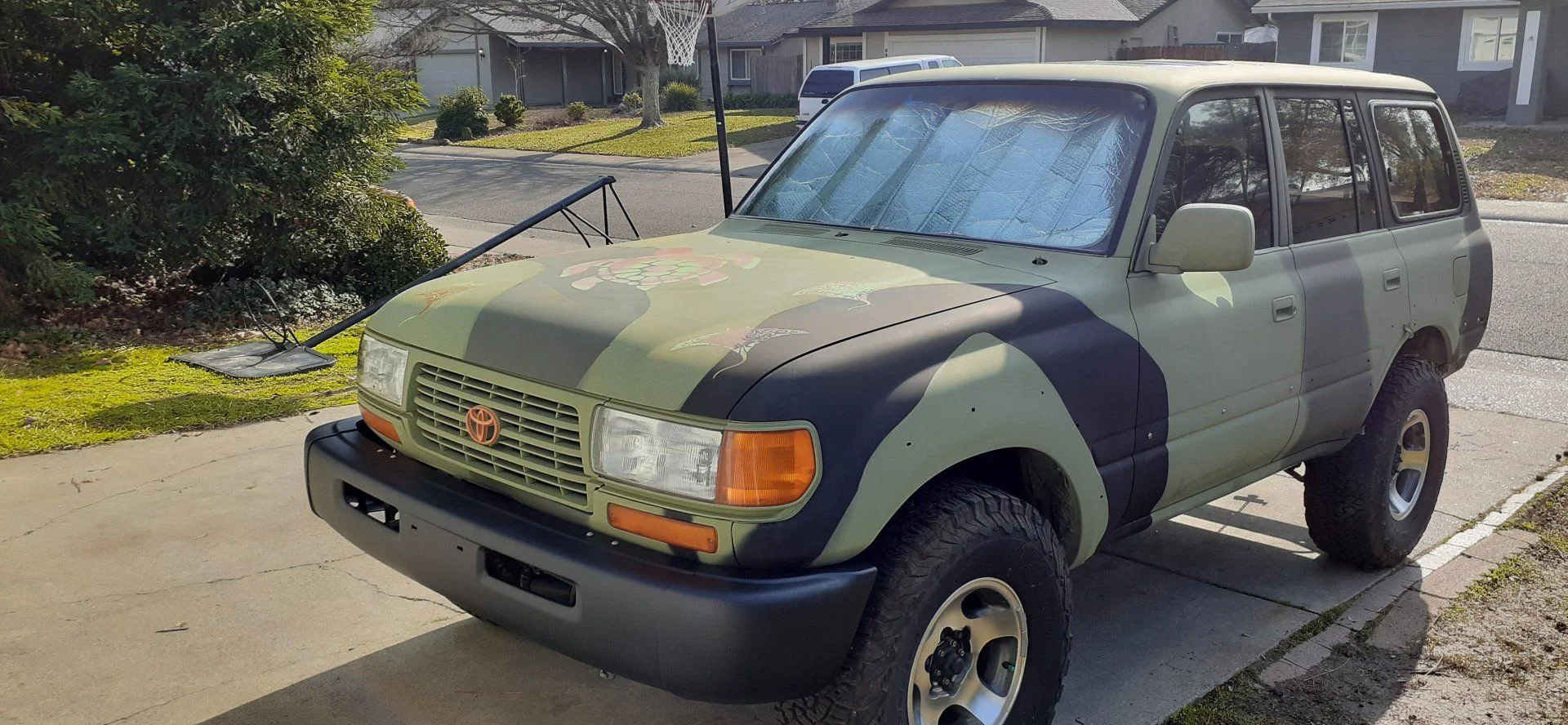

I wanted raptor line my 80 but once you bedline you can't go back. I sanded off my clear coat and went the rustoleum rattle can ultra flat route. If I ever decide to sell it the next owner can paint it any color they want. Very easy to go back to the original antique sage paint. Rattle can turned out great with LOTS of prep work. I don't worry about scratches. Its easily fixable. I sandblasted my 1971 FJ40 to bare metal before painting it 16 years ago. I tried a different approach with my 80. My K.I.S.S approach. Just have fun with it.

This guy did a bang up job on his own.

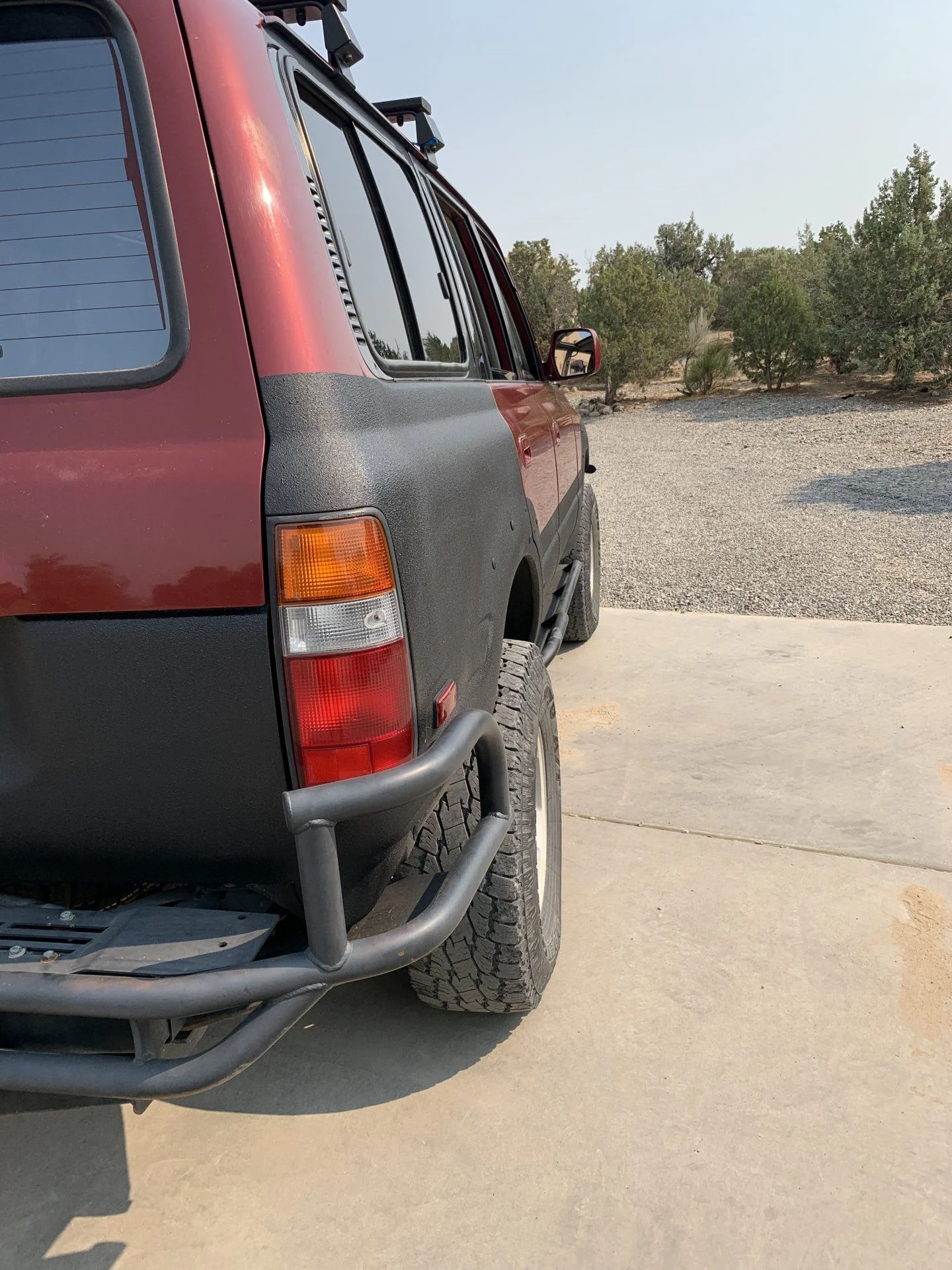

I raptor lined mine and love it! Still gotta do the top and an
Wonder which color. I like the red but May do sand. I do a lot of driving by piñon and juniper trees (tore my antenna out...ugh) and the raptor liner has held up great. If I was just running trails without scratching I’d probably would have kept it regular.

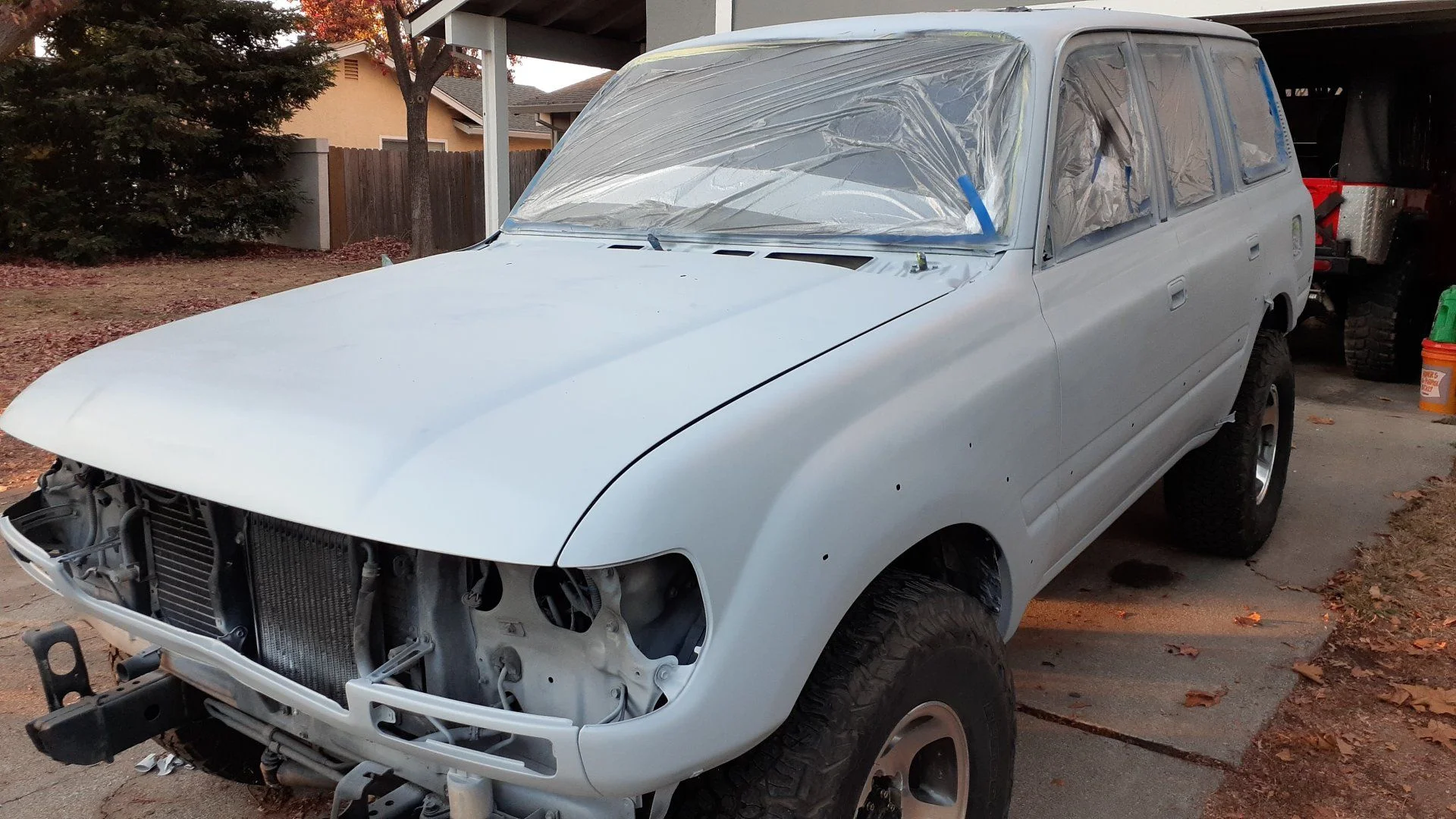

If you want to spend several hundred in paint guns, filters, and a good compressor (if you don't already have one) then definitely give it a try painting yourself. Prep work is the most important. Getting it slick before priming takes time but well worth the effort. Practice on some scrap metal to dial in the guns first and see how you should sand/polish it. Even if it only lasts 5 years you've saved yourself a ton of money upfront. I just painted a replacement liftgate that turned out pretty good for the first thing I've painting with HVLP guns.
