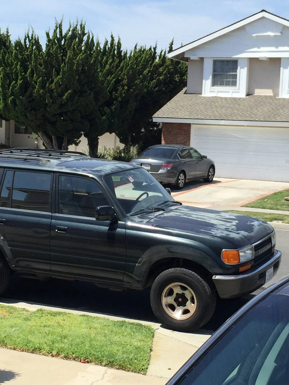

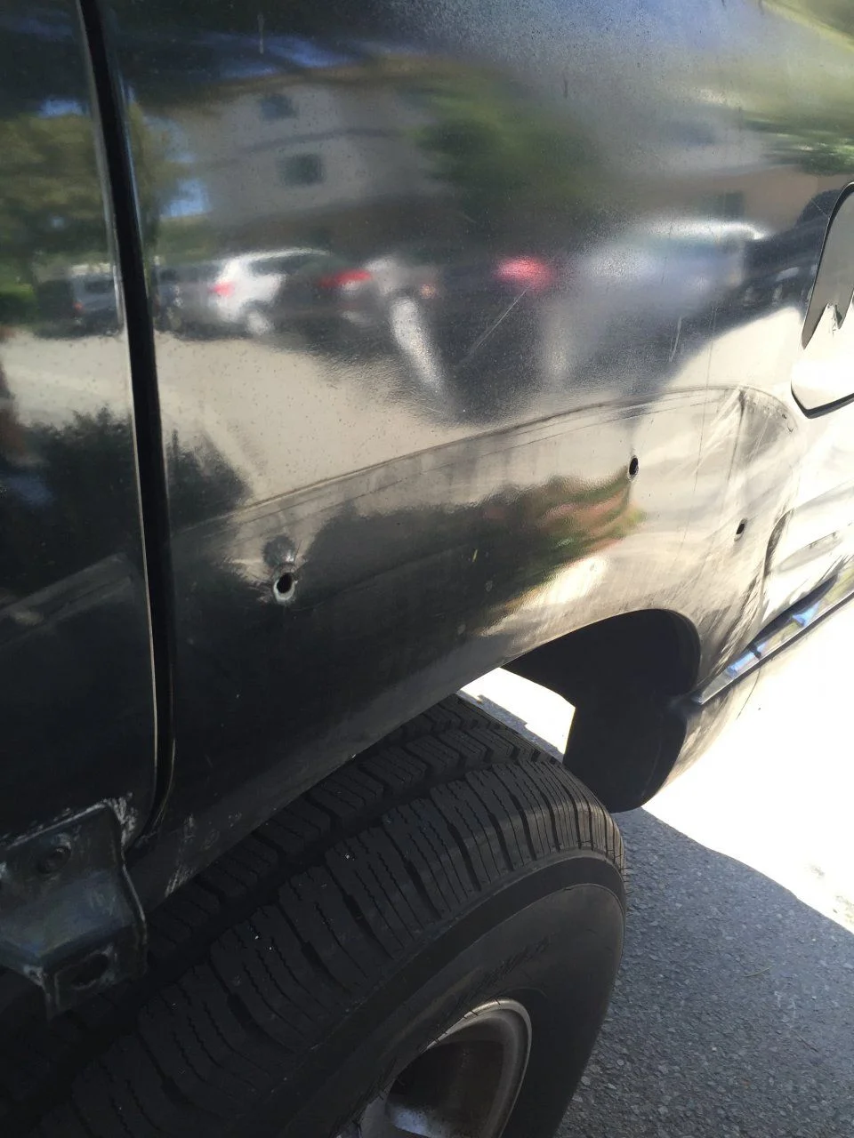

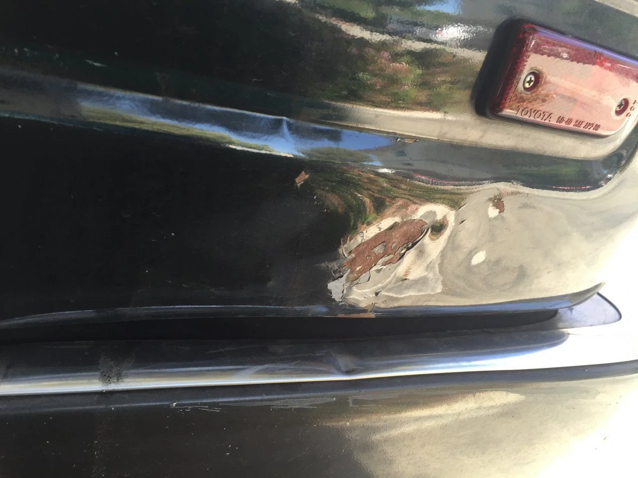

Hi everyone
I have a 1994 80 series in Emerald green who's paint is in pretty bad shape from sun damage, especially on the hood and top. It's flaking off and has hit bare metal in some spots. I knew I would have to paint it when I bought it and the time has come. Also the flares have been removed but not in the nicest manner so the areas surrounding the holes need to be smoothed out. There are also some dents and other minor areas where work needs to be done and I also plan on pulling off the roof rack so those holes will need to be welded as well.
My overall budget for paint and body work is in the 1000 - 1500 range. I'm planning on keeping the same Emerald Green to make the amount of work a bit less intensive. I'm willing to do as much of the prep work (i.e. Sanding and cleaning etc) myself to keep the cost down but have never done any paint or body work myself so I am seeking some advice.
If you know of any local shops in Orange County, the South Bay, or surrounding areas in Southern California or have any general advice that you think could help me out it will be much appreciated.

Unless you cut some kind of barter deal or volunteer to be a school project guinea pig or have friends who paint (and maybe not even then), you're not going to get a decent job that LASTS near that price. Some good paints go for $750 a gallon, so you see the problem. Pro spray guns like SATA / Iwata (the dominant brands) also run $500 to a grand or so, with more than one used on each pro job (some are better for primer, or paint, or clearcoat). Big compressor to keep going, dry air, wall-mounted regulator, etc. all tools of the trade.
That said, there's a thread on here somewhere about a guy who did his own Cruiser. Not sure how far back, or what paint / spray gun he used, or how it's holding up now.
As to the dents, google "paintless dent repair" or "paintless dent removal" + your area, and also ask some good used car sellers or custom shops who they use. Some of those guys are stellar. They may also plug holes.

I was thinking of taking off the CC where it's failing, then shooting it with a can or two of Spraymax 2K clear. I have no idea how this will look but it cant be much worse. If it is then I'll just still have to paint the hood like I do now.
Maaco with no body prep other than a light sanding, ~$1000 and they will paint over the fender flare and door handle gaskets, but won't fix any holes, dents, rust for that price, all that is extra. A good job at a independent shop in my area doing minimal body repairs (door dings) using mid range paint materials; $4000-5000. A high end job where they remove doors, hatch, lift gate, roof rack, hood, do some body work (say a minor dent in a quarter panel), fix some roof rack/hatch/fender flare holes and rust, $8500-11,000. These are the estimates I've gotten.
I experimented doing this on my old LX450 (metallic green) - I used the edge of a razor to scrape the dead clearcoat & it came up great, got to an edge I just feathered down & shot clearcoat litterally from a bombcan of Rustolium / Krylon - nothing special.
It made it look an honest 8 on a 10 scale - you only saw the hood, but murphy's law the roof spots looked better. You still couldn't tell with a coat of dust or pollen unless I pointed it out to you.
