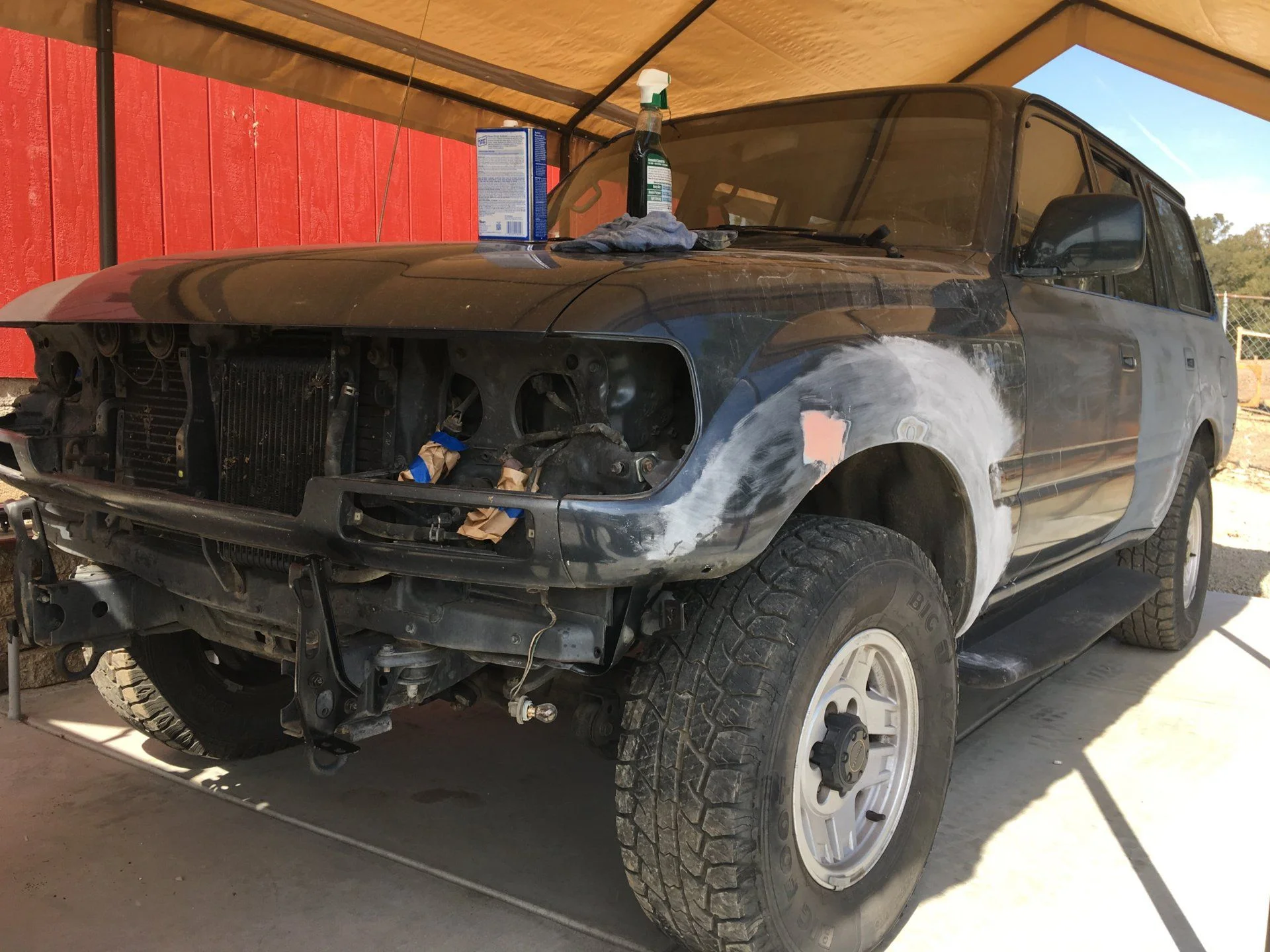

Doing some initial prepping for paint on the 80 series this last weekend. This is my first time doing body/paint work on a vehicle.
Wanted to get some guidance on removing/filling the small stuff, such as paint scratches, basically where the metal is fine, but there are imperfections. For instance, my rig has a line where the fender flares meet the body (pictured below--I am going flares off). I was sanding it down with 150 and I am just not sure if that is the best way to go in knocking down the raised old paint/clearcoat. Then, on the filling/smoothing side what are you guys using on the small stuff? Should I use a filler, or just prime it with multiple coats and then block sand it?
Think it really depends on how much you can "feel" the line once you have prepped the area. I am going through this adventure as well with my 60 (replacing rusty metal though) and my first thought would be if you cannot really feel the line, then a good primer/surfacer (aka high fill/build primer) should take care of those lines with a couple coats. That is as long as you let the coats flash properly.
If they are deeper lines, then you really have two options;
1. take the areas down to where you no longer feel the line, or
2. take the lines down to where they are close and then do a skim coat of filler.
Alright thanks that really helps. Ya, it is very noticeable by feel. I also looked into the 3m product for filling scratches so I may experiment with that to save time on sanding.
What are you using to sand? After my experience last night, if you have a compressor I would highly recommend a DA sander to knock all that down quickly.
I am just sanding by hand with a block. I do have a small compressor, but no sander for it. I have an orbital. I am hesitant to bust out a power sander on it because the flare lines are really a minor imperfection. If I start cutting away a lot of old paint or even primer all around the fenders that is going to make for a lot more work in layering in multiple coats of sandable primer, and smoothing the whole thing out again. Right?
My plan is to knock down the ridges by hand, and then fill the lines with a scratch filler. Reviewers online say if fillers are applied correctly they last a long time. thoughts?

So I have made some progress in the prep department, and am getting close to paint. I am still unsure of whether or not to prime the whole thing, or just rattle can over the fender flare work. I have silver dollar sized bare metal in a few spots, and a couple of small patches of bondo (< 3" diameter). The existing paint is not cracking or flaking off. The body shop said I could "probably" just paint over the old stuff, and sounds like if the paint is not peeling/flaking etc it is ok to paint over. So my plan is to apply self etching primer over the metal, then regular primer over those spots, then prep more and paint. Thoughts? thx
Sounds like a good plan to me. That entire quarter panel that I did, I used maybe 1/3 of a 20oz hvlp cup once I had mixed everything and had thrown down 3 1/2 coats. I say 3 1/2 because I read you are supposed to throw a light coat of the primer over the sections that were bare primered and/or bondod, THEN do a full coat over the panel when doing paint. So I applied the same principle to the bondod areas and covered the "new" areas first, let that flash then did the entire panel. This all took me about 45ish minutes, allowing each coat to flash enough that it was no longer glossy or tacky. Not sure how proper that is but looks fine to me now. There was a lot more work done to my passenger side as a whole so I am figuring that is where the majority of my primer will be used.
