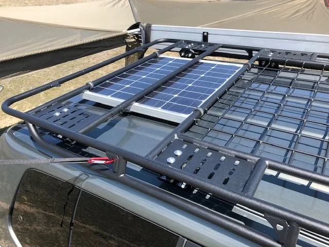

Hey Guys
My first post here, so might be missing some information. I picked up a Gamiviti roof rack awhile back, and decided to install solar panels underneath, to keep the top free for my thule box and other things. Heres' the build. It took more time than needed, since I had to pick up various pieces here and there to see what will fit. My fridge is connected to my goal zero lithium 400 via 12v DC, and my solar is connected to Goal zero for charging when car is off.
The gap between my rack and my roof was approximately 2" . The assembled sliders with solar panel and mount is approximtely 1.75". Leaving me about 1/8th of an inch between mount assembly and roof.

For pics you can see :
Does the panel have the ability to slide out from underneath the roof rack when needed? If not, I would be worried about the roof rack covering up portions of the panel. Even a small bit of a panel hidden from the sun effects its ability to operate optimally.
Your write up and list is very well done!!!
If you find yourself wanting from the goal zero try a humless 1500 its a beast
Nice job! I've done this twice now.. have thought about making it slide out but with 100w of panels the solar has no problem keeping up with a fridge in the hot sun, I would often leave the fridge on while at work in the summer and come outside to 100 deg truck, a 29 deg fridge, and 2 13.1v batteries.. the RTT definitely shades it though, been thinking of developing a slide-out option for that reason. I tried a single 50w panel on the GX and it didn't work nearly as well, I'll be upgrading to 100w for sure, much better.
edit: I thought I had some pictures of the 100 but can't find them... I did find a pic of the 50w on the GX though, gives you the basic idea. the 100 rack is wider so a 100w panel fits in this same position, whereas the biggest one I could get onto the more narrow GX rack was the 50.
I had my panel (same one) on my rood rack for a while. But I found that even the shade cast by my boxes lowered my input substantially. I would go from 5amps to 2-3. I ended up mounting mine on my hood. It got more sun for longer. I can clean it when I clean my windsheild as well. When it dies I will place in 1/4 turn mounts and run a flat flexible panel with disconnects and a 20' sections of wire so I can run my panel into the sun and leave my rig in the shade.
I wouldn't put it under the roof rack, that seems kinda silly. Mine struggles enough here in the PNW during every season except summer. I loose a fair amount of roof space though.
