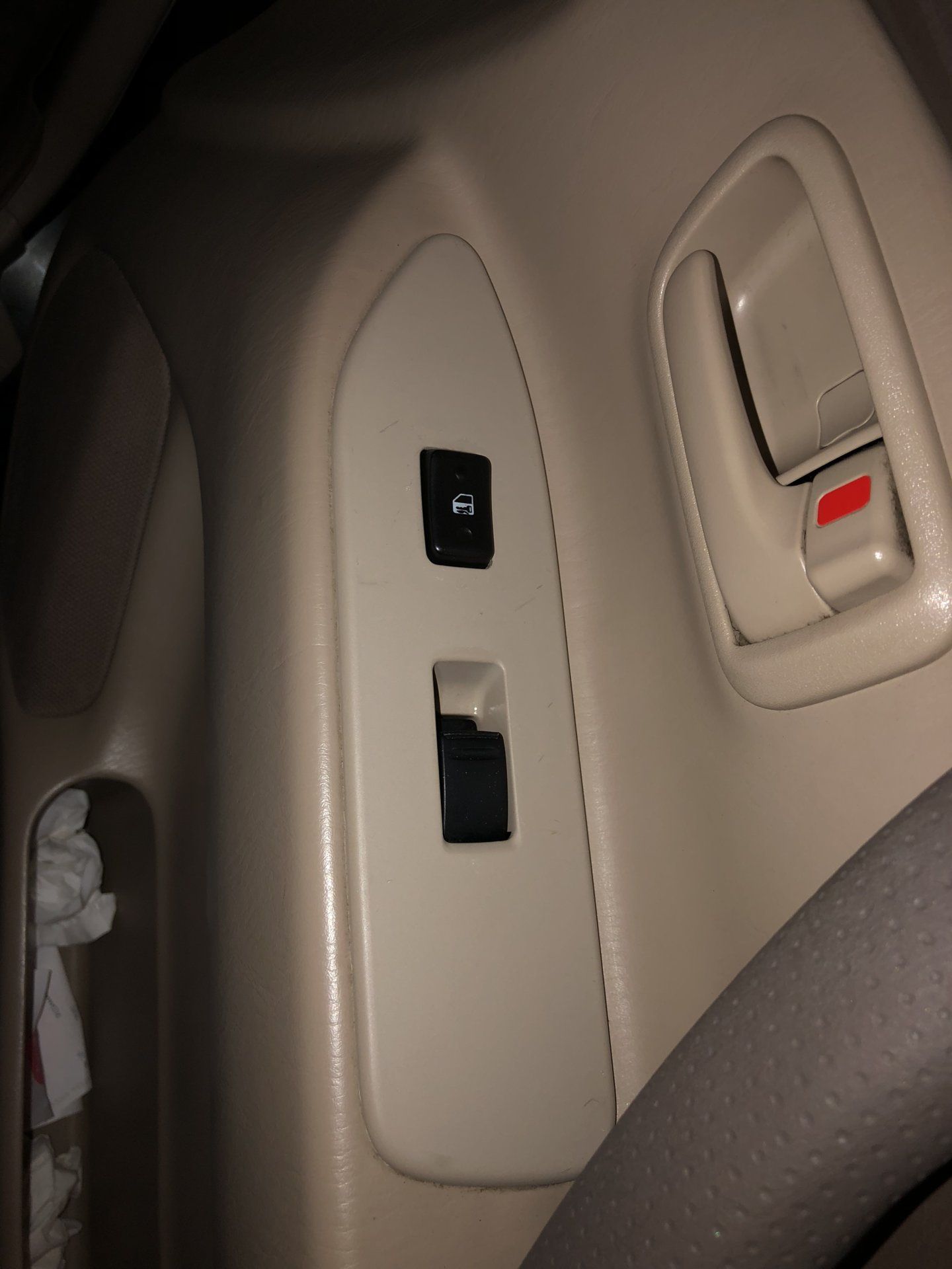

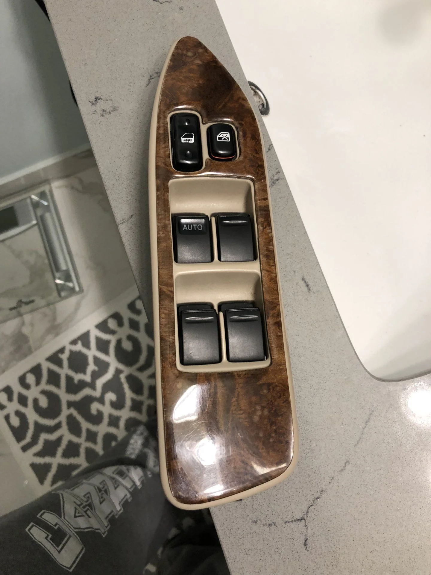

Hey everyone,

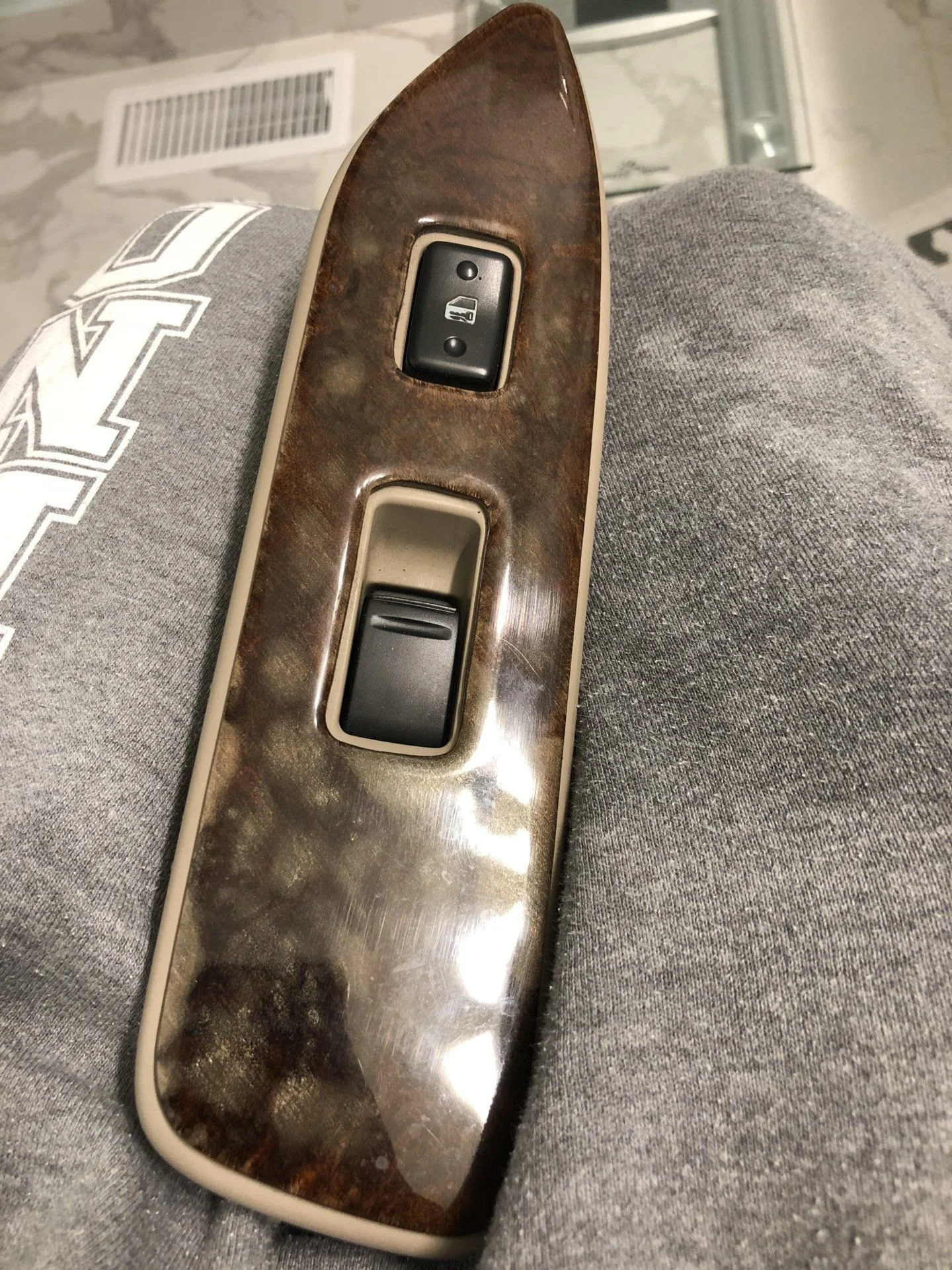

Today was the day I decided to remove the faded, sticker looking, wood grain trim from my window switches. I had heard of many people doing it, however, hadn’t seen any before and after pictures.

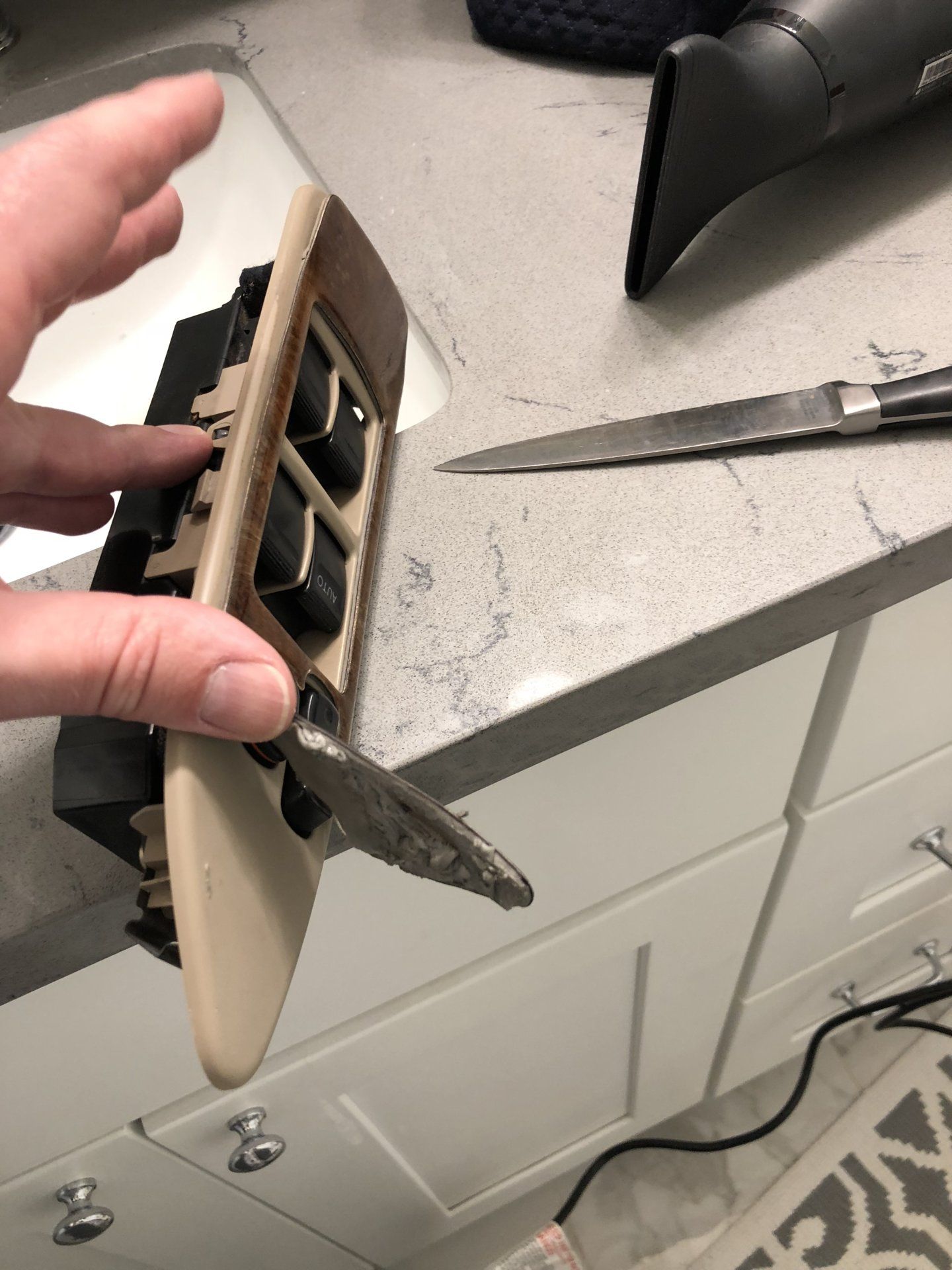

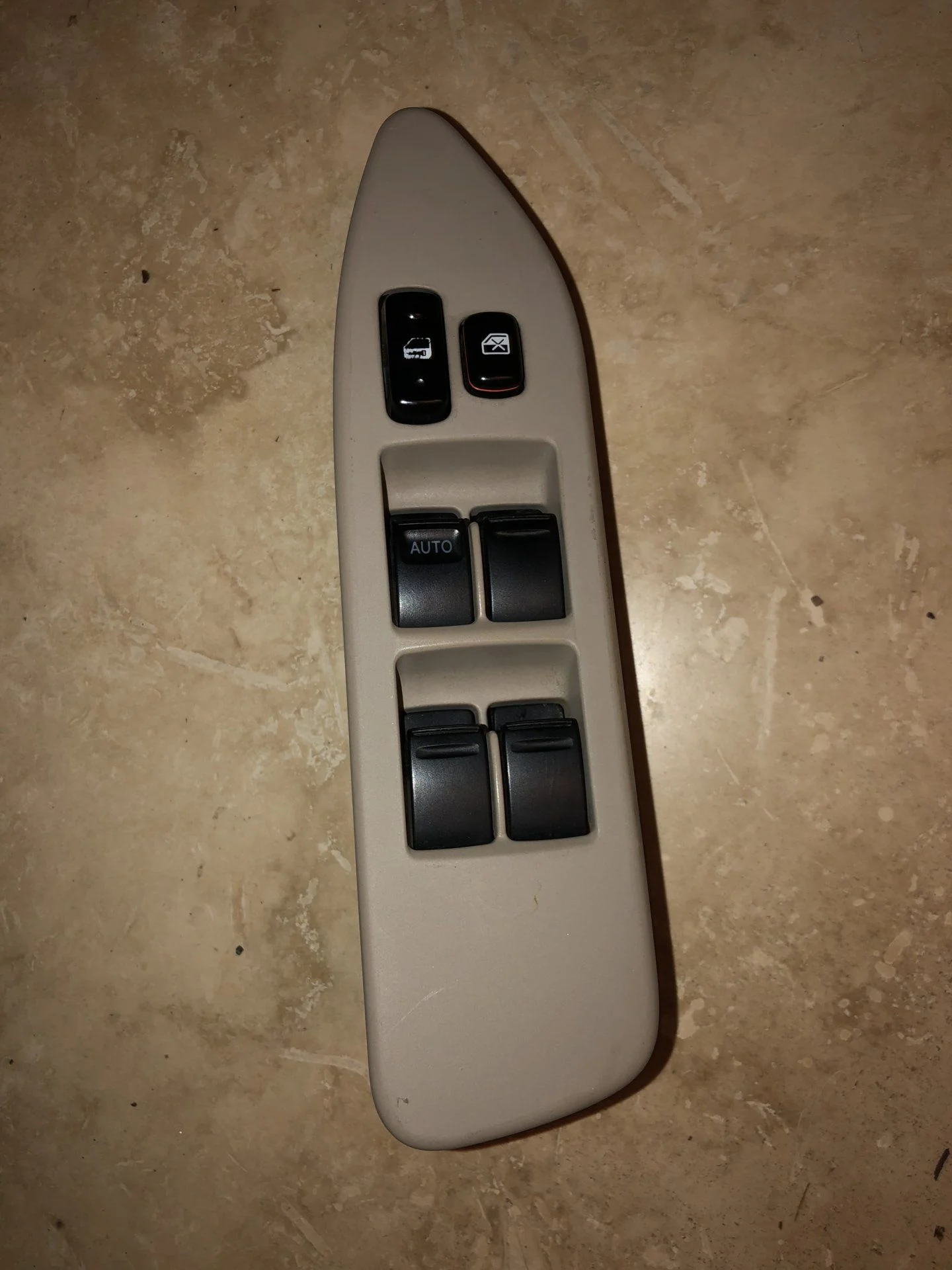

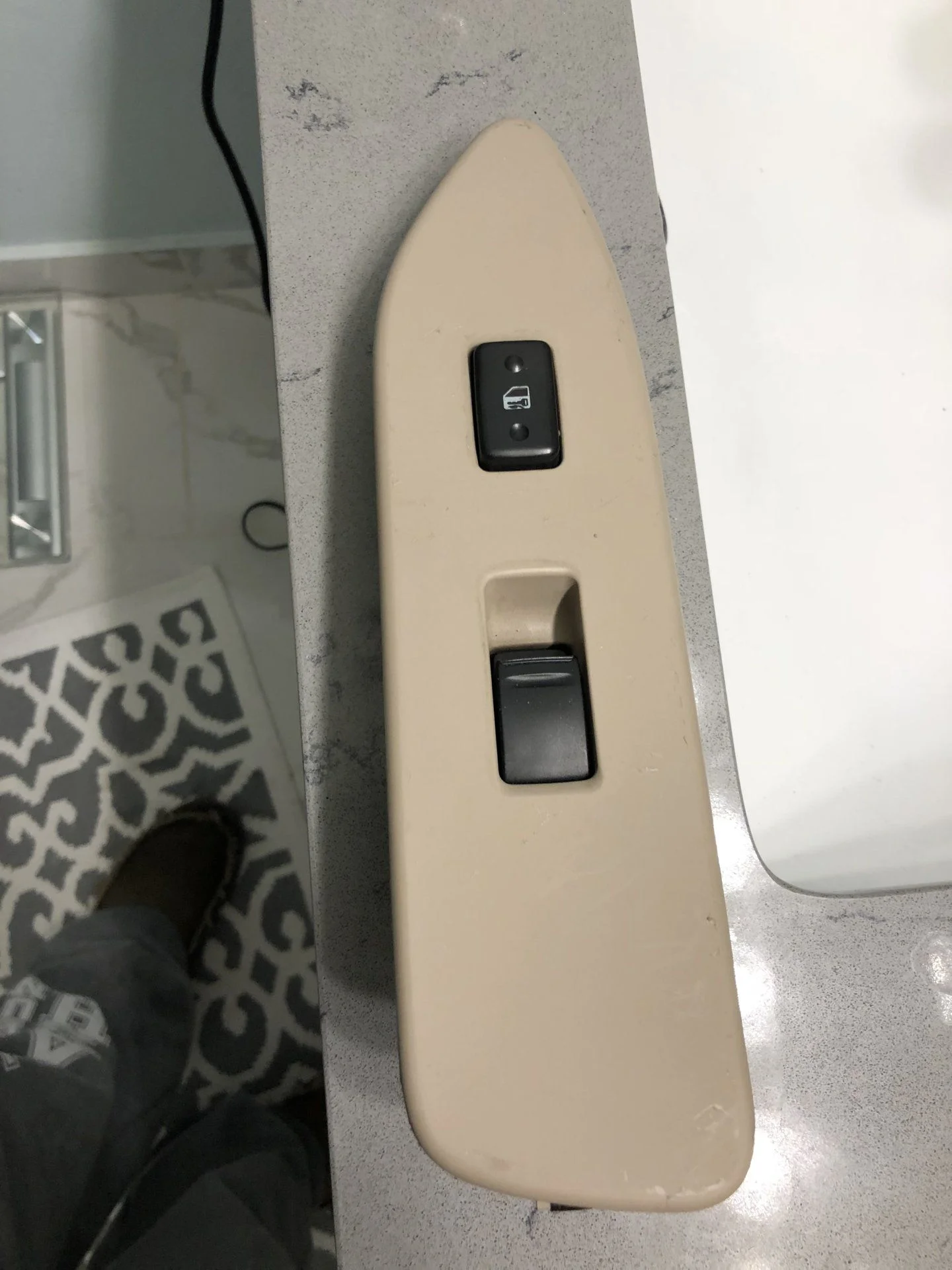

I used my wife’s hair dryer to warm up the adhesive. I initially started cutting the adhesive with some dental floss but found it wasn’t very effective. I quickly changed to a thin sharp knife to help with difficult to pull areas (be careful the trim piece can get scratched under the wood). After it was warm it was a breeze to pull off, just cleaned off with some goo gone and done! 30 minute job for both front doors.
