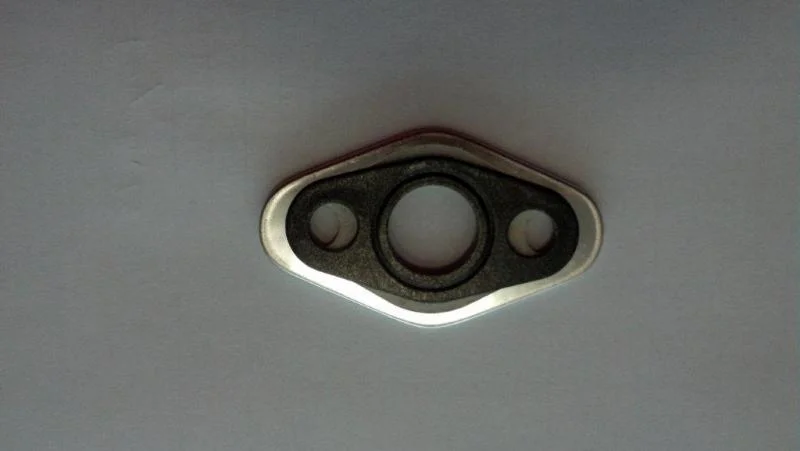

PN 25601 - you have to block that off somehow. I'm thinking maybe another O2 sensor block off plate? I haven't taken it off to measure yet, and was wondering what others have done. I also wanted to get up under there and see how hard it is to get to without taking the motor out so if I COULD add one of the block off plates there.

I had Sam @ Lowe get the EGR gasket for that pipe for me and compare it to the gasket for an O2 sensor.
Doesn't look like my idea is going to work for that, but I should still be able to take one of the O2 block off plates and redrill it a little. With this gasket I think it'll keep all the exhaust gases back behind the plate.
Or I could just make a new plate based on the gasket.
That's two gaskets. The black one is the EGR pipe gasket (PNC # 25628). Under that is an O2 sensor gasket. My idea was to take the O2 sensor block-off plate and use that on the EGR port on the exhaust manifold.
But it looks like either modify the O2 plate or make your own since the bolts won't line up right.
