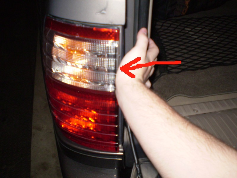

On the left you remove the screws and strike the side where you removed the screws with the base of your hand in a motion parallel to the tailgate and it will pop out. Same for right side just with left hand towards that side.

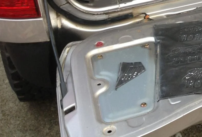

On a slightly similar note, how do you get at the taillight assembly that's in the tailgate?
100 Series rear light removal
100 Series Remove tailgate lights
Remove the cover using a flat head screw driver wrapped in tape
Then use a screw driver to remove the plate
Thanks guys
Taking your advice I got the tail light out easy but the trailer plug wiring doesn't go there. It was an after market towbar/ wiring install so I am not sure where it goes to?
